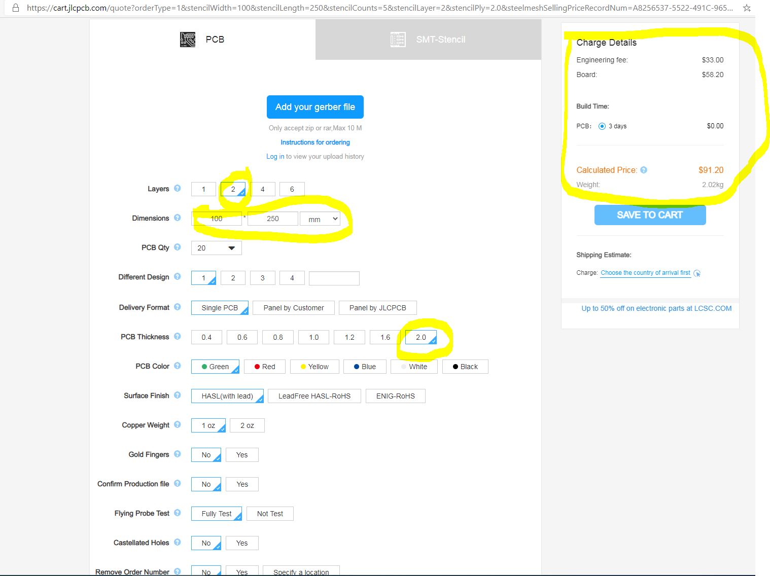

Inexpensive board
But..🙂 IF this manufacturer could be used, 20pcs of 100x250 mm double sided green 2mm boards will only cost $91.20 = $4.56 ea
PCB Prototype & PCB Fabrication Manufacturer - JLCPCB :
Designing a PCB seems to be very easy.
You need a 2 layers PCB 4oz/ft2 minimum copper thickness, 2.4mm minimum board thickness. This kind of PCB will be very expensive"

You forgot to set the copper thickness, and the maximum by this dealer is only 2oz/ft2 which is too thin. It must be 4oz/ft2 as a minimum. So you have to choose another dealer. The board dimensions depend on the cabinet, let's say a 400mm deep one, the board will be around 120x370mm (this board is not able to hold the output coil and its resistors and capacitors), a clever PCB designer would be able to accommodate about 8 x MJL3281A/MJL1302A final pairs.
As a mechanical solution, I chose a complicated one, not mandatory in case of wired assembly, but, in case of a PCB holding the final pairs, it would be mandatory and really expensive. See the picture: an aluminum board holds all final pairs, the aluminum board is placed on top of the heat sink; the heat sink is made out of two pieces: 119 total holes, 36 x 4mm blind threaded holes on the heat sink, 47 x 3mm threaded through holes and 36 x 4.5mm not threaded through holes on the aluminum board, to hold 47 x 3mm studs and 36 x 4mm studs. all studs must be fixed with a threadlock and all studs in through holes must be tensioned during the curing time of the threadlock. The drilling and threading job must be done by a digital control machine. This design does not take into account the space among the fins of the heat sink because the threaded holes on the heat sink (base is 7mm thick) are blind. Multiply all by 2 for the two channels.
Moreover, when designing a PCB with a thick copper layer, you have to set a suitable space among tracks, bigger than the one needed with a thin copper layer, and there are a lot of constraints over the electrical ones; a good designer must take into account them all, and the client must be able to explain the designer all mechanical constraints.

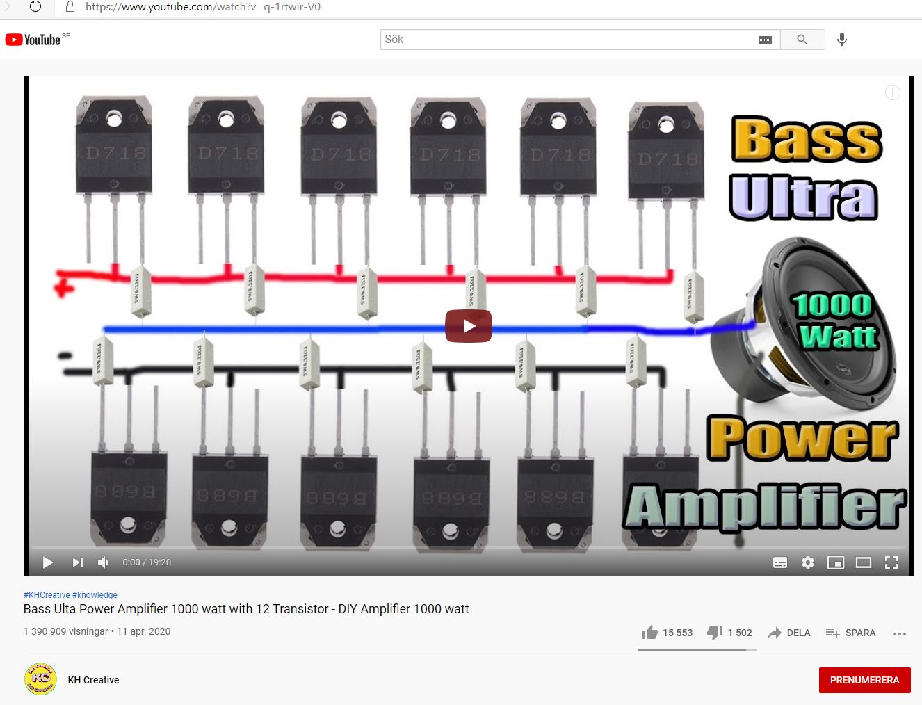

So if I used 8 x MJL3281A/MJL1302A as output pairs I could simply place them in two rows opposite each other on a heatsink with the resistors connected like a guy has done in this clip from YouTube?
Bass Ulta Power Amplifier 1000 watt with 12 Transistor - DIY Amplifier 1000 watt - YouTube
Let's disregard the cardboard 🙂 But the connections are just like in your more advanced design? :

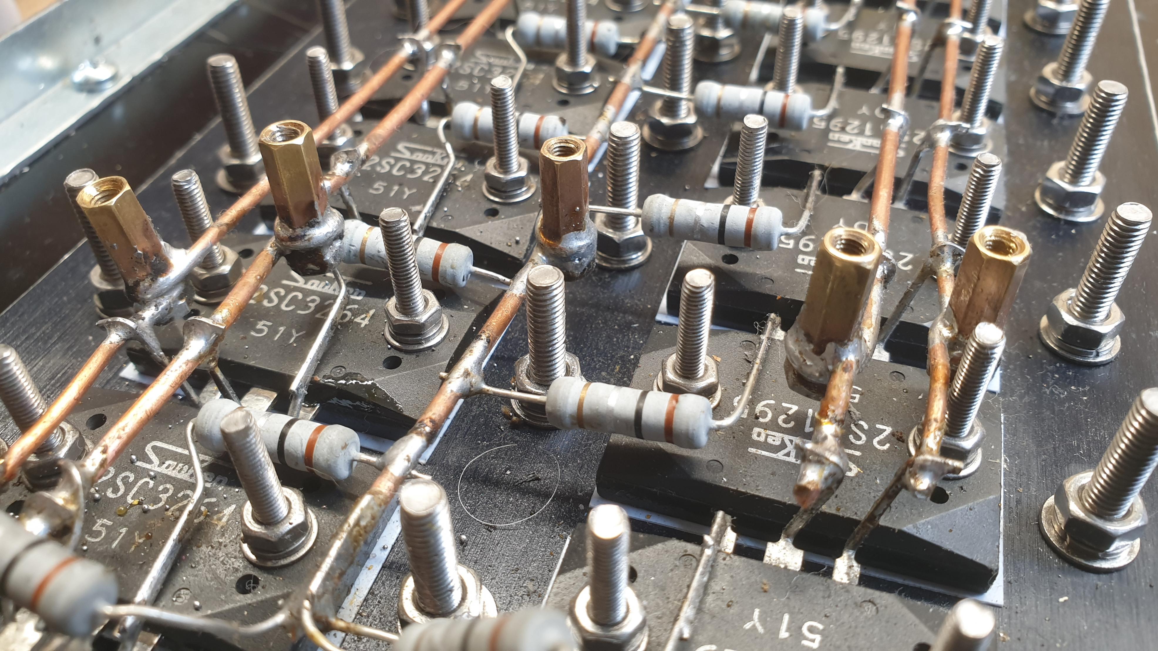

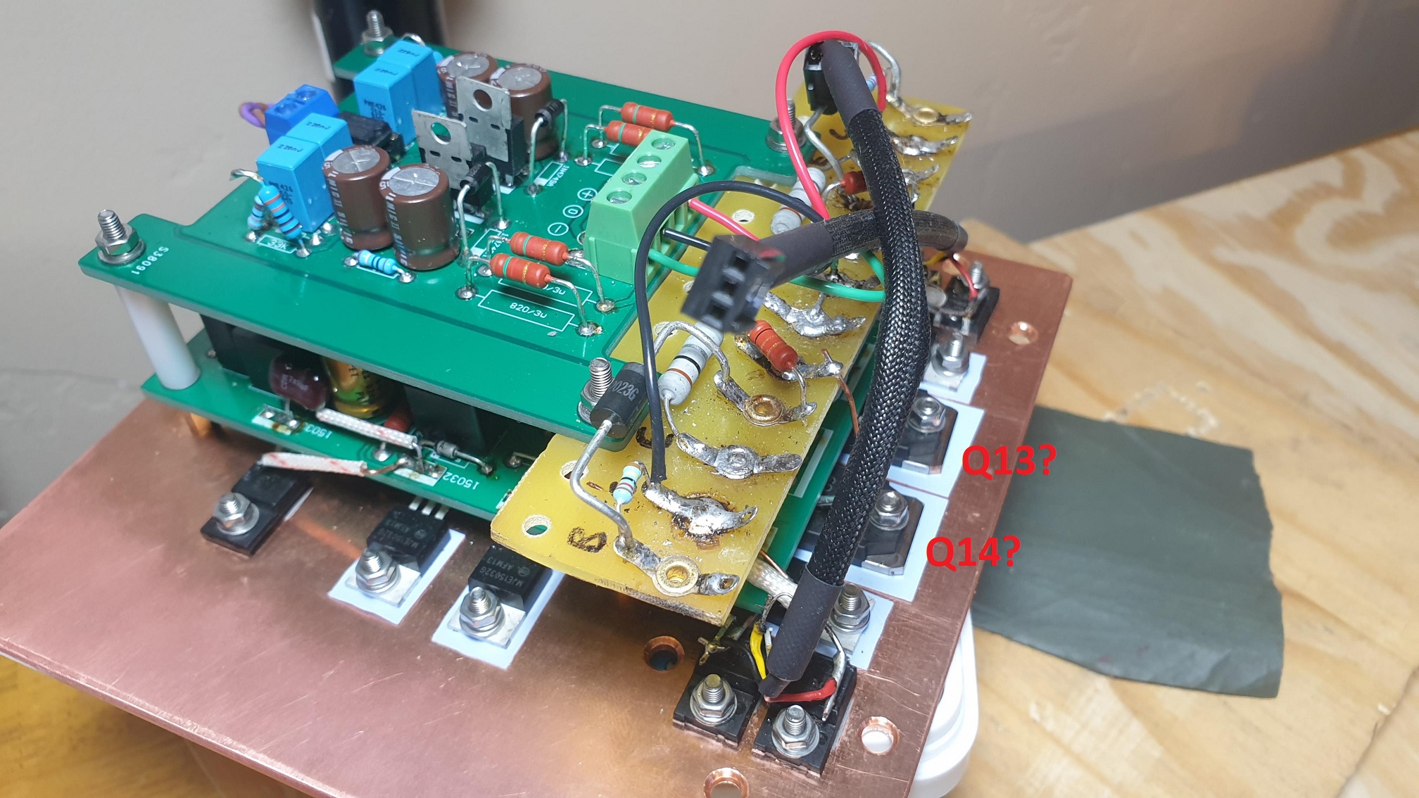

Q13 and Q14 placement?
Marigno, are the two transistors marked with red text the Q13 and Q14 from your schematic?
If so, along with two simple rows of TO264 transistors and with no need for a Servo (nor a Supercap?) your WHA-217 modifications all of a sudden feel much simpler to grasp and to build! 🙂

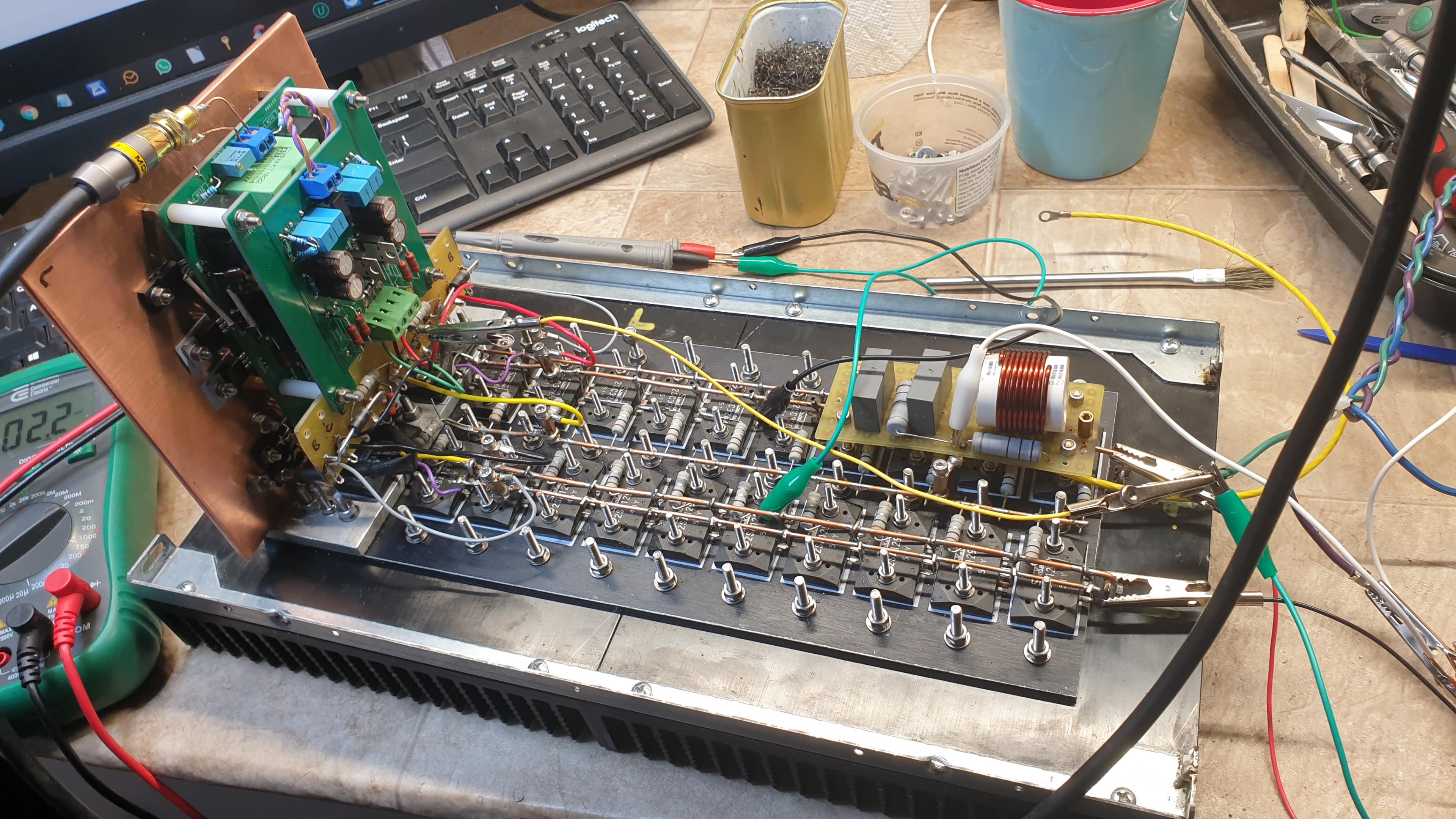

The solutions in the video clips are, more or less, what I did. But you need a thicker copper wiring, 12AWG for both emitter resistors and collectors, 14AWG for the bases without any resistor. The reason, over that an obvious lower resistance, is that you need a good mechanical strength when connecting the power wires to these bare copper wires. Zoom my last picture on the low right corner, where the alligator clips connects to the negative branch: you see a brass spacer nut soldered to the negative bare copper wire; now look to the pic I enclosed here and you will see 5 brass spacers nuts used to connect the wired assembly to the mainboard. Do not solder wires to the bare copper wires, you are an experimenter, who knows how many times you'll have to connect and disconnect the wires.
I told to try without a servo and see what is the offset and how much it is stable. The red new resistor 100KOhm connected after the input cap to GND defines the DC working point of the whole assembly to some voltage close to 0, mine is 1mV stable after 20 minutes open air. But, to decide, you have to try after 1 hour of high power listening, once the cabinet is closed. The DC protection, you must use one, should protect your speaker. Or use a dummy load. I don't have a dummy load and had no time to conduct this test, so I used the servo.
Yes, they are Q13 and Q14.

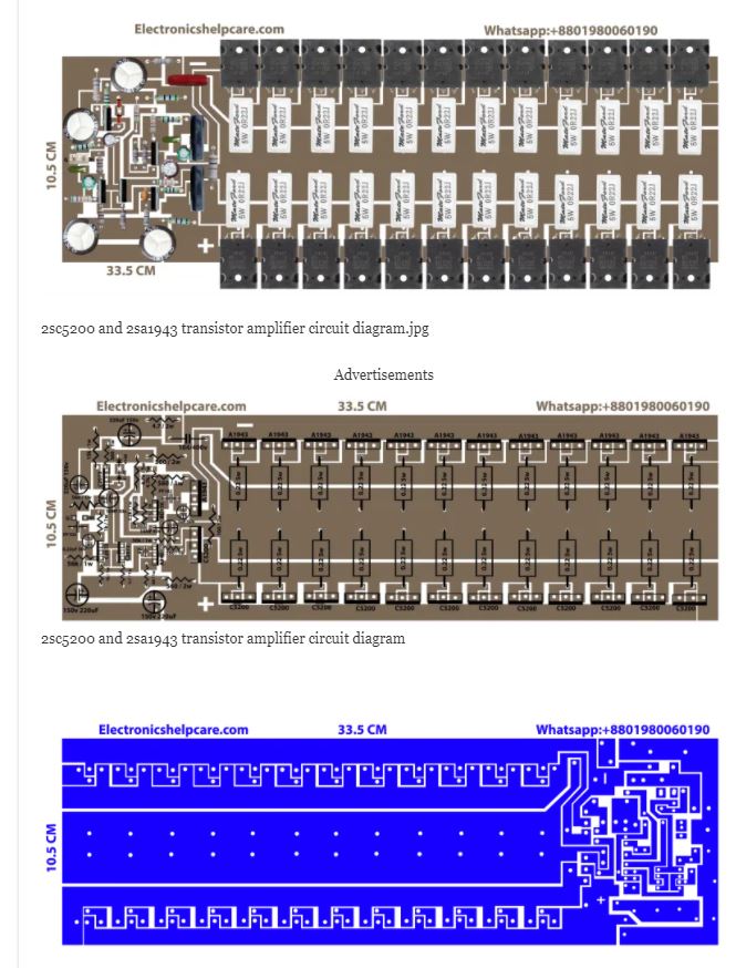

2oz/ft2 after all?
2sc5200 and 2sa1943 transistor amplifier circuit diagram - Electronics Help Care
Maybe even I, with Zero experience, could design the portion of a board that includes your RED modifications after the Q13 and Q14 transistors, including power transistors, temperature sensors, output coil, resistors and capacitors. I e most of your WHA-217 if it is combined it with a slightly modified Chinese NHB 108 board, as per your description. If 2oz/ft2 boards could be used the WHA-217 "Extension card" would not be expensive if ordered from the Chinese company I referred to in an earlier post. PCB Prototype & PCB Fabrication Manufacturer - JLCPCB
What IF 🙂 one used these very wide tracks, do you think 2oz/ft2 could work, after all?:You forgot to set the copper thickness, and the maximum by this dealer is only 2oz/ft2 which is too thin. It must be 4oz/ft2 as a minimum....

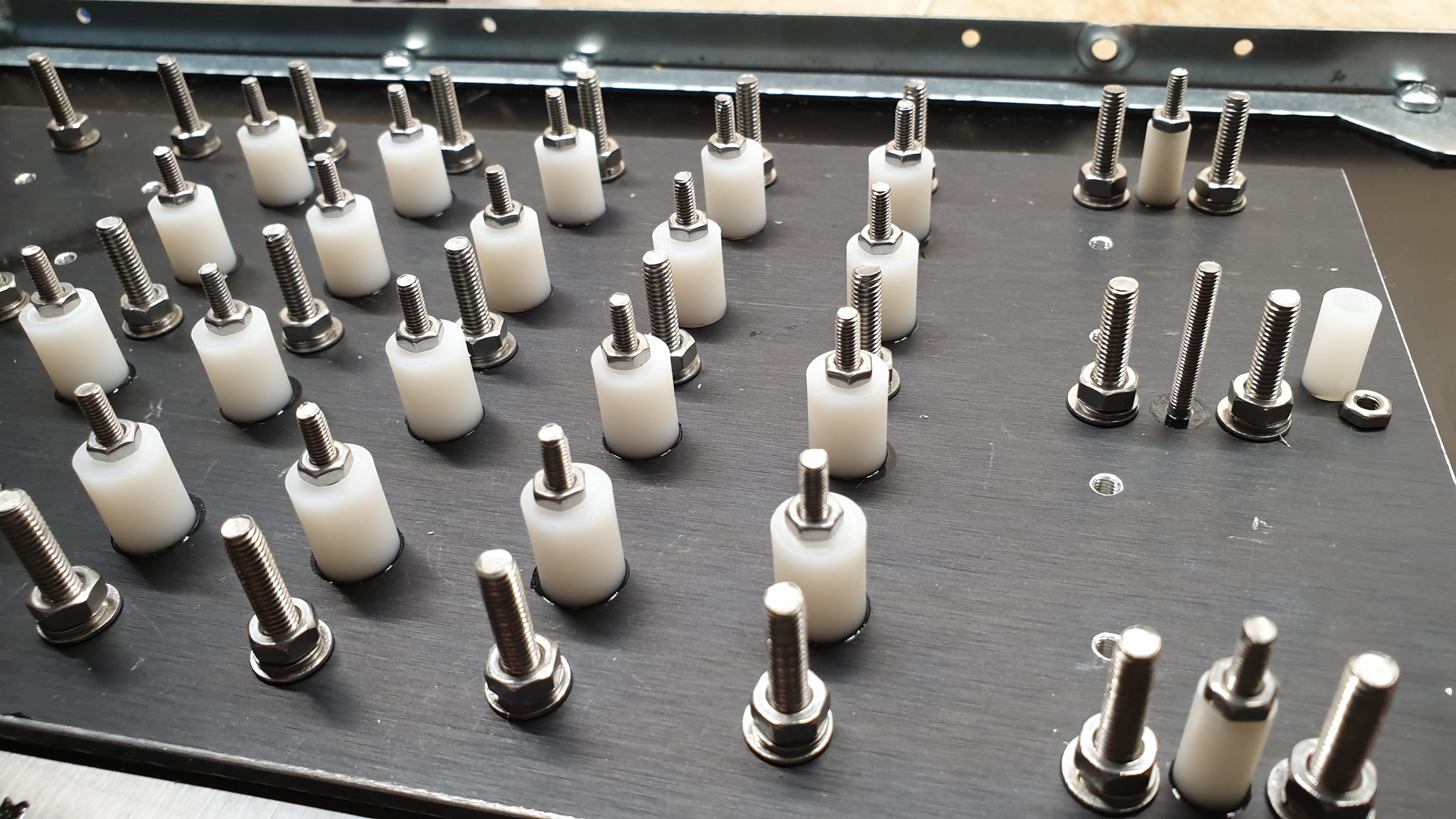

I am planning to attach all power transistors to aluminum bars or L-profiles that are screwed onto the heat sinks using only a few screws (and heat transfer paste). I do not want to drill too many holes in the actual heat sinks, should this project not work out well for me. If I decide use L-bars the mounting of power transistors would be similar to the ones in a couple of the movies.
The L angular is the only mechanical solution to connect the board to the heat sink. But this solution will take out a lot of room inside your cabinet. The common aluminum alloys you can find are 6061 and 6063, you have to chose the 6063, a good thermal conductor, and avoid the 6061, look at the chart here enclosed. When the angle is internally smoothed, usually (but not always) it is a 6063 alloy. Our interest is over the right upper angle but you can understand the trend.

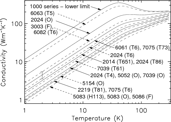

You say, in the name of the link, it is a 6082 alloy, but the link resolves to a 6060 alloy. They are different.
To answer your question google "aluminum 6060 thermal conductivity", varying the "6060" with other alloy codes: a result of 200 W/m K as a minimum starts to be good, while copper shows 385 W/m K.
I have both 6063 and 6061 5.08 sides x 6.3mm thickness angular bars and I could observe a very different thermal behavior among them.
I would choose at least 5mm thickness, the usual is 6.3mm.
