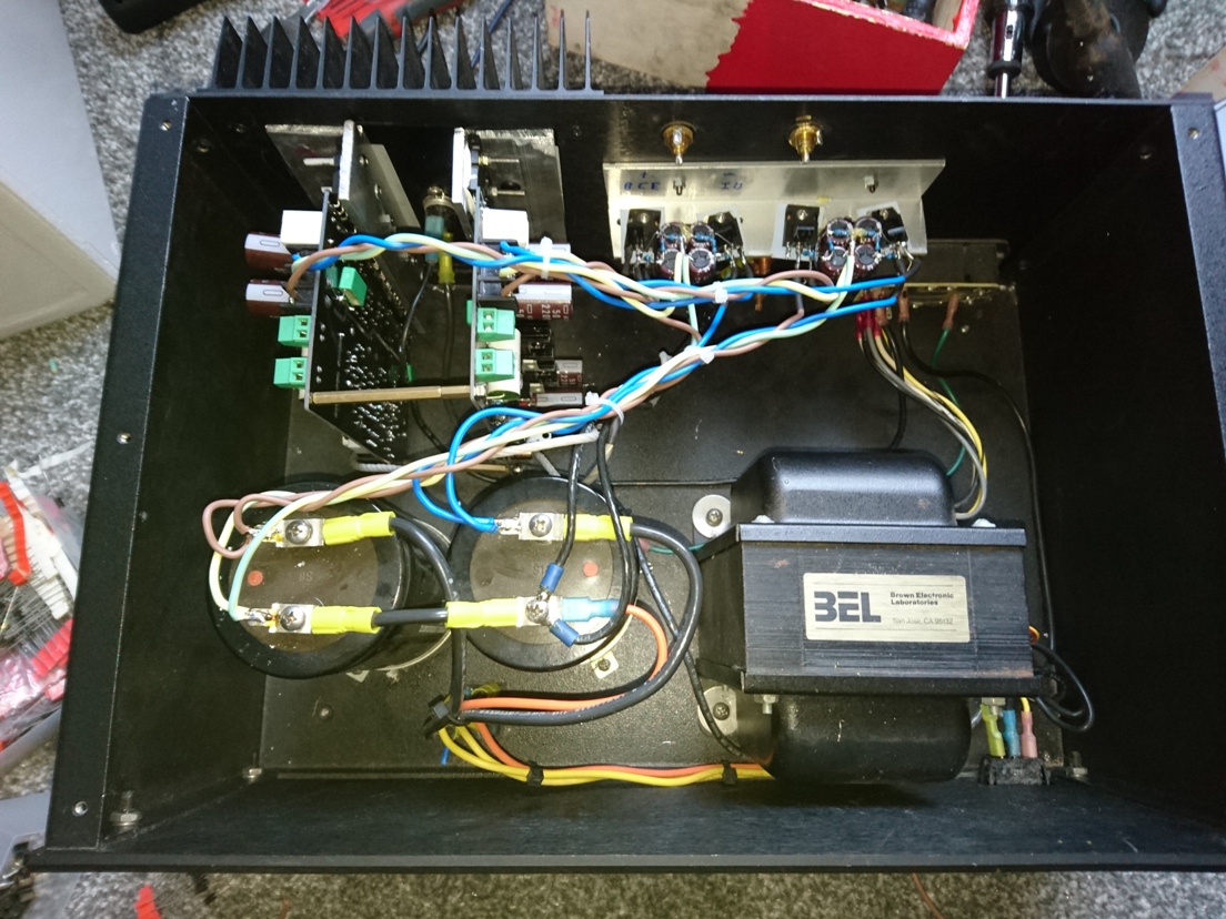

This is my build of the Dartzeel amp. The chassis, transformer and large caps are from a Bel 1001. I have added the ESP cap multiplers, one set for each channel to compensate for the low PSRR. It is under initial testing, it works and DC offset adjusts down to under 5mV no problem and seems quite stable. I haven't tried listening to it yet.
Voltages are circa 42.5V at the filter caps and 40V on the cap multiplier outputs, so I am not running mine at such higher rail voltages as the original design.

I am using a PETP input cap and replaced the low value capacitors with polystyrene. I replaced the 470uF 100V local power supply caps with 2200uF 50V. Despite the heatsink being smaller than the original Dartzeel mine only runs warm to the touch after about 30 mins. I am getting hum on the output of a few mV on both channels, I think is is coming from the transformer although I haven't put my scope on it yet, the transformer is audibly buzzing.
My cap multipliers are done P2P, they weren't hard, I glued the capacitors to the heatsink.
On 40V rails I measure around 4mV on each emittor resistor, so each output device is biased to around 18mV. The driver mje15034/5 transistors seem to produce more heat at idle.
