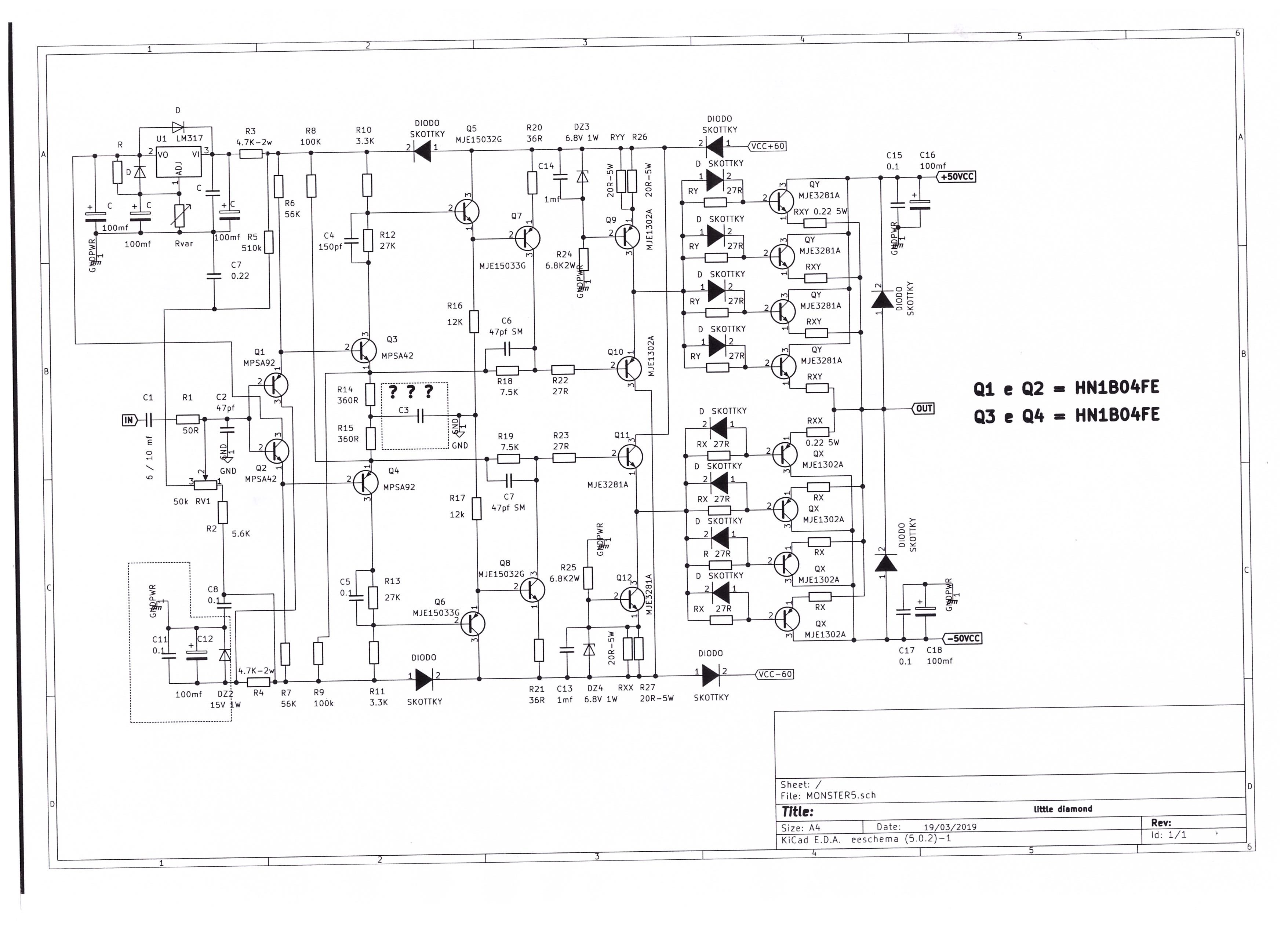

True, he can improve a lot with these interventions, but it's a complicated job:
the scheme can be worth the job

I have to design a new board anyway. Not a big deal. Did you match the outputs or just relied on the factory 10% matching?

we have kept the Chinese card
- removed Q 1, 2, 3, 4 and replaced with those chips
- changed all the drivers Q 9, 10, 11, 12 with identical BJT the end
- correctly polarize the 4 pairs
- emitter resistance for each final
- LM 317 and 337 for the 15 VCC of the entrance, much better than the absurd zener
- stabilized the VCC driver and second stage voltage, all at 60 VDC
- select the various final pairs, better to buy whole sticks
- important, I think, the various fast recovery diodes to separate the same supply line between driver, second stage and input, even if the input has a further stabilization
very interesting result, ALWAYS considering that you work with an - open loop - that most of the time fails to give for some performances
The rest is level
Not the original circuit as per 6moons (6moons interviewed the Dartzeel founder and patent holder)
all correct as you write, but then the DIY is no longer fun
consider that we ALWAYS start from a known scheme, it is not worthwhile to - invent - a scheme
I am also convinced that commercial electronics can be vastly improved
we are now making a revisitation of Goldmund, Norma and Spectral with these new (phenomenal!) dual chips, but, damn it, they are 2mm x 2mm, like size and, trying them flying, it's not easy
is the known scheme.
In the original 108 just it is difficult to understand those 2 gigantic transformers (what is the use, perhaps to give a low that the scheme will NEVER have?) And not even those 132,000 micro filter channel: perhaps to justify the price?

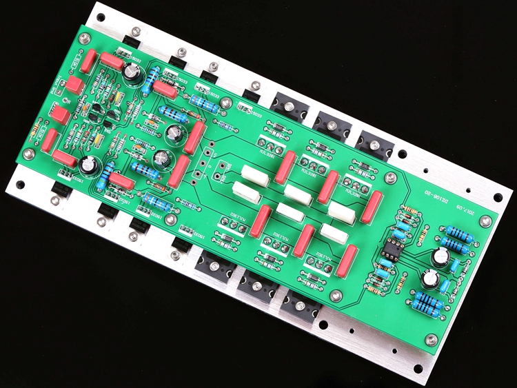

I use a 1500 Va 2 X 36 Vac and 6 X 68000 uf. Wich I already had. The amp is not stable. Emitter resistors are only 0.05 ohm.
Two transistor pair version. I will change to 0.22 ohm. I hope that will fix it. From Queenway store. The seller will contact the producer about the emitter resistor problem.

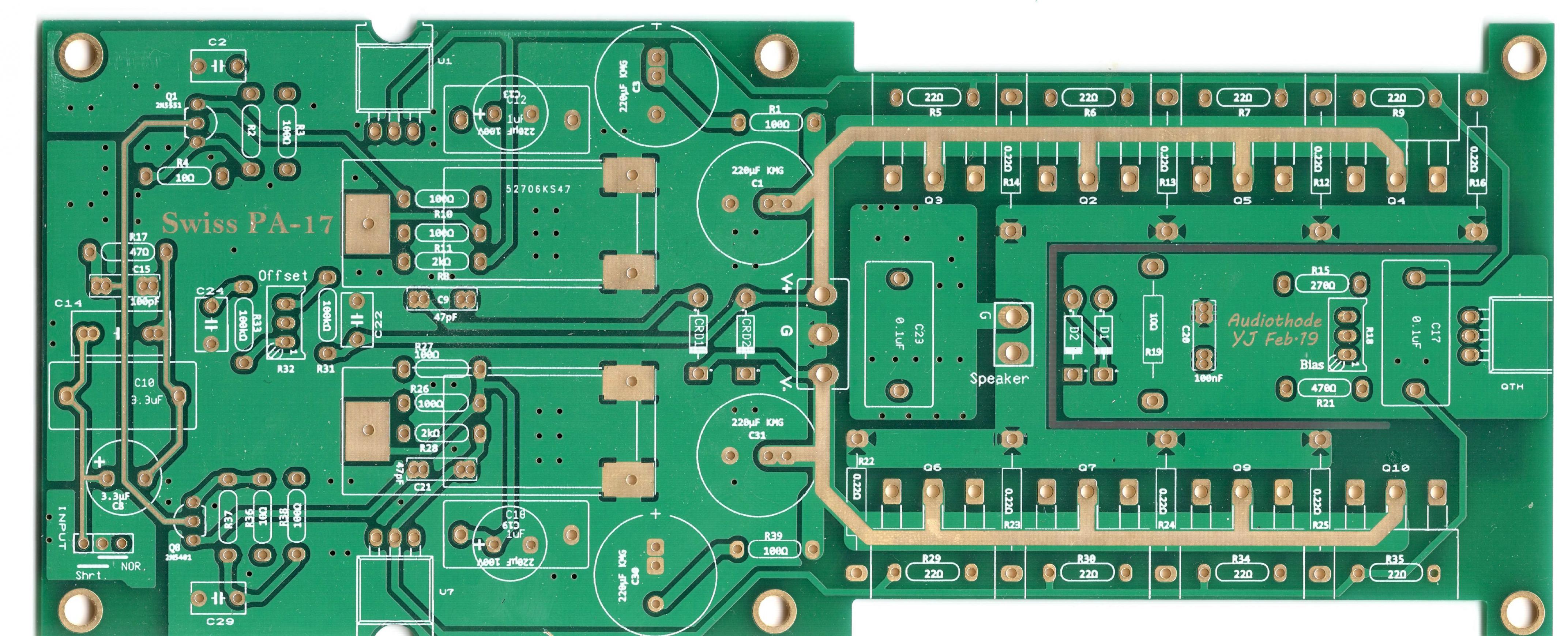

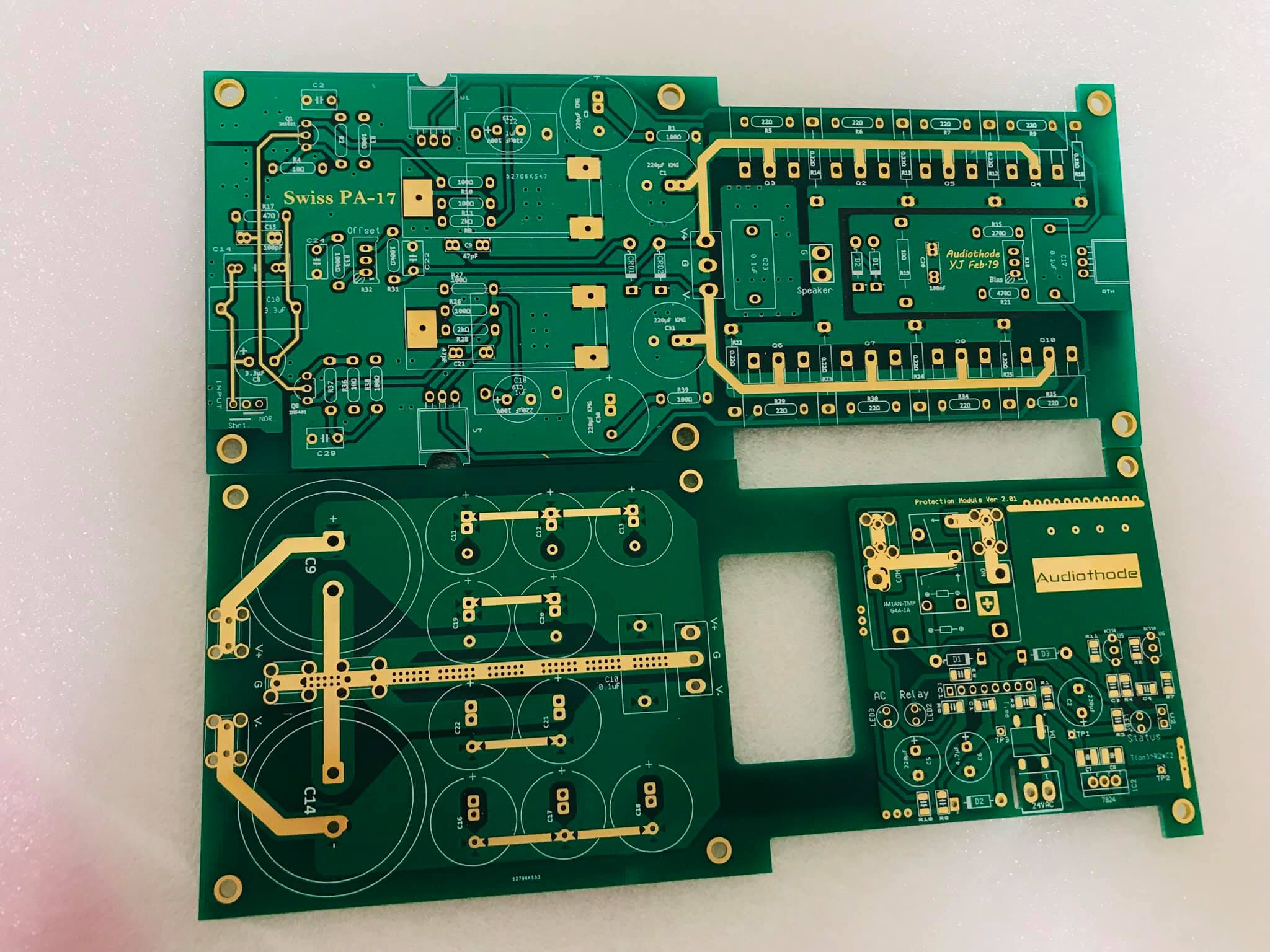

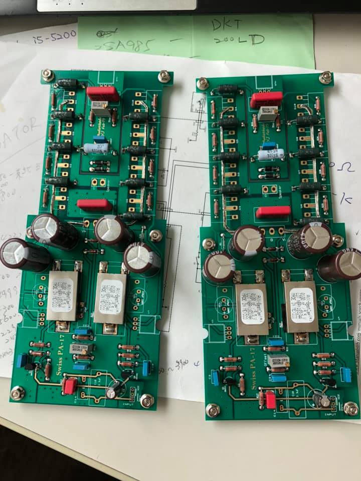

Here I am having lots of fun with my friends. I shared PCBs that I designed with them, fairly good DartZeel design.
Just finished the soldering work, and preparing to make them sing!
