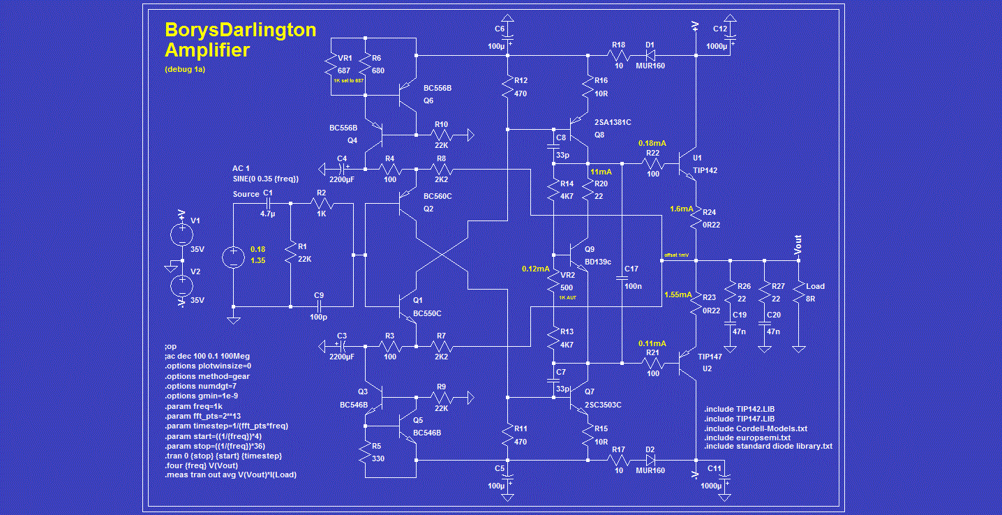

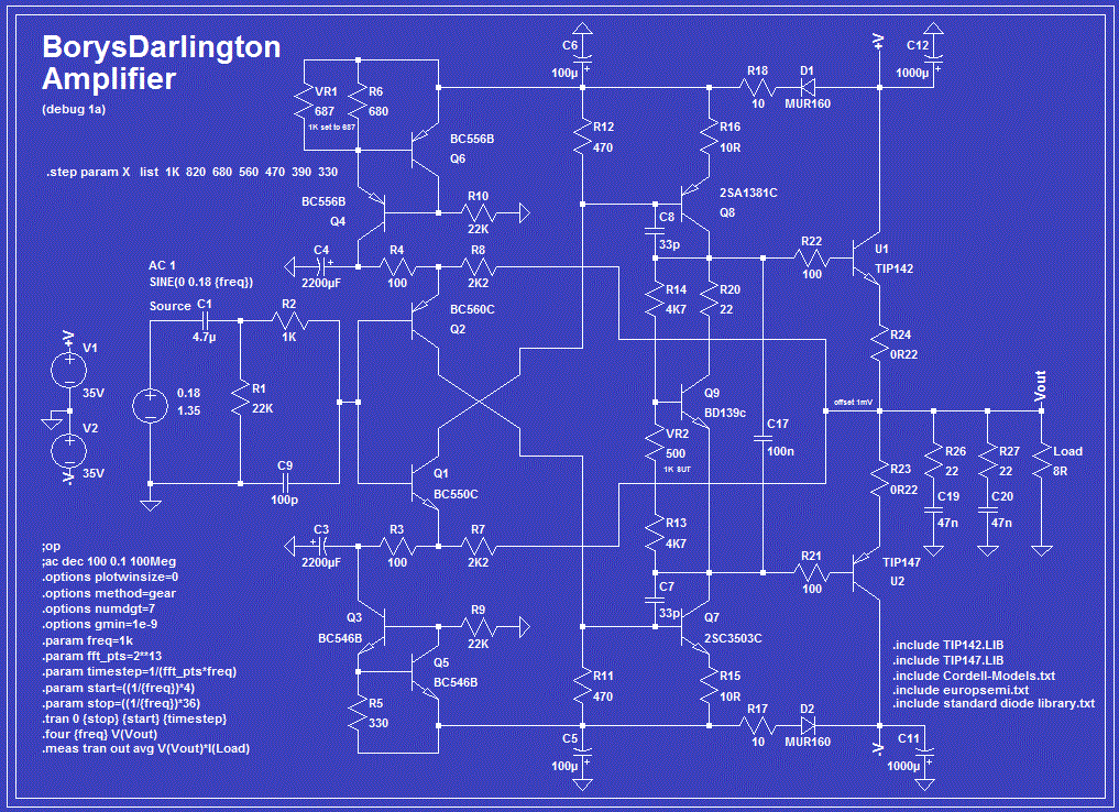

Hi
Here the LTSice translation of circuit in post #55
It does not work at all. Until now I can not found where the error is.
Maybe some experienced eagle eye can point if I miss/screw something?
I suspect the CCS's. (or maybe some stupid miswiring, dot or comma out of place?)

C9(100nF) is to large , 100pF will be just OK ,
C17(100nF) is to small , 100uF will be OK ,
C5 & C6 need larger values , 1000uF or some larger values is OK .
why two Zobel network ? , one Z- network consisting of 100nF+10 ohm is just enough .
Edit , upper and lower CCS circuits have different connection !
Regards !

Banat, component figures are exactly as Borys design. CCS wrongly connected is my fault. Thanks to point at the err.
Wrong connection between emmiter of Q1 and collector of Q5 deleted.
The circuit still does not work

Check & compare again component values from Borys original schematic on post#55.

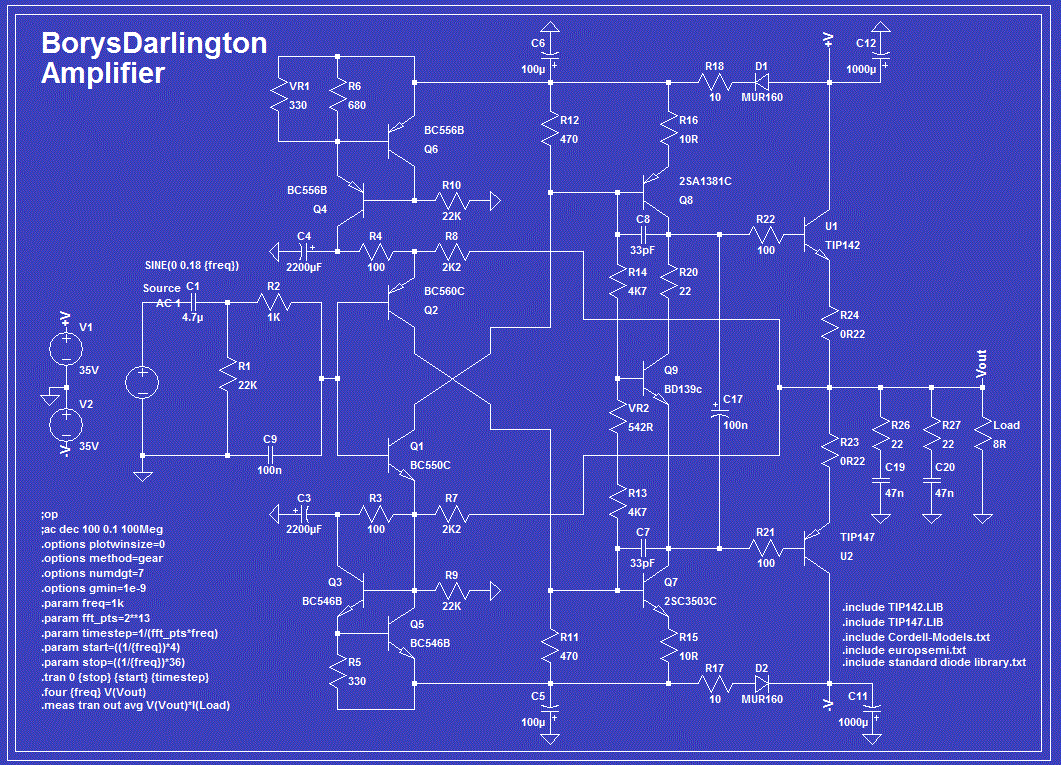

now we are talking!
bad connection between Q1/Q5, corrected
misplaced C7/C8, corrected
VR1 adjusted (offset 1mv)
still to do: VR2 bias adjust not enough to solve issue of THD being bigger at 1W than at 60W .

What is actual simulated IQ value trough TIP141/142 pair ?
Obviously OPS -IQ is way to low ,~1,6mA only , causing high Xover distortion , you have to play with R13 & R14 values ratio to get much higher optimum IQ .

in doing spice simulations you can easily be fooled by missing or overlooking some little big detail, when in the test bench, instead, you can't miss or ignore the smoke signals 😀
That's right, setting IQ to 35mA the problem is solved.

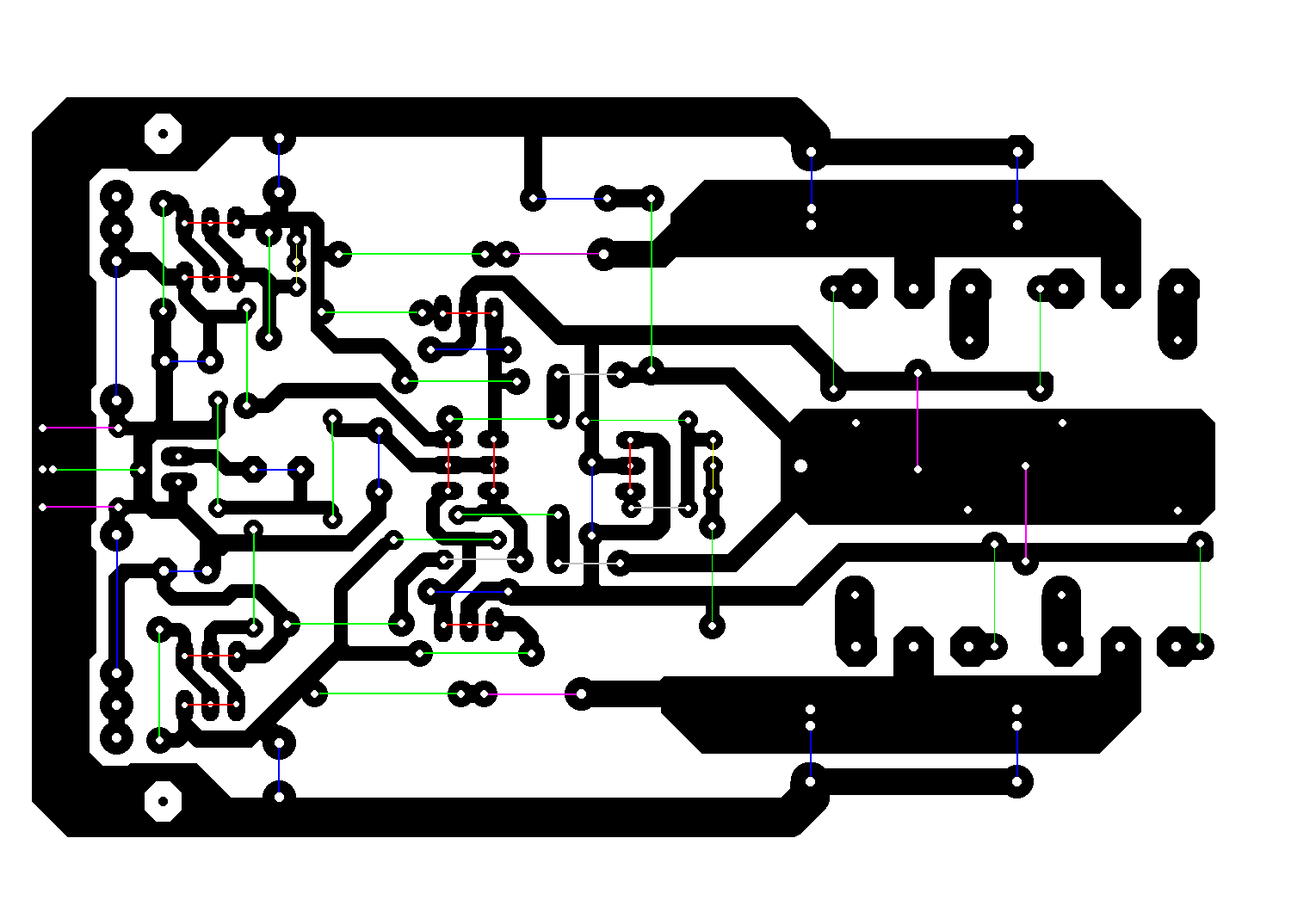

Hi
The post 76 layout can be used with darlington or Toshiba power device and has CCS..
