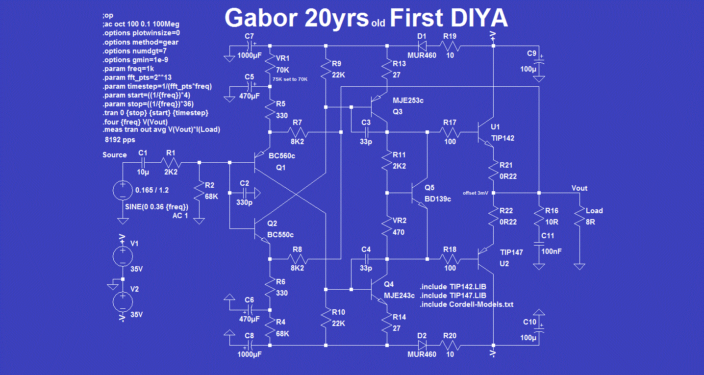

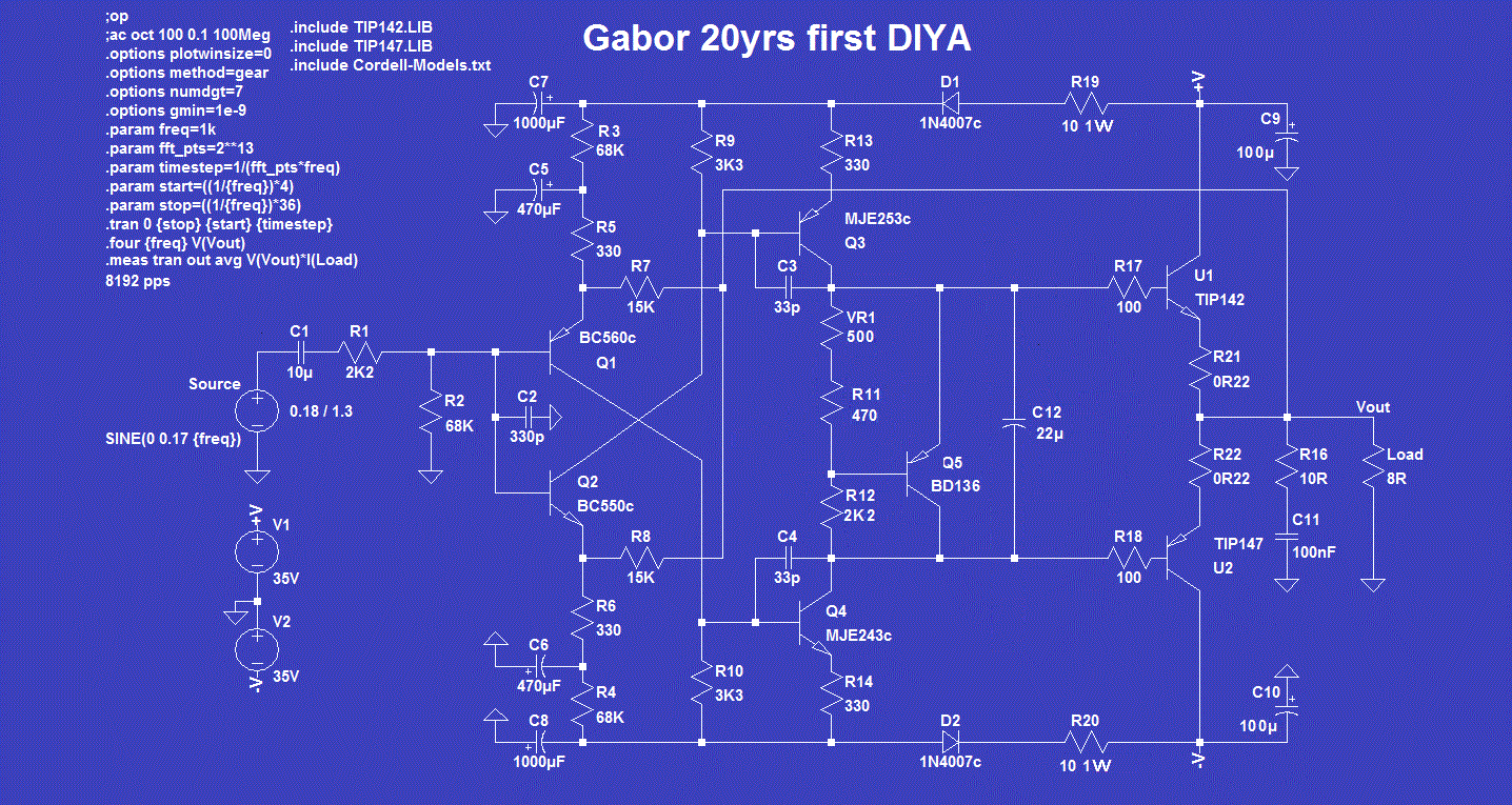

Ok, before I drop any comments on the results of the simulation, I want to know if the circuit as I drawn it is exactly as your real life board. If not, please point me what to mod. (using the part number id)
I dont see any 22uF electrolytic in this circuit
Hi
Here is the corrected version
One of the 68K I replaced with 75K multi turn trimmer to get rid of the offset that can be higher value to, whatever you find 100K. If you leave the 68K resistor the BC550C - 560C has to be chosen (matched) accordingly to get the offset close to 0.10mV or so.
I mention that if someone draw a layout to know that is a trimmer.
For simulation you can use 68K.
Greetings gabor

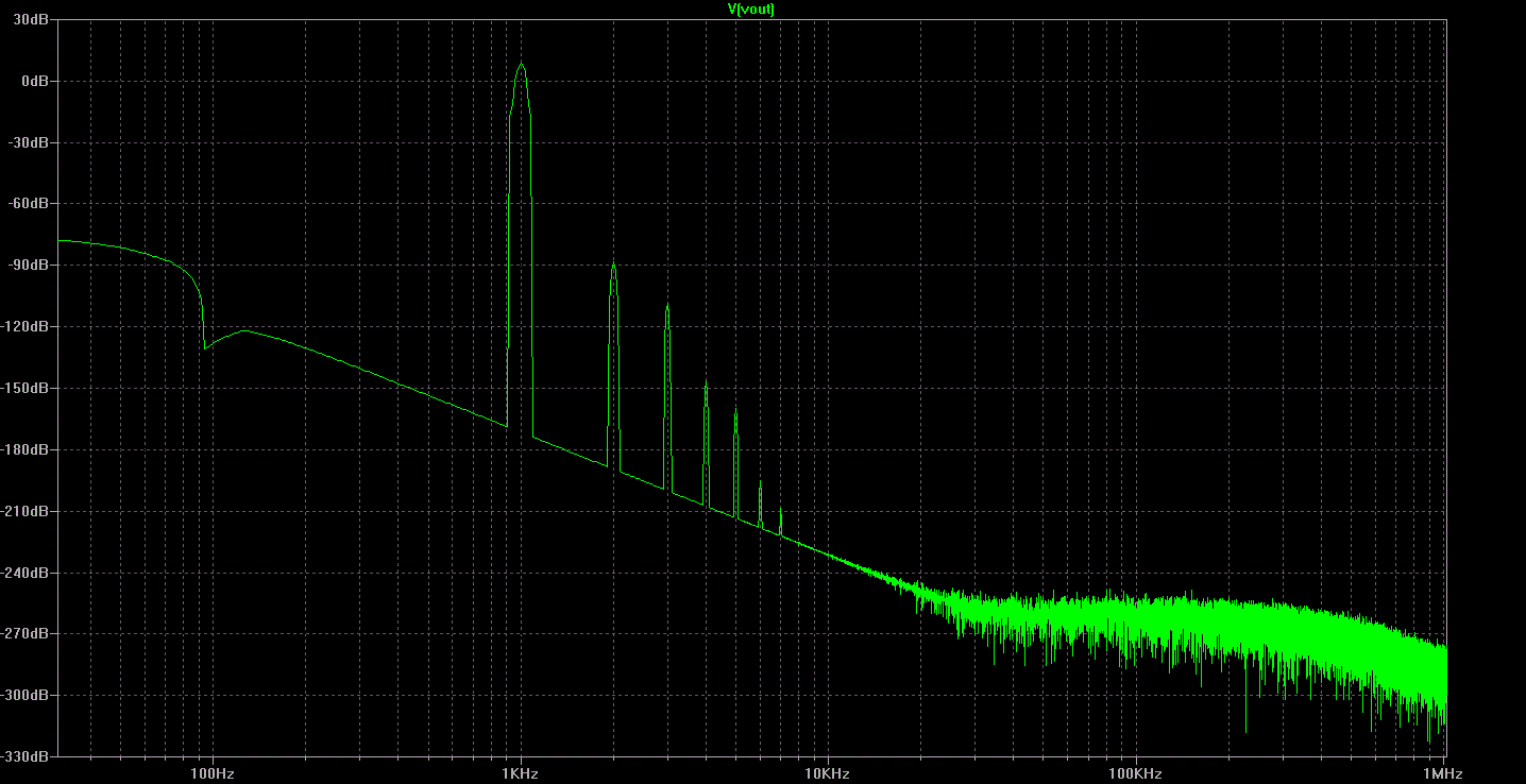

comments
if R11 is 1K, it's impossible to get rid of crossover distortion
gain is excessive, NFB lacking, or both
fft looks like a Rio Carnival parade of harmonics
distortion at 1W out is higher than at 57 watts, +/- 30V swing, (onset of clipping)
why R17-R18 are so big? It's neccesary?

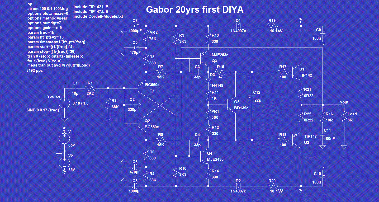

Hi
That is bad news.
These is circuit was modified based on Bigun advise and it look like it is wrong..
I post now the one I built and sound excellent but has some thermal drift issues. That was the main reason we modified the VBE and it look like need more work.
Here I post the original circuit , I built it and several other people built it also other. Including some guys from these forum.
If you would like to run a simulation from the original circuit, I will lok it up now

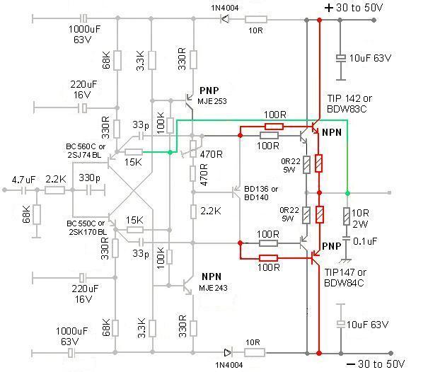

Hi
The previous circuit was built several time and always worked properly.
Now someone who has a lot of experience made a small tweak ( which it make sense to me base on similar circuits)
He get rid of the two 100R resistor and the 2Pc 33p got connected to the VAS.
I did not tested yet these one but I'm sure these is correct!
Why we tied to modified a great sounding amplifier🙂
How I mentioned it had some thermal drift issue.
Greetings gabor

Hi Gabor
To open .asc files You need to download and install LTSpice.
Bigun is a very experienced guy, most probably we were not reproducing correctly the mods suggested by him. (something got lost in translation?)
Me myself not an expert in Spice simulation, I'm barely exploring the basics.
Before we continue, we must avoid any confusion, otherwise we are going nowhere. From now on, please refer to the component denomination we are talking about
(R1, C7, Q3, and so on).
The circuit in post #46 is very confusing, it's the same of post #47?
Lastly, if you got an amp actually constructed, that works fine and sound very good, why bother with simulations? rather get it competently measured in the lab bench, and try mods/fine tuning right there.

Hi
Yes Bigun is a very experienced guy, I agree with that. But I have to let you know after I made the suggested mode he did check out the circuit and approved it all do he wrote it may need further adjustment the components values.
The #46 is the original circuit exactly how it was built by me and several other people to, some of them use that amplifier over 10 years period.
If you leave out the red (double power transistors, that need when the PS voltage over 35V or so)
#47 post get a minimalistic modification from a very well experienced guy and totally agree with that.
I will ad component denomination to each components so we avoid the confusion.

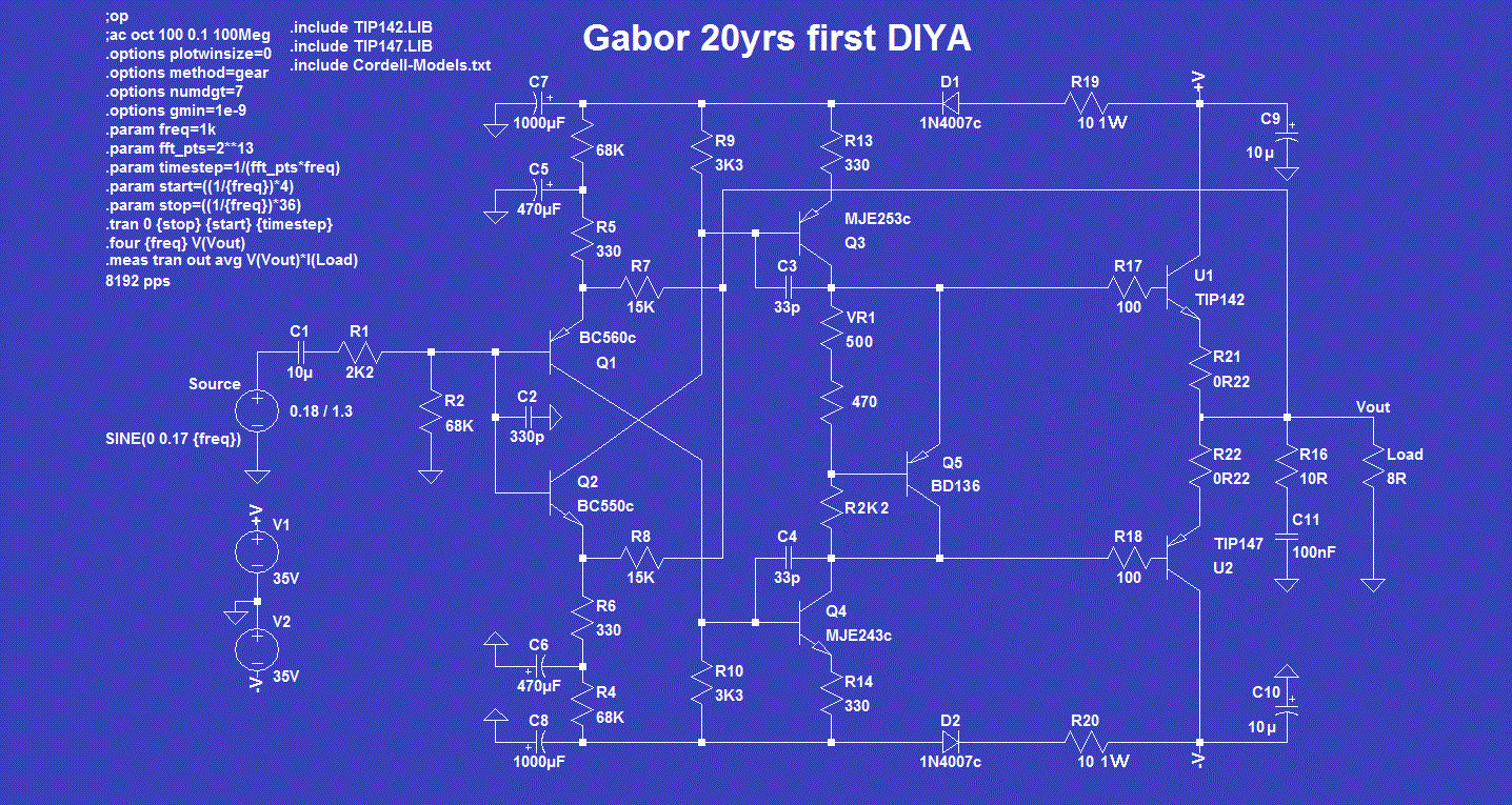

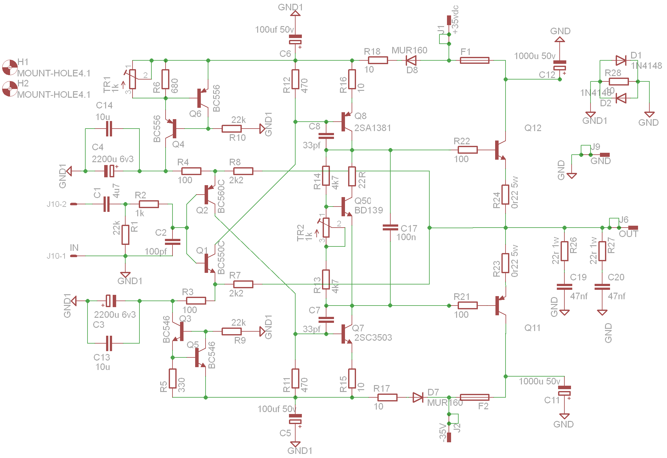

Hi
Here is the circuit very identical ( little tweak made by wahab) to the original how was built with one pair power darlingtons.
These should work as good as the original and you can read it better..
All parts has component denomination! C12 is optional only, it is a electrolytic capacitor.
If you could run a basic simulation on these we could compare it with yours.

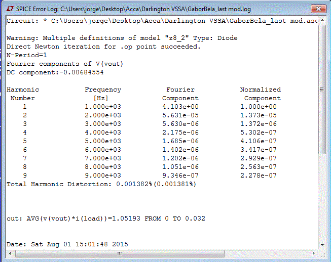

Consider this:
without modifying the topology, just radically changing some components figures, you can achieve:
Circuit of post # 52 perform much better than the one in post # 23 . At least in the simulator. Someone more skilled than me can maybe check if in ( post # 52 ) we are not violating the power rating of any of the devices.
Ok, that's it
Thank you Mosquito
I just open up the last schematic you posted and I see you made some mode to.
I do like that! I will have to build these to test it in real life
Any comment or opinion on the simulation result especially compared to the circuit you posted previously

Forget to ask
At the latest circuit you posted R9 & R10 22K value not to high
All other things being equal, performing a .step analisys 22K comes out better than either 18K or 27K.- In the simulation -. This at 1W, 5W and 50W out.
The test bench could tell a different story, or not. "When in doubt, just measure"
Cheers
J.

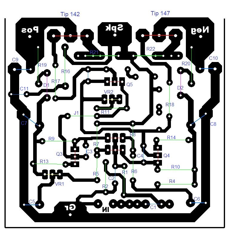

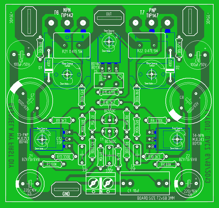

Here we go if someone want to test it..
The VBE transistor goes on the top of the power darlington transistor connected with wires.
J1 is a jumper, these layout was designed for my previous circuit
I think these layout good enough for testing
Please be aware it was not tested yet so look for errors if it has any.🙂

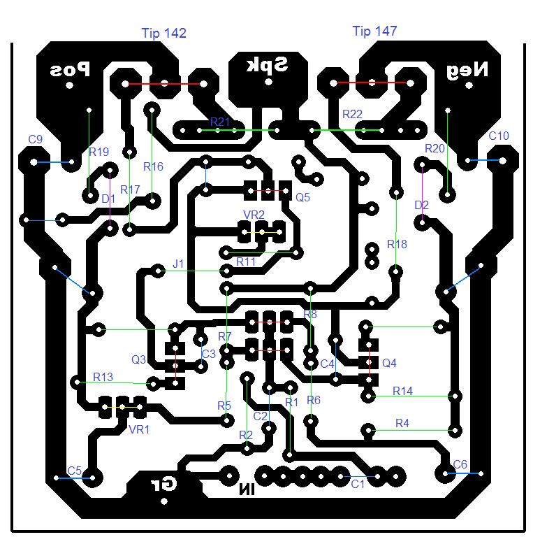

Hi
To help you with the layout you mount the PC boards on the heatsink flat.
Similar like these
I draw all my layout by hand with the help of the pain program.
I made some correction and I added some part number what I forget at first time.
The layout look like is good.
The green layout only for help, so you can imagine how you mount the PC boards, otherwise it has nothing to do with these circuit.
