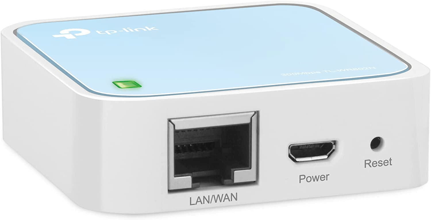

would something like this help? you plug it into the hardwire ethernet port on your laptop/minipc etc, and it handles the wifi. so your laptop/minipc sees a hardwire ethernet connection, not wifi. works great for me in other applications. never tried it with daphile
https://www.amazon.com/gp/product/B00TQEX8BO/ref=ppx_yo_dt_b_search_asin_title?ie=UTF8&th=1
No, there's no other port 🙂 There's a couple USBs, and I'd need a USB=>RJ45 converter.
Since I also need the USB connectors for storage and the DAC (not to mention the Daphile stick, because I plan to run it off the stick), I'm a bit stuck. I'll need a hub, and that slows things way down.

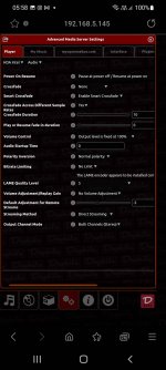

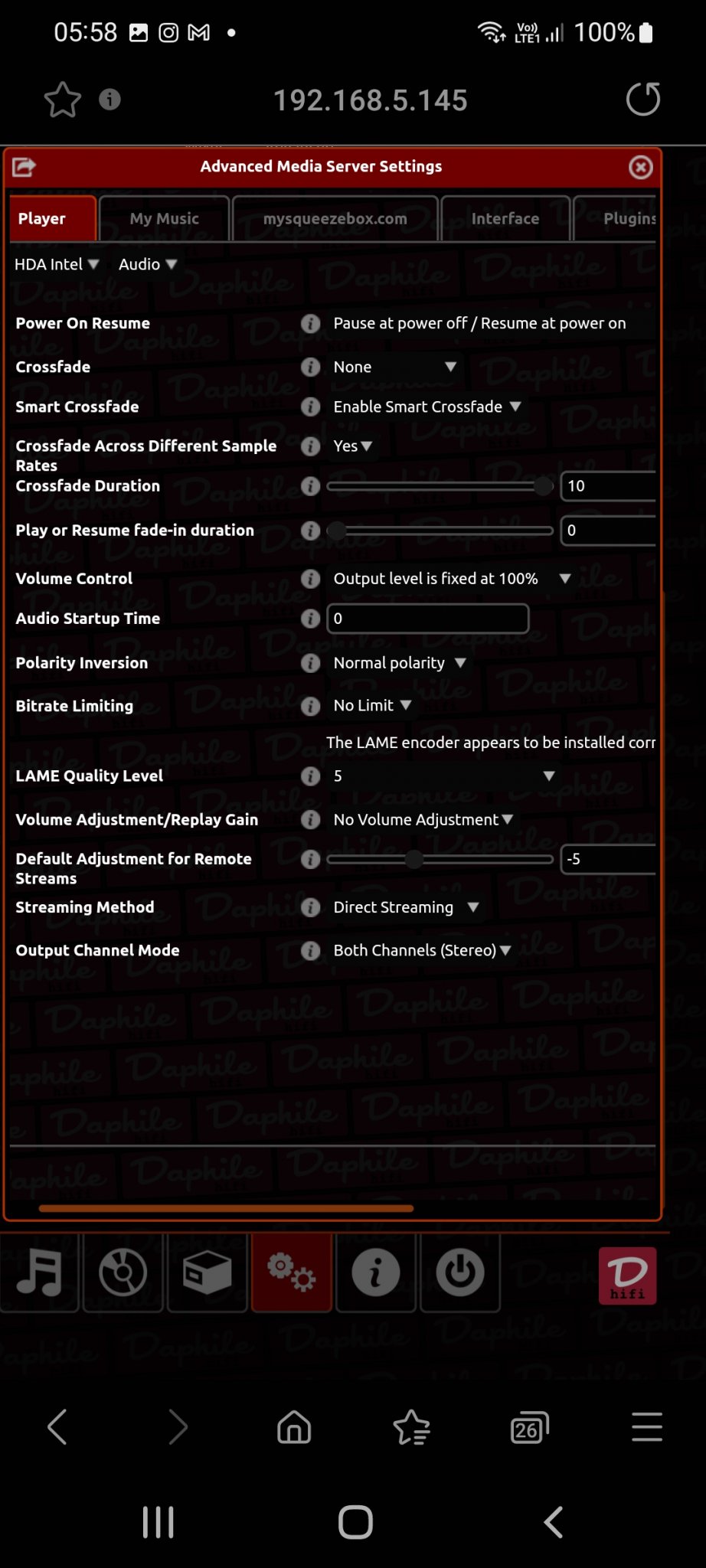

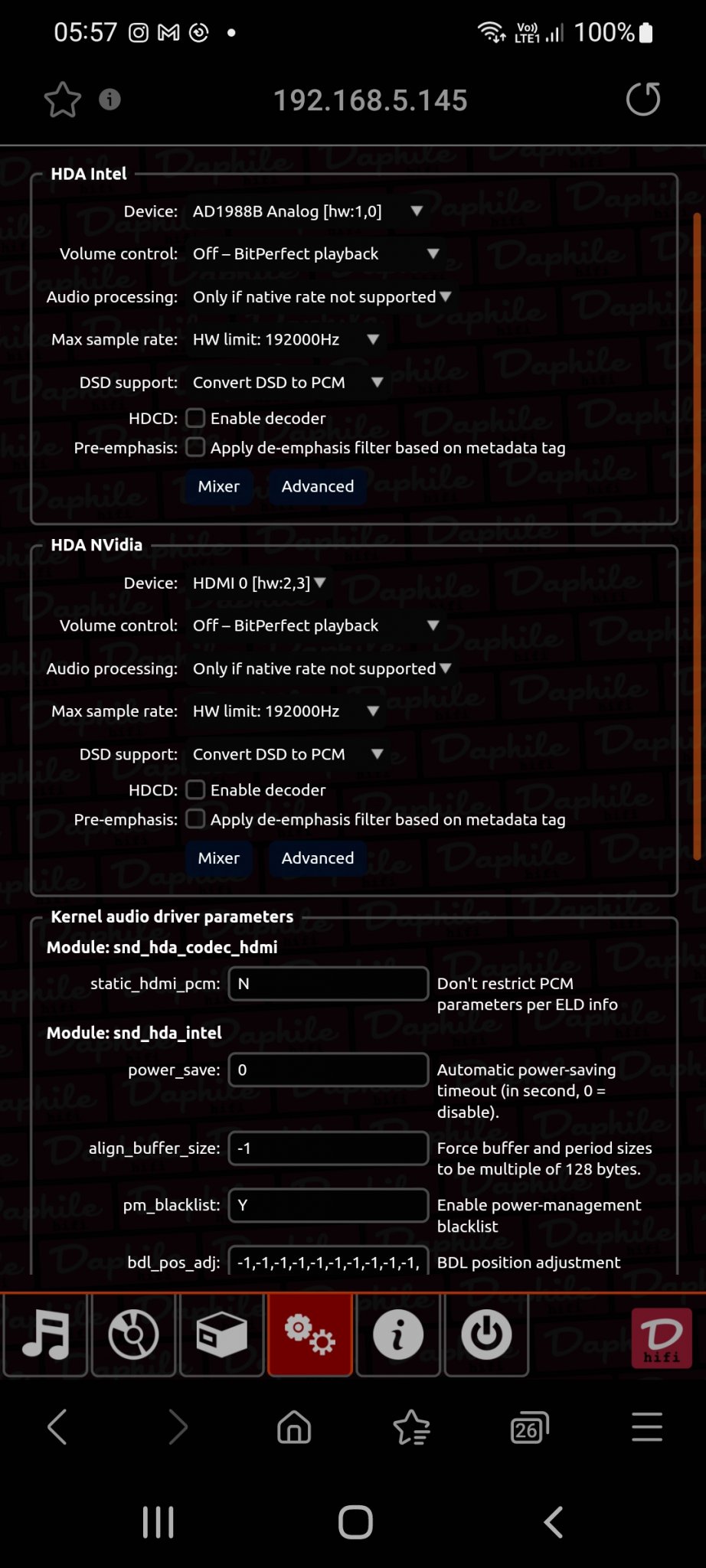

I have been using daphile for a few days now and I like it, goes nice with squeezer android app.
I have a problem tho...
Analog output works, but SPDIF coaxial doesn't, I can hear slight hiss when I connect the cable (that hiss is not audible with analog) and speakers pop when I reboot the computer.
I can see red light in tascam port, but I don't have cable to test that.
Soundcard is onboard on Asus P5K motherboard and it uses AD1988B.
I had tryed to set AD1988B to hw:1,1 but it didn't work, even analog was not working.
SPDIF is checked in mixer, there is no releated settings in BIOS...
That board has input auto detection, but I'm not sure if this applies to digital or obly analog.
Any suggestions?
Other thing is cpu... I have core2quad 2.6ghz, what is the lowest frequency I can use without sacrificing performance? I would like to downclock it. Also ram, I have 2GB ddr2 right now, would playback sound better if I upgrade?
AD1988B hw 1,0 is analog, hw 1,1 is digital.... if i set to 1,0 i get sound from analog and silent hiss from digital, if i set to hw 1,1 i get slight hiss from analog but not on digital... if I move volume pot on my amp -brand new Yamaha A-S501 I get poping noise from speakers as long as ai'm moving the pot, but only while daphile is booted.
I dont know much about thse technical settings, but could it be your DAC? what version (prod or beta) of daphile are you using? some of those settings options don't look familiar to me.
Nevermind... I'm getting either cd player with usb or network player with usb from same series as my amplifier is ... I'm leaning towards network player as this is the future... I was using version 21.01... but I'm done with it, it doesn't even want to connect to network anymore after factory reset. I was planing to get nuc for it, but I will rather add another 200eur for player and call it done.
