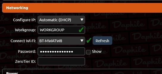

I have installed Daphile on an old NUC, which was a simple enough install but if I disconnect the ethernet cable Daphile just sits at the 'Waitng for Network Connection...' screen (I currently have a scren connected to the NUC). In Daphile I can see my home WiFi network and have set the correct password - see attached image below - I have no idea what 'ZeroTier ID' is?
One other thing, if I try to restart or shutdown Daphile it never completes but hangs at about 80% of the descending progress bar.

Might this be why I cannot get a wireless connection working with a TP-Link TL-WN823N USB dongle?
Possible.

I have the same nautibuoy problem here.
While connected via ethernet cable I can see my home WiFi networks (the wi-fi card is obviously working for that) but if I disconnect the ethernet cable Daphile just sits at the 'Waitng for Network Connection...' screen. No wi-fi connection.
