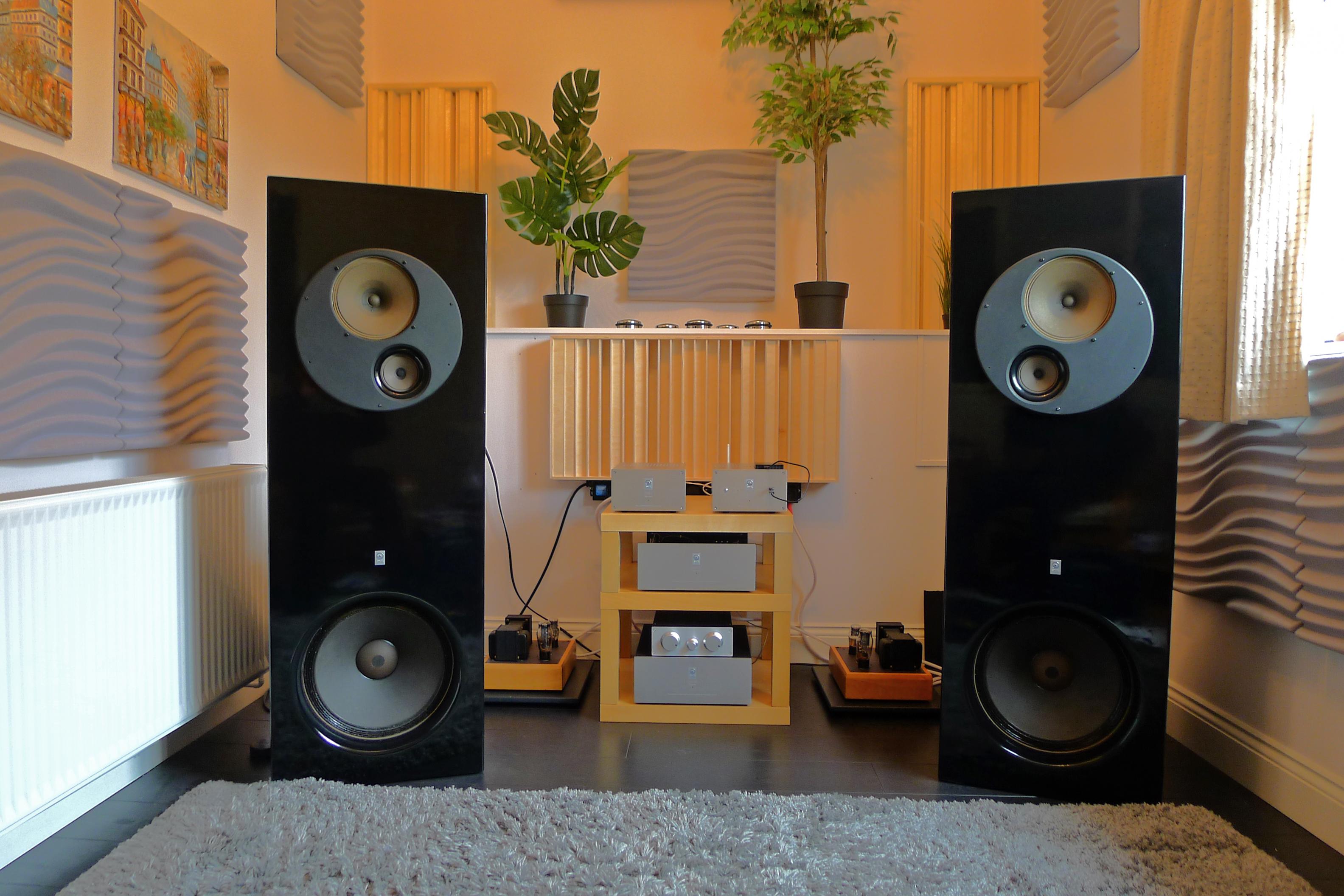

The music server and it's power supply is on the top shelf

By the way, them's some wacky speakers. DIY? Open baffle?

Yes, they are open baffles using vintage alnico magnet drivers with paper cones namely 15" Altecs 416B , 8" Supravox and 4" Saba. The circular assembly around the midrange allows me to rapidly switch between some alternative 8" drivers I have, like vintage Saba Greencones and modern alnico SEAS Exotics. All are silver wired with very simple crossovers (no resistors). Overall efficiency seems to be about 95dB
When I decide on the best midrange I will lock it all down :)

About the speakers...no tweeter?
The 4" Sabas do a reasonable job of frequencies up to 15Khz. Above that my hearing is not good (age related), although I may go back to some Faital Pro HF102 super tweeters I tried some time ago. They did add some additional air to the sound firing upwards at the speaker rear with voice coil centred on the Saba 4". Their efficiency matches the other drivers which I find is important.
