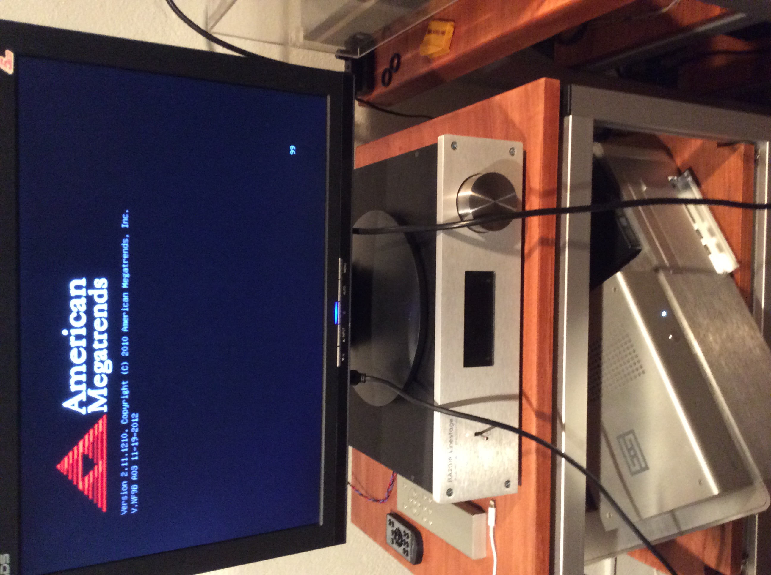

Folks:
I could use some help with a problem with my server that occasionally arises when my home suffers a power outage. Once power is restored, my server hangs during boot-up at "stage 99" (see photo and note the '99' in the lower right corner). The last time this occurred was in October 2020, and DRONE7 and phofman were very helpful in resolving the problem (see posts 4015-4020). Unfortunately, the power grid in my neighborhood isn't very reliable and DRONE7 and phofman's advice then isn't working now (a new thumb drive with a fresh Daphile installation, fresh motherboard battery, all connections checked and rechecked).
The server is pretty simple: an ASRock N3050B-ITX motherboard, 1 Tb SSD, 4Gb RAM, and the next-to-latest version of Daphile. The server is plugged into a Furman AC-215 surge protector and connects to the router via TP-Link power line extenders. I've rebooted the power line extenders to ensure they're working properly. Of course, the real issue is that I can't get Daphile to load -- the server is hanging during initialization.
Do motherboards get old and fail during initialization? I know nothing about motherboard configurations and have avoided messing with mine, but is there a setting that would cure this problem (assuming I can ever get to the BIOS)? This motherboard is about 5.5 years old and has worked flawlessly except in these instances of post-power outage.
Your sage advice is appreciated.
Scott

The boot sector of your hard drive may be hosed. Can you boot into the system BIOS at all to try and boot Daphile from a USB drive. You might be able to reinstall from there. You'll lose all your settings, but at least you can rebuild from there.

The hard drive is not used to store Daphile; Daphile is stored on a USB thumb drive (see the first paragraph in my post above). I cannot get to the BIOS; the server hangs during the initialization process before access to the BIOS is possible (a point I had thought had been made -- if not, mea culpa). I leave the server running 24/7 and, aside from shutdowns whenever power goes out, it has been running continuously for 5.5 years. I'm not sure it's practical to power up and down a server on the basis you're suggesting (perhaps it is for others, but not for me).

The 99 code on other ASRock boards is the SuperIO initialization phase. Perhaps one of your connected devices has failed, Can you try booting with no peripherals attached?
