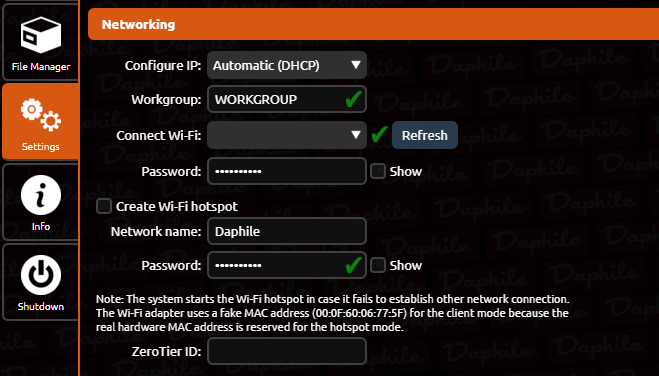

Daphile act as DHCP Server
Hello,
After power down, my Daphile device wake up before the router, and it looks like that Daphile became DHCP server and start giving IP addresses (192.168.128.x) to other devices in the net.
Is there a way to disable Daphile to act as DHCP server?

You could disable the hotspot in the network tap
