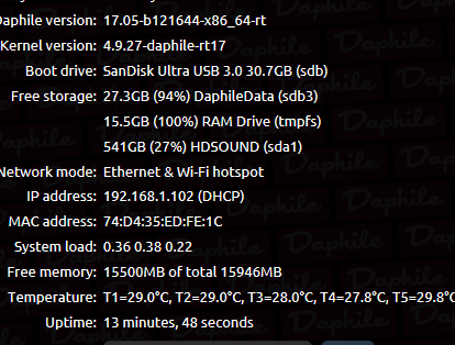

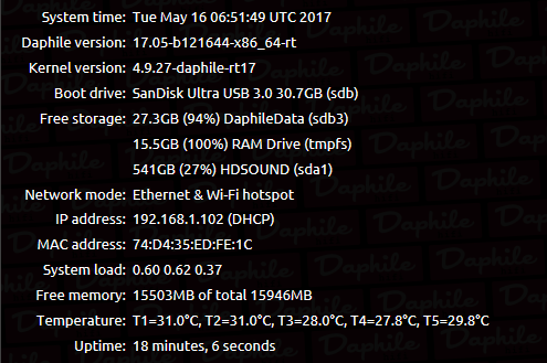

That DAC looks very impressive. I would say your issue a lack of processing power. Dsd512 up sampling is very demanding. Playing from ram has less overheads. Use the info screen to view average cpu load for the last 1,5 and 15 minutes. The number shows the % sum of all cores. Look at the difference playing from ram and otherwise. For dual core the full load value is 2. Ideally you should be running 50% or less. The info CPU value should therefore be 1 or less!
Also I assume you are running at max CPU freq. See the power section in settings. Note I have found you need at least 2.4ghz x 2 for dsd256 up sampling.

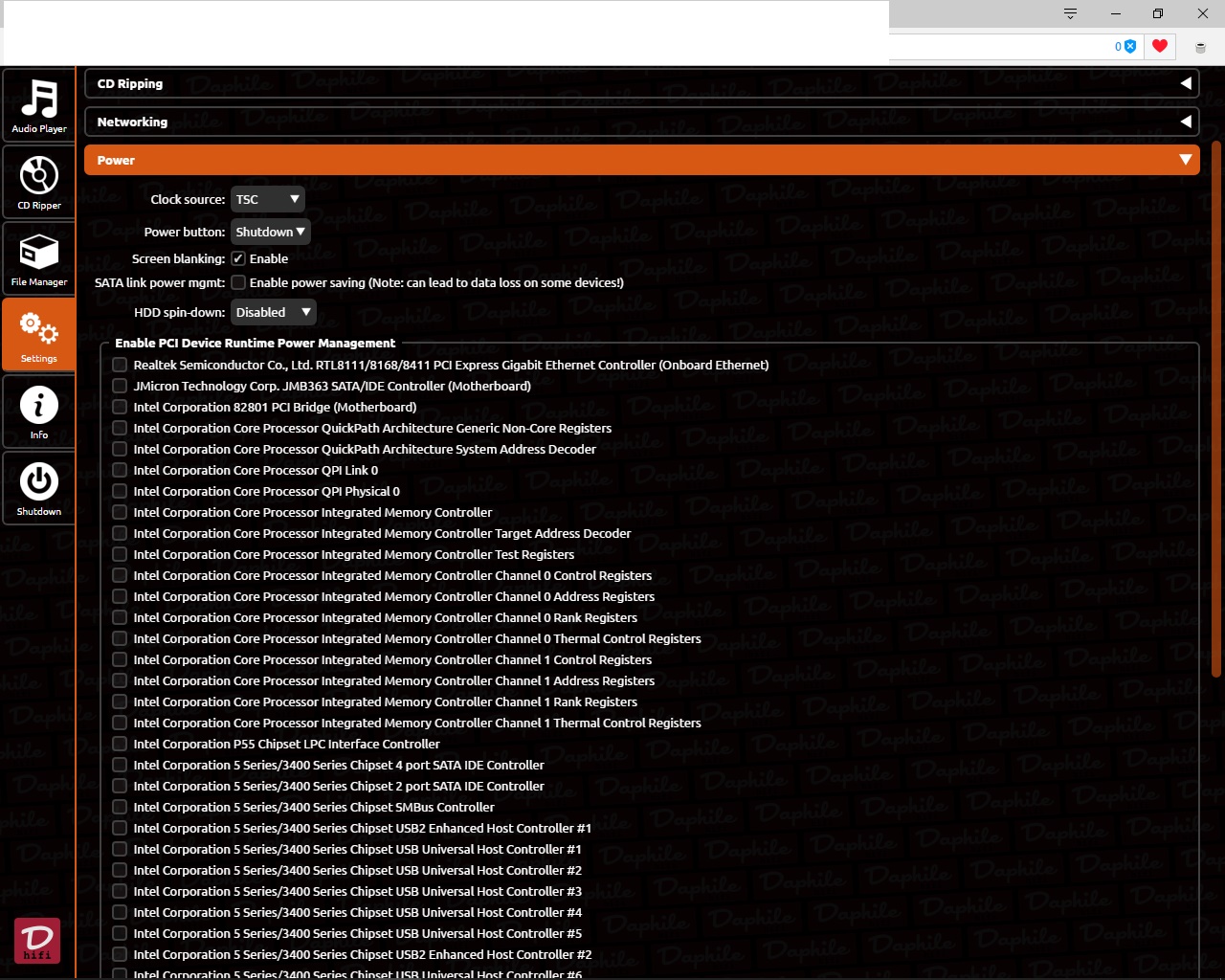

Strangely, I have NO such power option in Power section of Daphile settings to check it run at maximum processing power (see picture of my Daphile Power management interface attached).
I have i5 quadcore Intel CPU which runs at 3,2GHz frequency, it stutters by processing of redbook at DSD256 by any filter setting or attenuation. CPU load shows max 20% per core. My DAC supports DSD256. Playing from RAM at DSD256 is OK.
do you have the cpu-power-safe-Options disabled in bios or fixed cpu-frequency?
this was the Problem in my case after enable it,cpu-frequency Option was visible under power section in daphile
I actually run my cpu overclocked to 3.3 GHz and it's the max frequency where daphile can boot at all. The default frequency of cpu is 2.6 GHz. I doubt if I have the cpu power safe option in bios, but need to check, anyway thanks for the response, you are the first here to help 🙂

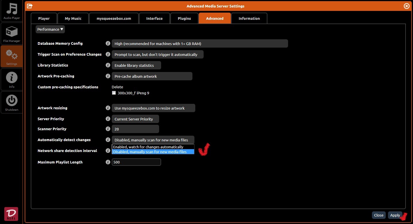

hi sangram
go to Advanced media Server Settings/Plugins
look for Auto rescan/rescan Music libary and disable them
dewy1
Hi dewy1,
First thing I tried was that, it didn't work at all. The setting stays disabled, but after adding new items to the library (say from a network drive) the next time it is powered up it spends an hours removing all the items if the network drive is not powered up.
This is probably not an issue for 24x7 LMS units, but for a compact player it is quite painful. I have a small local library on a hard drive which should be up and running in five minutes even with a full rescan, unfortunately I am not able to get this setting to work.
