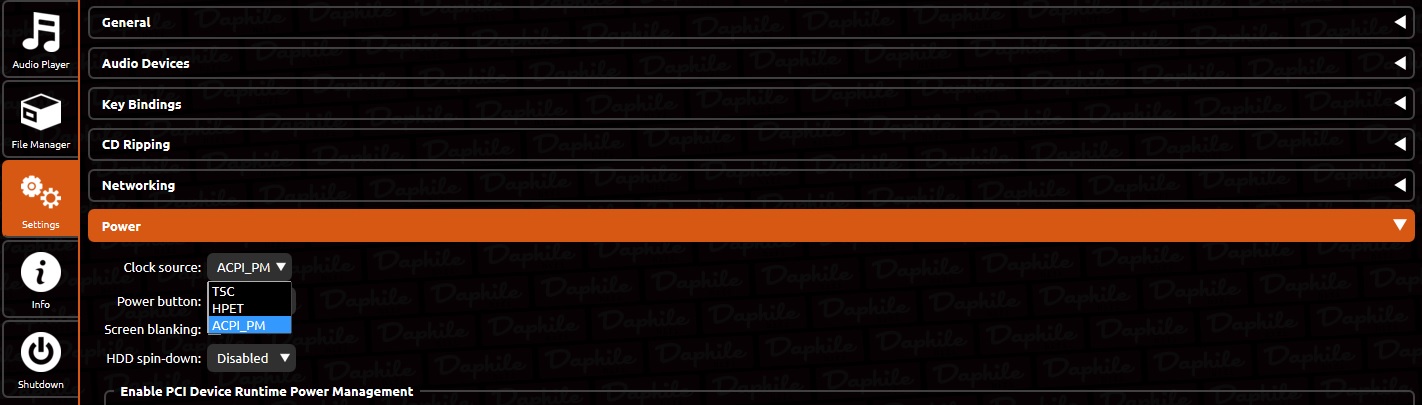

Hi MSHAVS,
What do the different clock source options mean?
G
Here is what I found. I choose ACPI_PM for better compatibility (possibly).
Time Stamp Counter (TSC)
All 80x86 microprocessors include a CLK input pin, which receives the clock signal of an external oscillator. Starting with the Pentium, 80x86 microprocessors sport a counter that is increased at each clock signal, and is accessible through the TSC register which can be read by means of the rdtsc assembly instruction. When using this register the kernel has to take into consideration the frequency of the clock signal: if, for instance, the clock ticks at 1 GHz, the TSC is increased once every nanosecond. Linux may take advantage of this register to get much more accurate time measurements.
ACPI Power Management Timer (ACPI PMT)
The ACPI PMT is another clock device included in almost all ACPI-based motherboards. Its clock signal has a fixed frequency of roughly 3.58 MHz. The device is a simple counter increased at each clock tick. However the ACPI PMT is preferable to the TSC if the operating system or the BIOS may dynamically lower the CPU's frequency or voltage. When this happens, TSC's frequency changes causing time warps and others side-effects, while the frequency of ACPI PMT does not.
Sounds interesting, but maybe it's too technical for me
You can now, with new version..Sounds interesting, but maybe it's too technical for me. Is it something I can change myself on Daphile settings?
Great. Thank you Holger... ehm... vulejov 🙂
I turned to ACPI PMT but things got possibly worse. Also set CPU from 1200 to Maximum but nothing changed. Think I'll have to switch back to 16.04 version.
