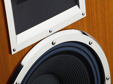

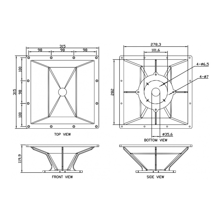

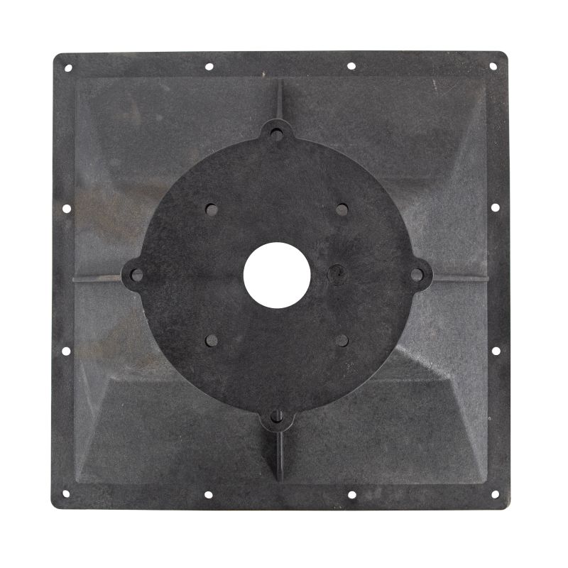

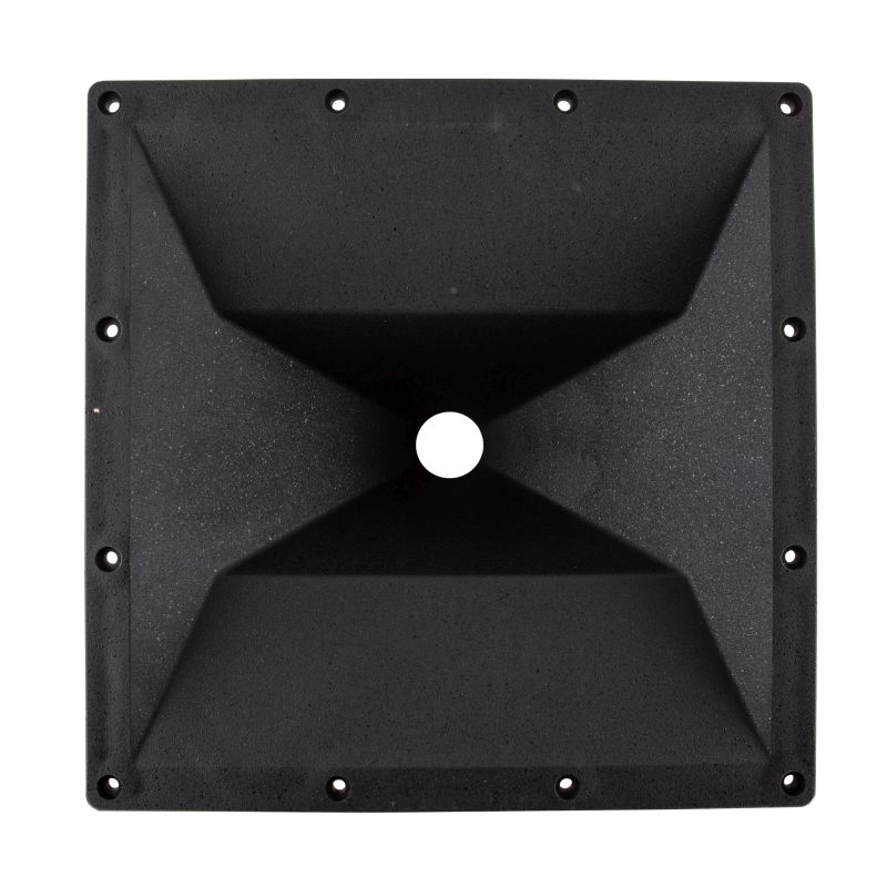

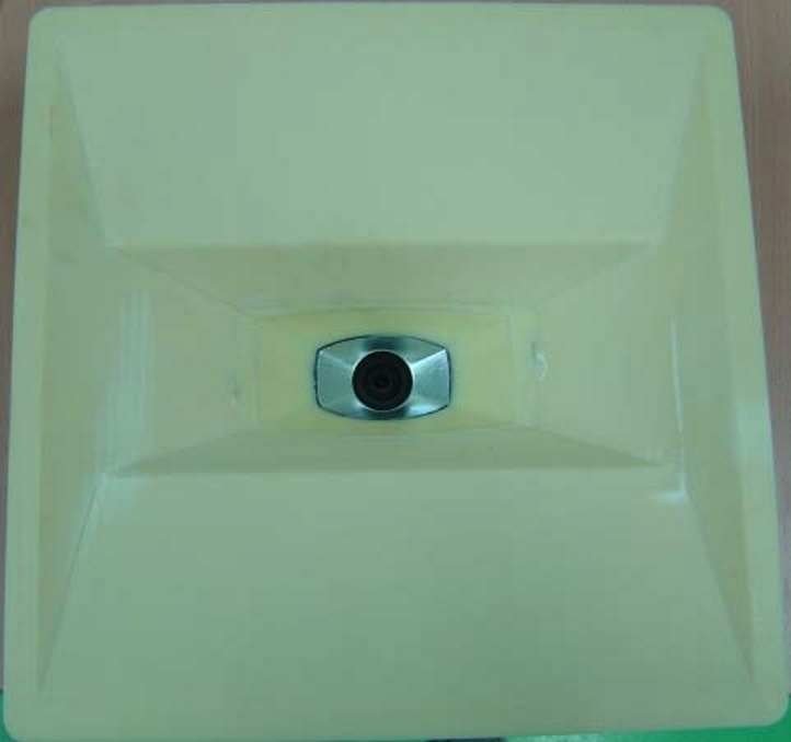

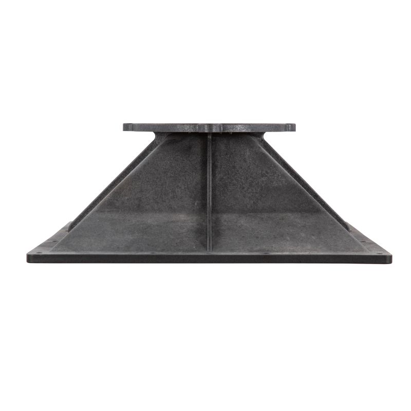

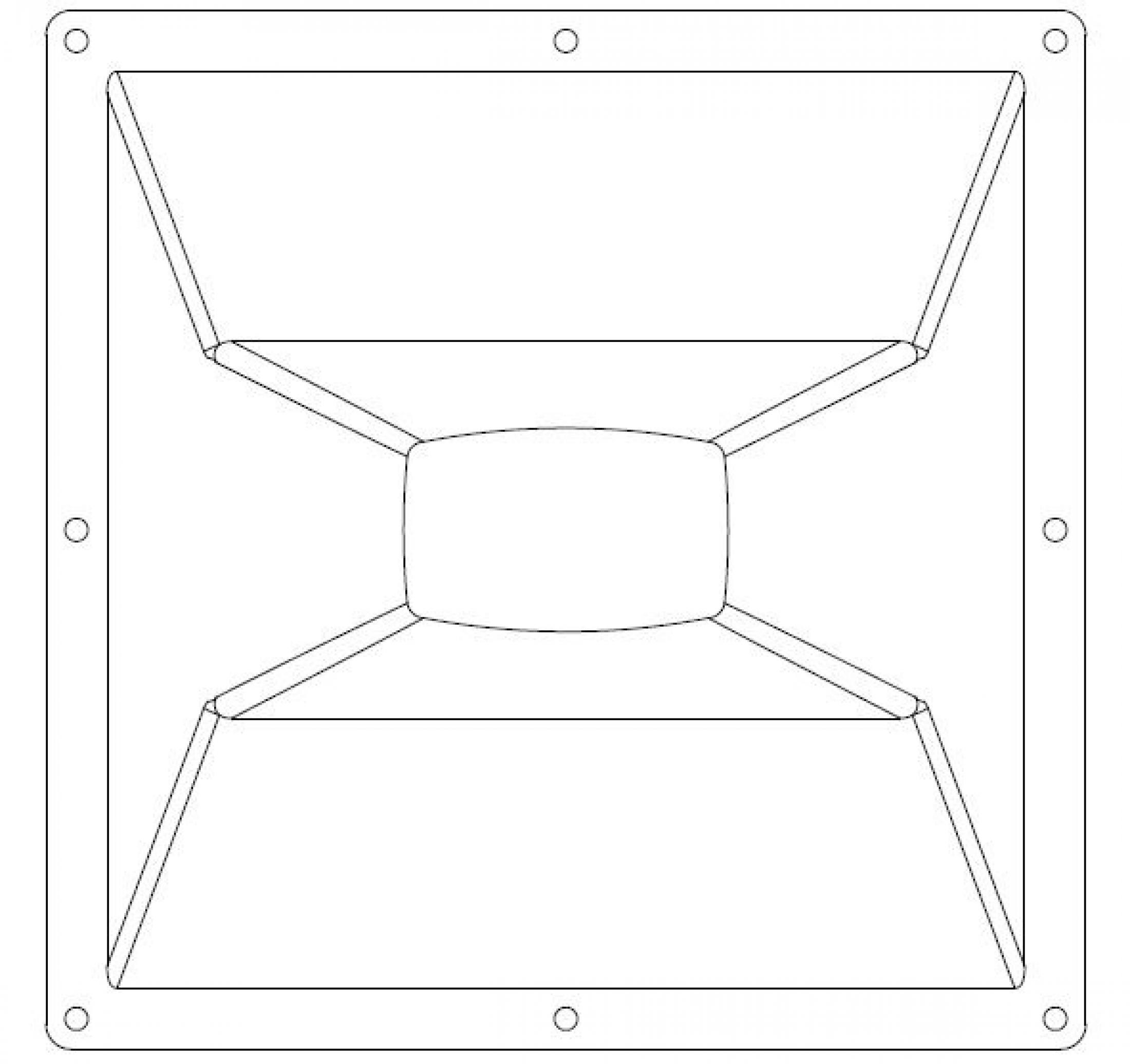

Around the time the M1 was launched, about 10 years ago, I was researching horn-throat transitions.
If you take a closer look at the Hertz horns...

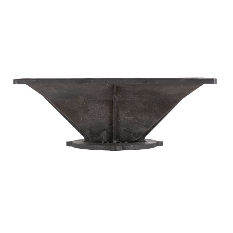

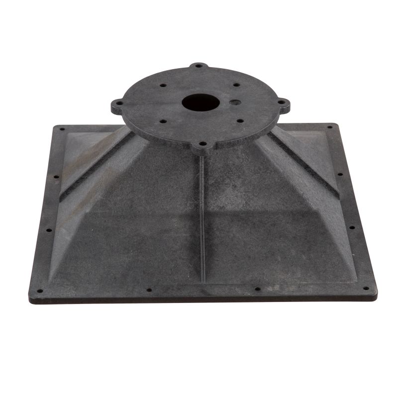

You'll notice the throat section differs from similar horns, like this Monacor MRH-300 aka P.Audio PH-94:

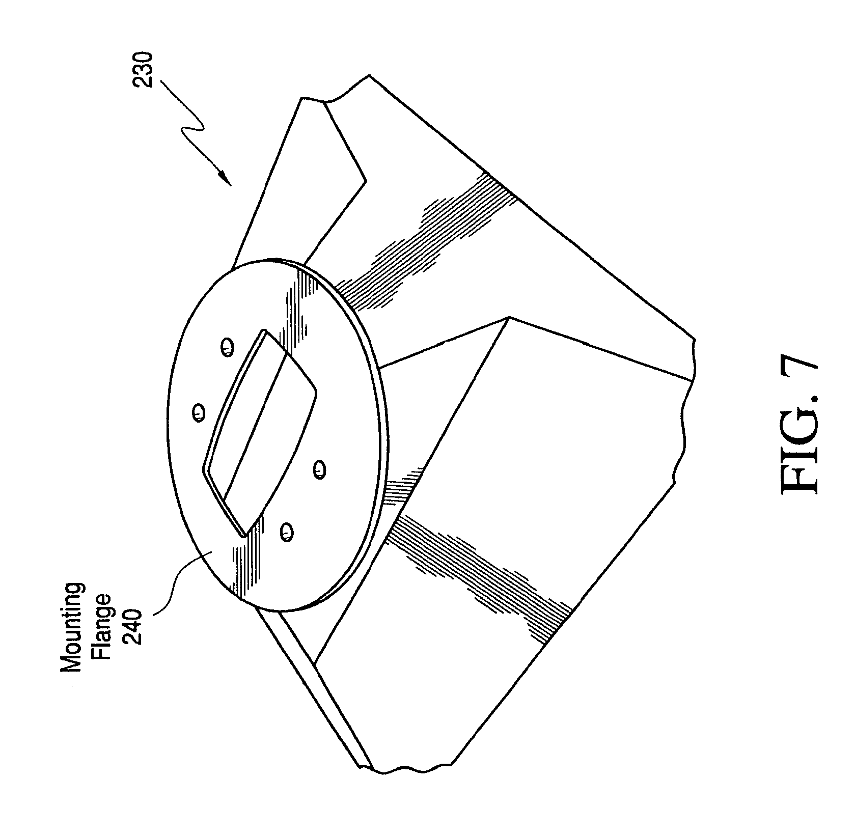

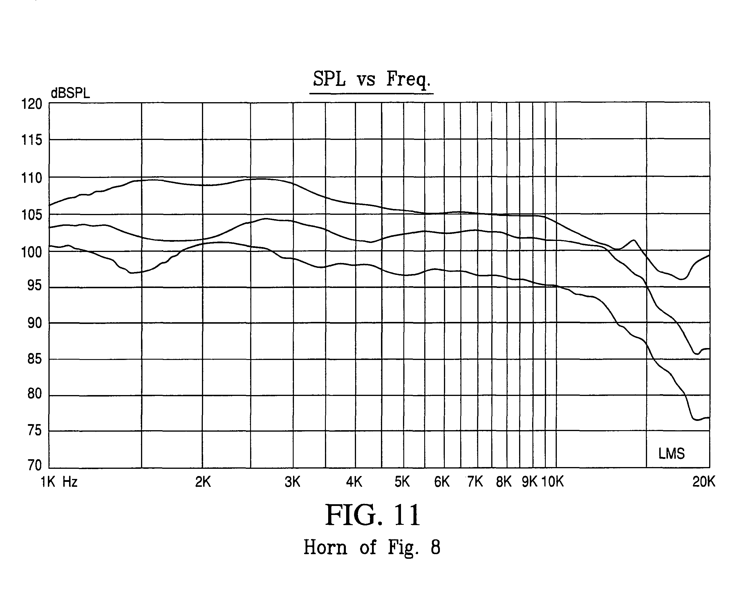

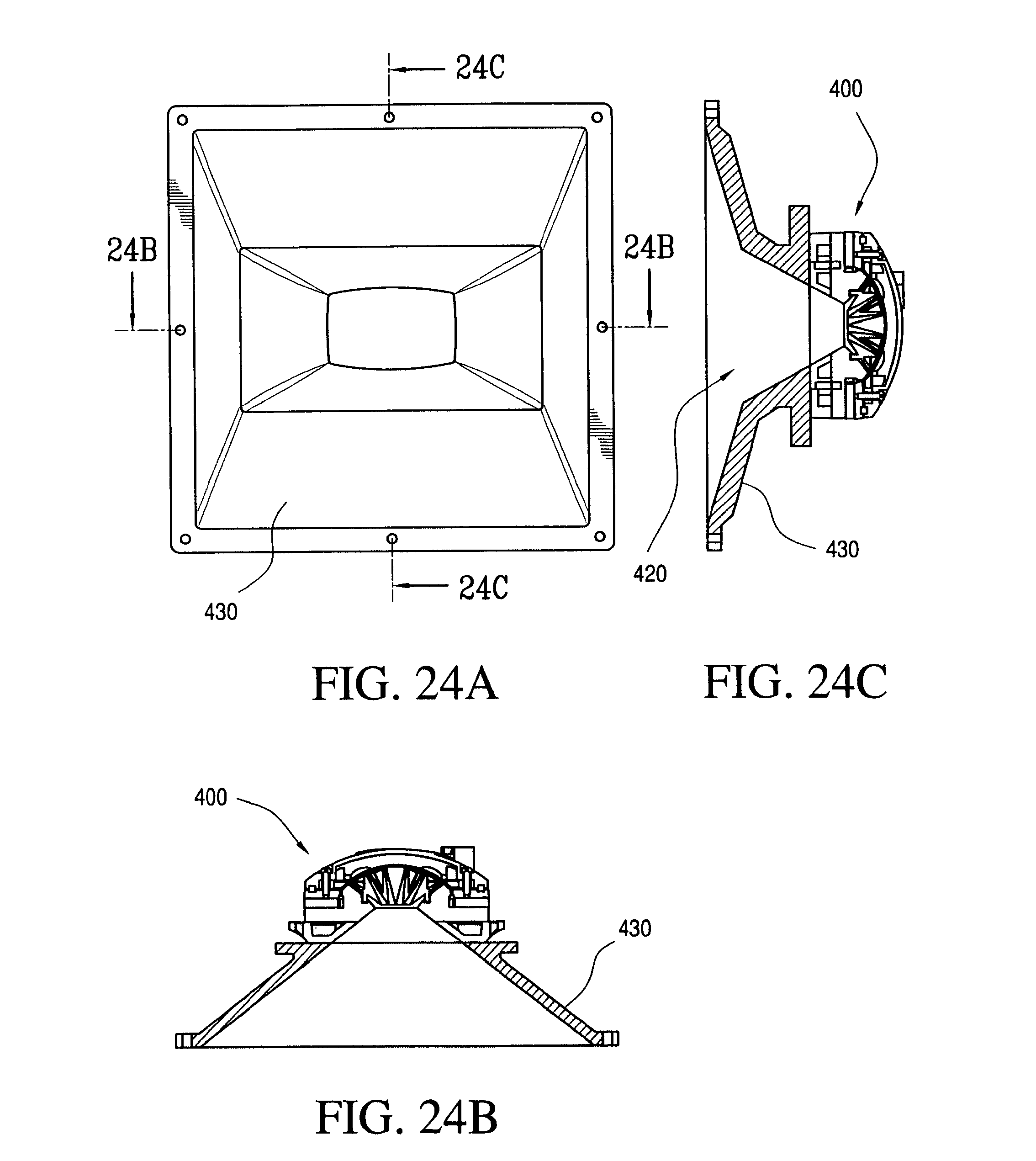

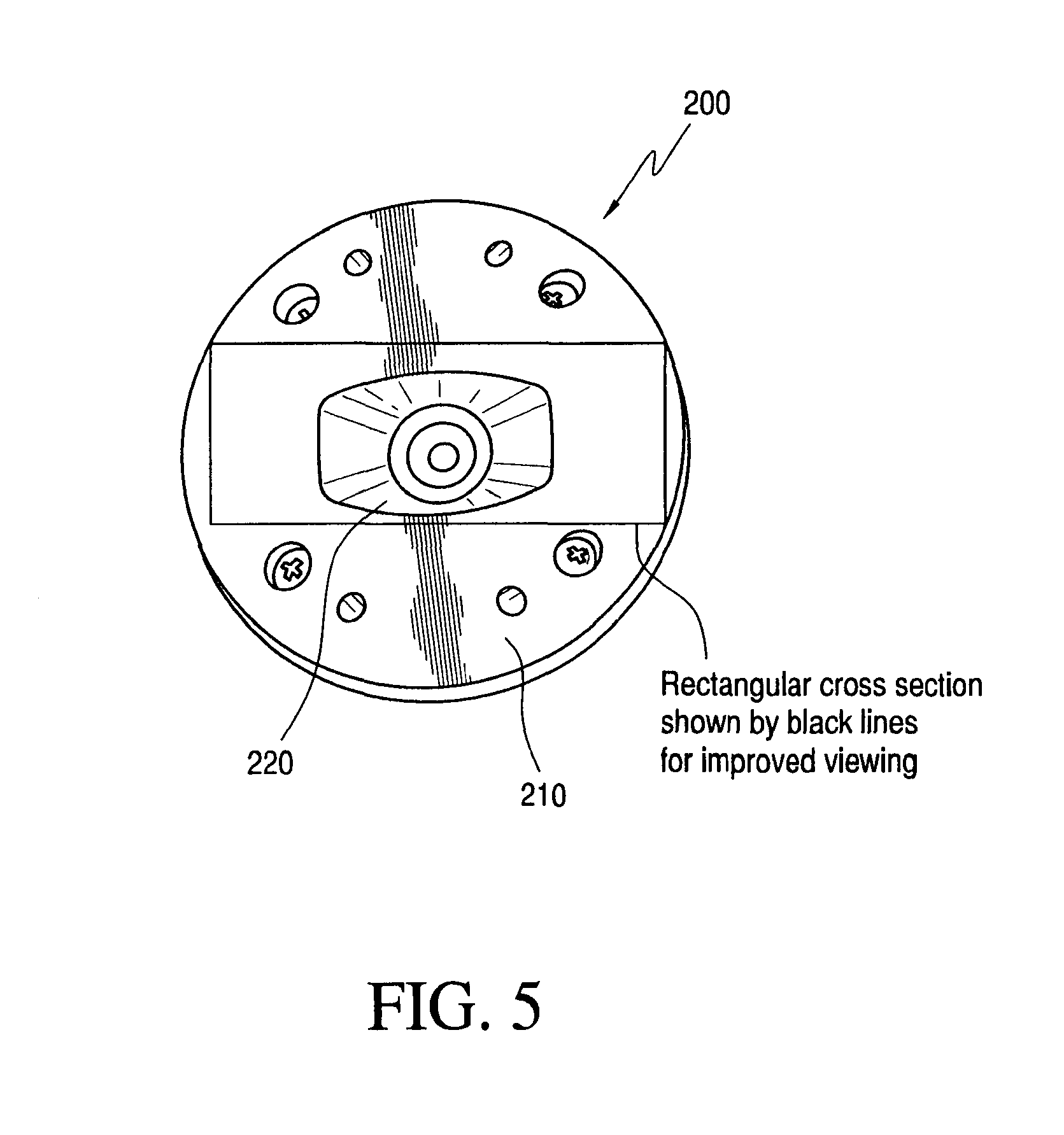

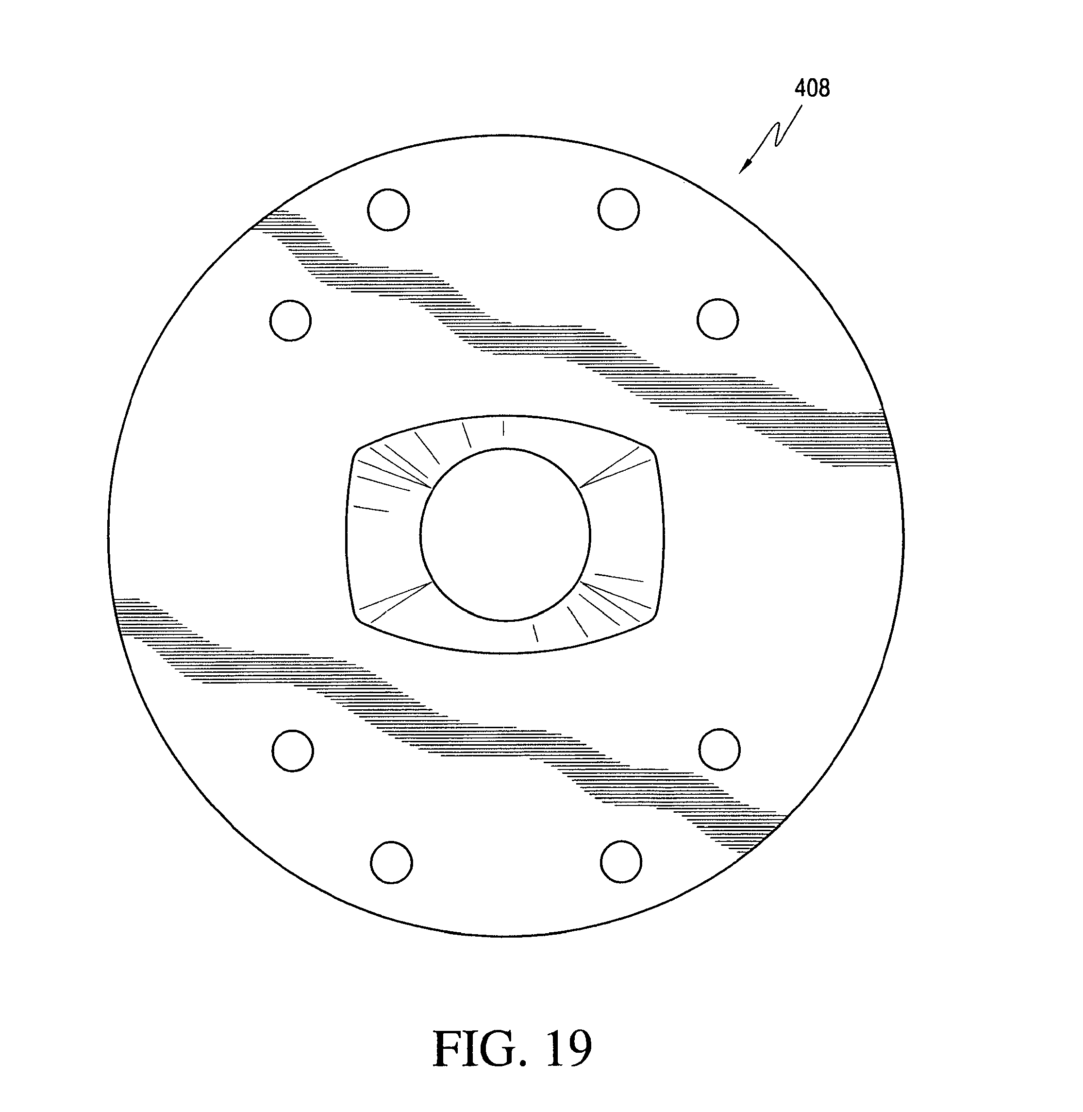

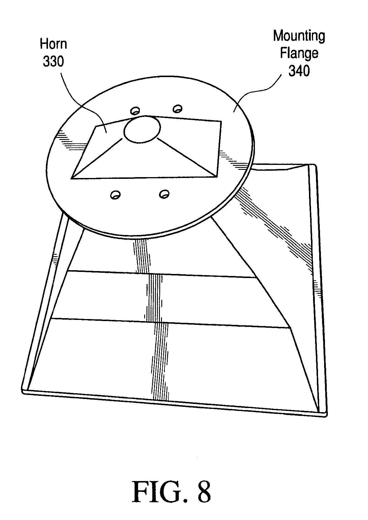

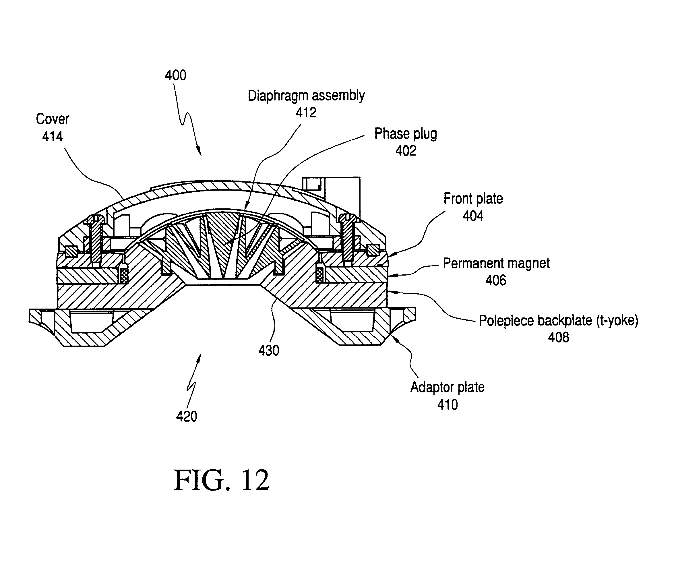

The origin/inspiration.

Interesting research, is that a 1" or 1.4" Horn flare?

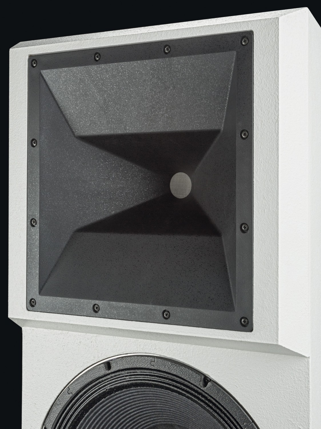

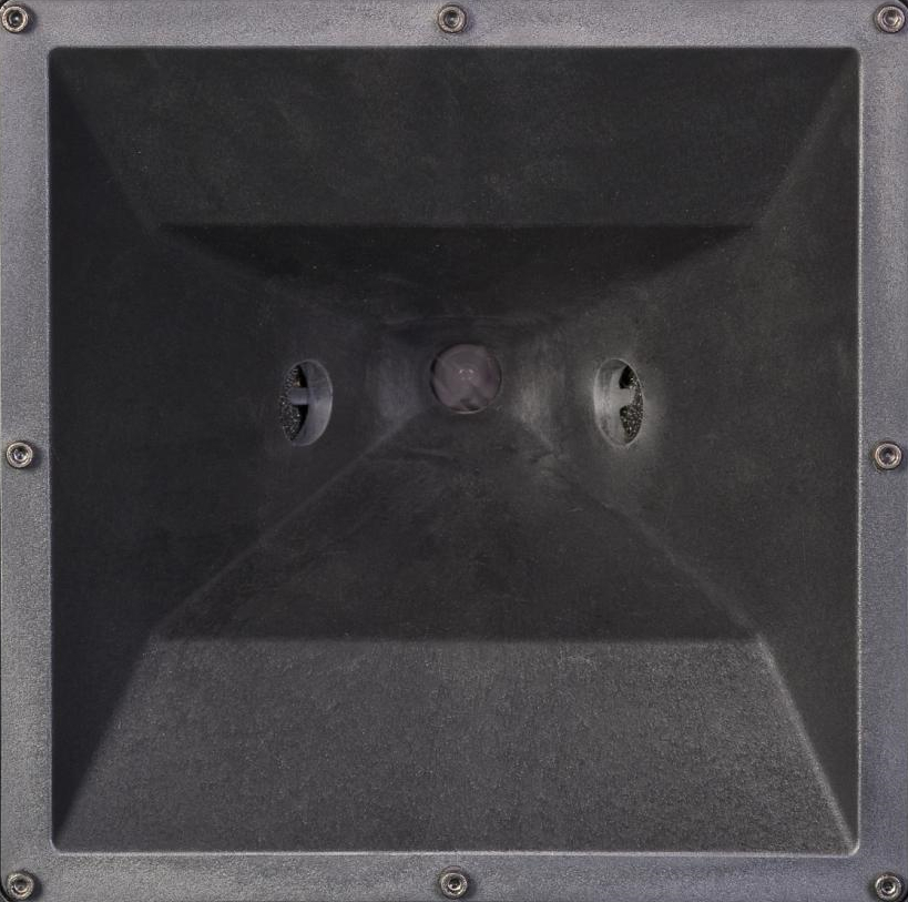

A couple of close up images of the M1 horn
The M1 Horn flare
Close-up of the M1 horn flare

Wonder if anyone identified what model this horn flare is?
It's what I call an "Altec Mantaray derivative".
Plenty of these available.
Some examples, in order of resembling the Hertz horn:
- Monacor MRH-300
- Beyma TD-360
- P.Audio PH-64, PH-94, PH-642, PH-942
- BMS 2230.

Looking at the photo's - it looks like a common *commercial (cast aluminum) horn that has been cut-out at the entrance and has a custom guide-adapter plate to increase expansion from the compression driver into the horn. (..and obviously the external mount plate (chrome-plate) is custom as well).
*and the horn is being used horizontally with its vertical orientation (resulting in narrower horizontal dispersion with a higher spl-loss rate off-axis.)
The driver appears to be a Beyma SMC-65, so 1.4".Interesting research, is that a 1" or 1.4" Horn flare?

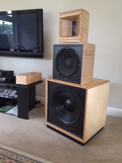

I built a 3-way (partly) modelled on the M1, using Faital Pro 18 inch sealed 'sub' (powered by 500-watt MiniDSP amps), Beyma 12 inch mid and Beyma TPL150 in custom CNC'd waveguide. Passive LR2 xover for the mid/horn (200Hz / 2,500Hz). Very big/clean output. Paired with Weston Acoustic Class A power amps and pre-amp. For a gent in Malaysia. Personally, I like my 3-way horn rig (CNC'd) myself, with Altec 15 416 bass in my owned designed horn (ported), Yuichi 290 plus 3,000Hz lathe turned tractrix horn. All passive xover, 500Hz/3,000Hz LR2.

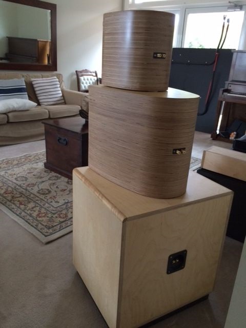

My own design will take some cues from the M1 but will use separate modules for each driver the cabinets will be over engineered as I did with my hommage to the Wilson X1 some 25 years ago!! my first real big build in my 20s
My use of separate modules means I can play about with diffeent drivers with dedicated crossovers.
Early days with the concept though.

Great!I built a 3-way (partly) modelled on the M1, using Faital Pro 18 inch sealed 'sub' (powered by 500-watt MiniDSP amps), Beyma 12 inch mid and Beyma TPL150 in custom CNC'd waveguide. Passive LR2 xover for the mid/horn (200Hz / 2,500Hz). Very big/clean output. Paired with Weston Acoustic Class A power amps and pre-amp. For a gent in Malaysia. Personally, I like my 3-way horn rig (CNC'd) myself, with Altec 15 416 bass in my owned designed horn (ported), Yuichi 290 plus 3,000Hz lathe turned tractrix horn. All passive xover, 500Hz/3,000Hz LR2.
I plan to design a speaker with similar approach with Beyma TPL200 + 10MCF400Nd and probably 21PW1400Fe V2.
Can you name your 12" mid please?
