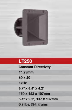

The horn used on the M1 looks like the 3.9” deep Aluminum LTC250 60x40 sold by several vendors including Eminence. This shallow depth was probably selected to create good CD time alignment to the 12" midbass. If you look close at the M1 you can see that the LTC250 horn is rotated so the narrower 40-degree beamwidth is horizontal. I suspect this was necessary to match the polar dispersion of the ribbed cone 12" midrange at 1600Hz. So, you can still get a smooth controlled directivity function if your 12" midrange produces smooth output beyond 1600Hz, but you may need to accept a 40-degree beamwidth beyond 1600Hz.

I tried googling "LTC250" 60x40 Horn flares, but came up with nothing.
The earlier (2010) Eminence catalogs have information on the LT250 horn. The depth spec varies from 3.9" for aluminum to 4.2" for ABS plastic.
