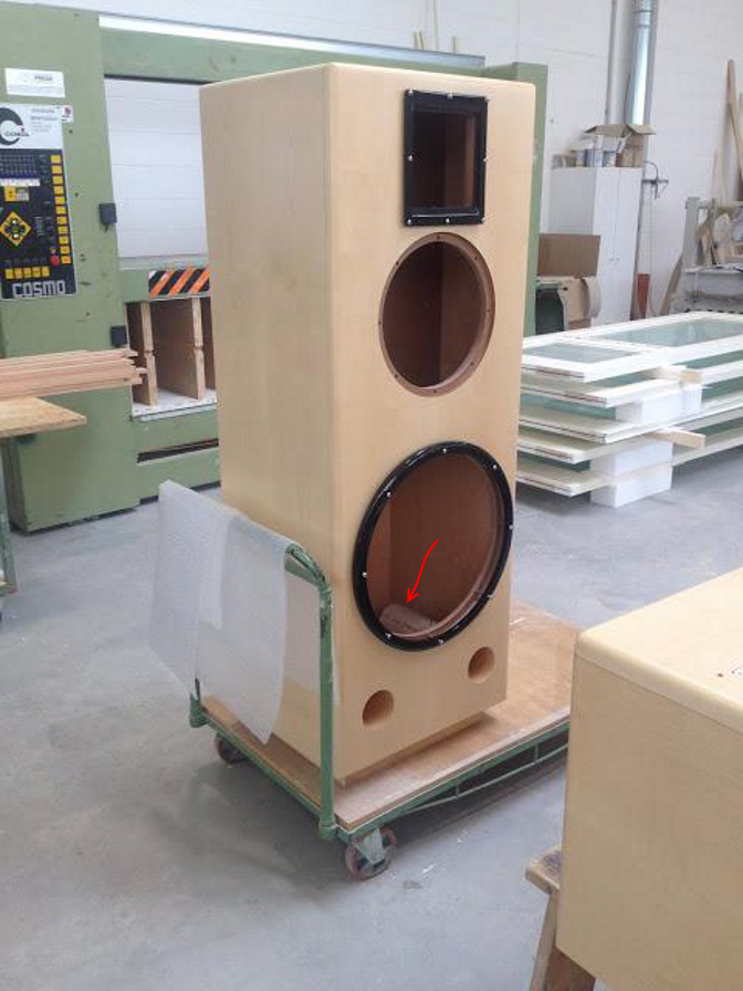

a footage of M1 speaker. The cabinetry of this speaker IMO is no way in the $100K-ish league. just look at those self-tapping screws
attachment.php
652190d1513804704-daniel-hertz-levinson-m1-wow-eminence-lt250-jpg
The horn is installed wrong. The diffraction slot is supposed to be vertical.
I made the same mistake, back when I was learning about horns. When you look at the thing, it doesn't make sense, you think "the wide part of the horn should be horizontal." It just seems intuitive.
But that's not how it works.
The diffraction slot 'squeezes' the wavefront into a ribbon shape, which allows for wide horizontal directivity.
Installing it the way that Levinson has is no good; it means that the *vertical* directivity will be wide, which means more sound bounced off the floor and the ceiling, while narrowing the sweet spot.
Plus, that's just a terrible horn. It's like a clone of a bad design from the 70s.

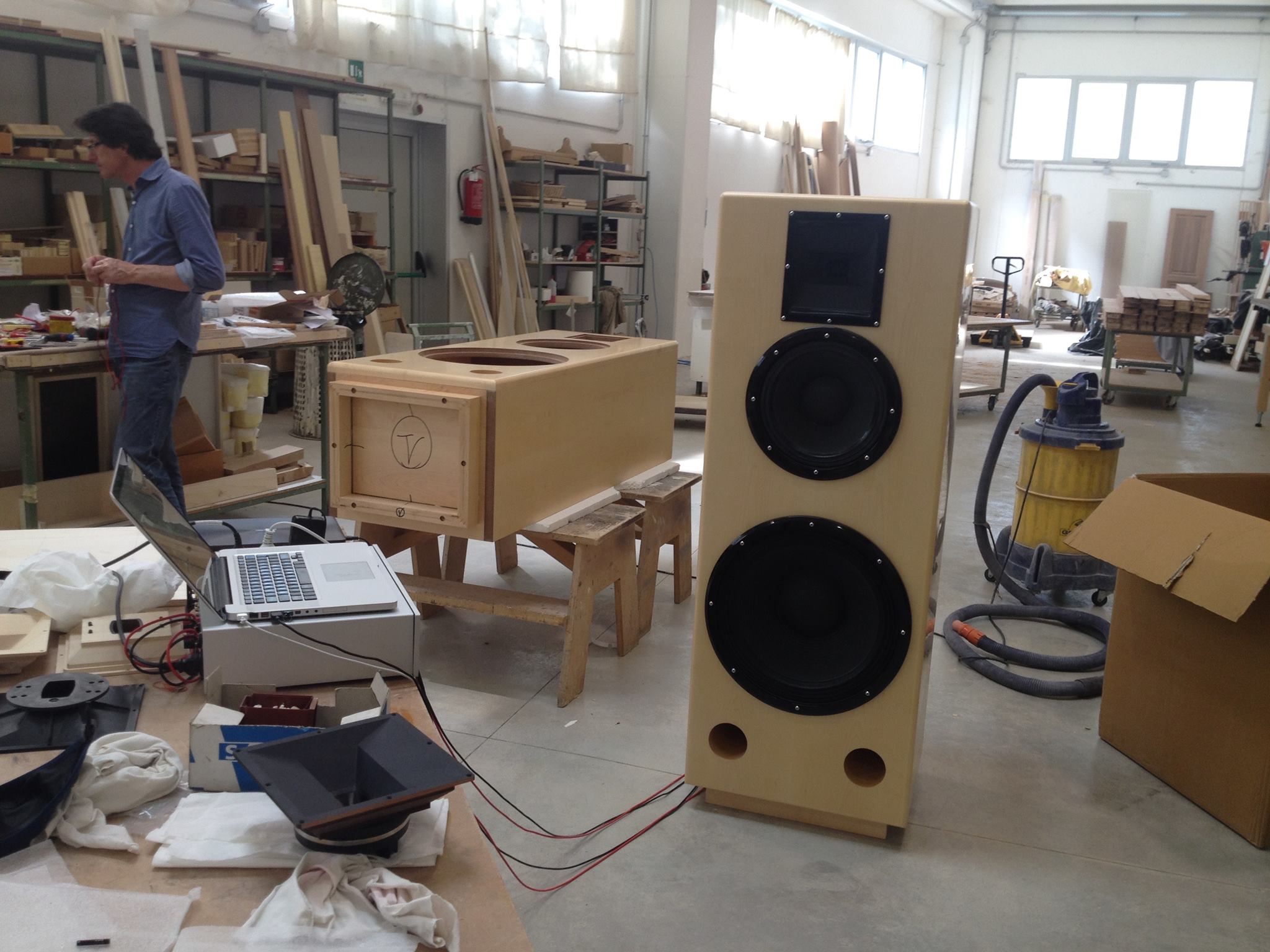

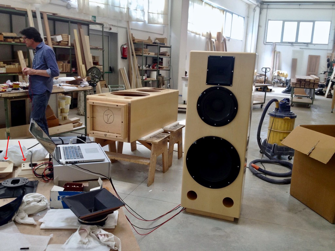

High frequency horn flare
It's not the TLC or the Beyma.
I searched quite some time for all kinds of horn flares. Attached a picture of the Italian workshop with the horn flare in front on the work desk. It seems a very, very short horn with an unusual horn throat, not square and not round. Any one has an idea of the brand?
in this picture there are two horn and the one in the left side of the picture definitely seems to be made of wood.
