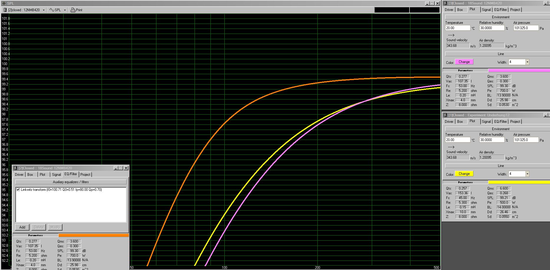

A few driver sims I had on my computer that might help illustrate design alternatives.
--midbass--sealed
Beyma 12P80Nd Qts ~0.25 2 cuft stuffed box "tight transients"
Lambda TD12M Qts ~0.7 0.7 cuft stuffed box "normal transient"
--woofers--ported
Beyma 18P80nd modest bass shelf in 10 cuft
Beyma 18XL60v1 standard Qts=0.7 in 12 cuft
Peavey 1808-8HPS standard Qts=0.7 in 8 cuft
Interesting , using a speaker with a Qts of .7 in a ported enclosure ....

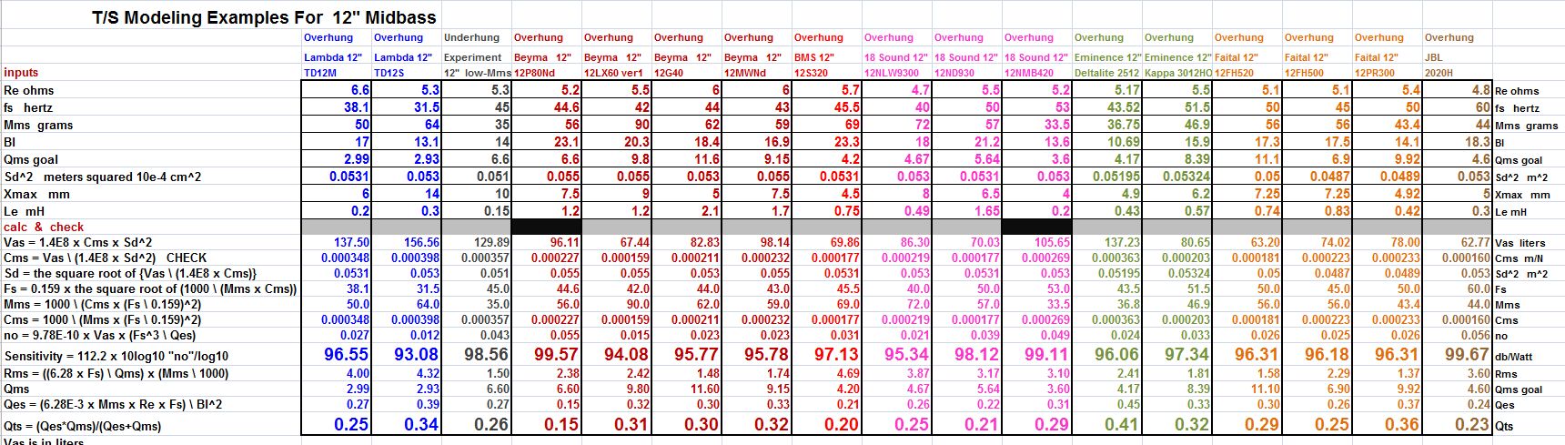

Mark Levinson stated that the Daniel Hertz M1 uses custom drivers. Attached T/S spreadsheet of high quality production 12" midbass. The M1, similar to the Geddes Summa, decided to create an audio illusion which includes room effects below the horn/baffle polar control (1600-normal 1800Hz-M1) frequency.
A 3-way M1-type design (woofer+midbass+CD/Heil) which uses a 12" midbass for high efficiency would have a few design decisions:
1) sealed volume midbass
2) ported/aperodic volume midbass
3) active Xover with equalization
4) passive Xover with port tuning options for passive room bass equalization
5) Low(<0.2) Qts 12" midbass to optimize tweeter sonic interface
6) medium(0.3-0.4) Qts midbass to optimze bass sonic interface
The Qtc=0.15 Beyma 12" midbass is an interesting solution for a large'ish low Qts sealed volume with active Xover that blends well with the CD/HEIL tweeter.(1)+(3)+(5) or (1)+(2aperodic)+(5). The 12P80Nd and 18P80Nd share Beyma's latest motors and cones.
The Qtc=0.29 18Sound 12MBW420 has a very light(33g) cone that makes it a good solution for passive Xovers. (1)+(4)+(6)
An underhung motor with similar T/S specs is possible, and would allow more Mms in the cone material, and waste less Mms in the voice coil.

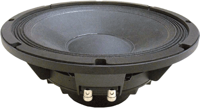

Beyma has the 12P80NdV2 with a flat SPL over a wide bandwidth
BMS has the 12N820
18Sound has the 12ND930
