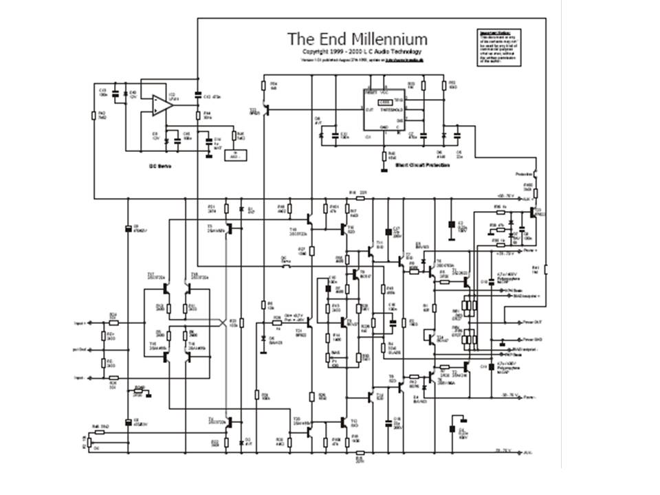

I am neither an expert nor a fan of Hawsford style error correction circuits. Personally, I prefer to increase the number of output transistors to get a high damping factor, and use TMC global feedback on a complementary symmetrical topology with optimal Class AB bias.
I have simulated the "End Millennium" designed by L.C. Audio Technology and have seen a 20x reduction in 20Khz THD when a high inductance, low impedance speaker model was used. Under real speaker load models the THD will reach 0.1% - 0.2% even with Hawksford. Considering the 0.27 Ohm emitter resistors in the output, the Hawksford circuit does a good job against Ohm's law. In the test literature, Dan's Momentum Amp THD is similar.
So, once again the buyer must trust their own ears, or trust the advice of a golden ear owner. Does low THD from global feedback sound better than modest THD with a clever use of local feedback as in Momentum or End Millennium?
The beauty of designing your own power amp is being able to optimise the output zobel network to your speaker system. I also use conjugate load matching to keep the impedance purely resistive to > 200kHz.
For a commercial designer it's obviously a different story, and compromises need to be made.
