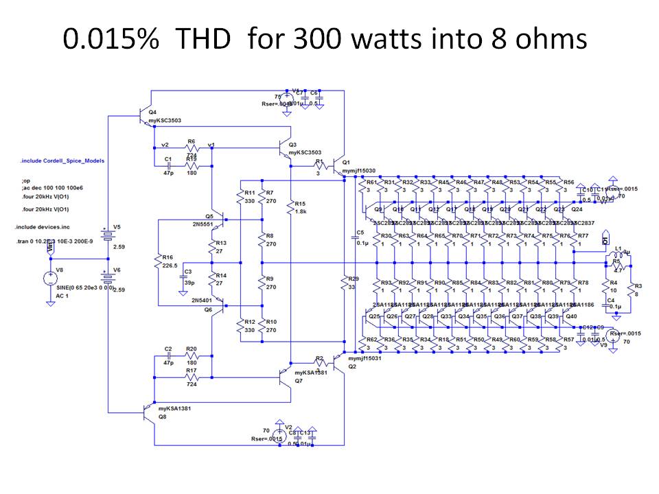

"In the interview Dan talks about a low feedback design with only 8-10 dB overall feedback, but more around the output devices that need heavier feedback to perform well...sounds a bit like two split feedback loops."
From what I have read, Dan's Momentum amp does not have global feedback from the output to the input, but it does have (patented) nested feedback over the input stages plus (large amounts of) error correction feedback on the output stage.
The Momentum design goal appears to focus on isolating output noise from the high sensitivity diff input. To me, this is the most interesting discussion point.
1) The reverse currents from high inductance speaker voice coils can affect the sound if they are fed back to the high gain differential input stage.
2) All Krell amp schematics I have seen use MOSFETs for the first output driver stage, with the goal of isolating the speaker's reverse currents from the gain stages. I do not know if the Momentum design includes this voltage-to-current isolation. John Curl's amps also use a MOSFET output driver for this same isolation goal.
3) RFI noise, especially from digital Wi-Fi networks and in-home local networks, can get picked up on the speaker interconnect cables and fed back to the high gain differential input stage.
4) Nested feedback over the high frequency, low capacitance input stages is more accurate than global feedback that goes around the 24-pair output stage. Very little noise gets injected into the intput stage loops.
Bob Cordell and Doug Self favor designing stable circuits to which you add large amounts of global feedback.
Charles Hansen(Ayre) favors designing very simple but stable circuits with no global feedback.

Looking at pictures of the chassis design, I would say that it is very immune to any radiated RF and the only ingress would be through connectors, but one can apply very successful filtering by means of feed-through capacitors and inductor to attenuate and avoid RFI to get into the circuits.
I am not convinced about the statement that even split up negative feed-back loops eliminate noise ingress from the output stage, in fact it will enhance it, if the same noise is not present on the input of the differential stage.

Speaking about several hundreds of MHz and units of GHz (RFI cell phone range), any input differential stage is completely ineffective. Even feedthrough filtering may be ineffective, if the product is not intended and designed/built for GHz range, which is never the case in audio, regardless Names.
Can any expert in output error correction circuits describe how to improve the basic circuit in the attached schematic for 12 pairs of 60Mhz Sanken output transistors? The Spice simulation shows 0.015% THD for 300 watts into an 8 ohm load.
What is the best output error correction circuit for 12 pairs of 60Mhz power transistors?
As a reference, a fully symmetrical design with global negative feedback using the same output transistors simulates at 0.00008% THD for 300 watts into 8 ohms.
