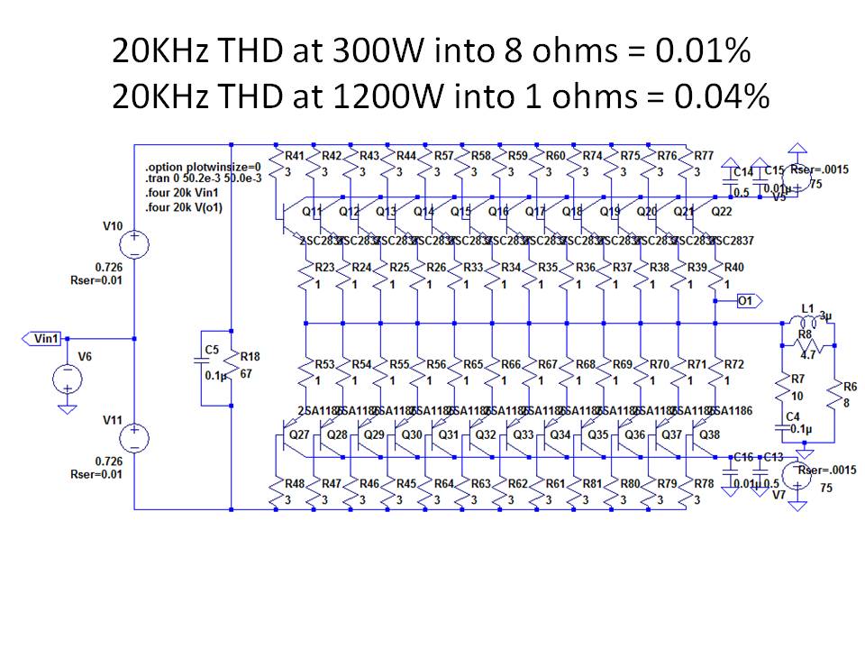

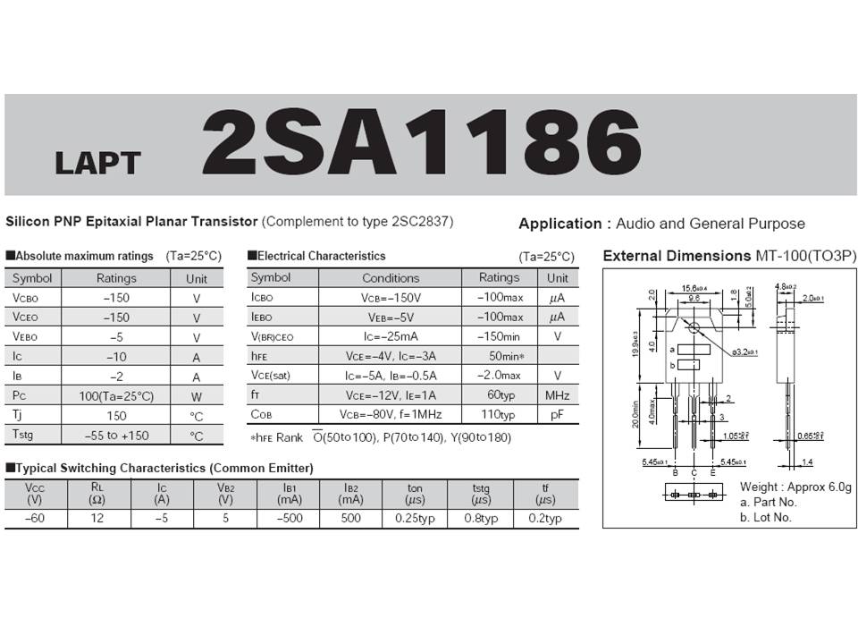

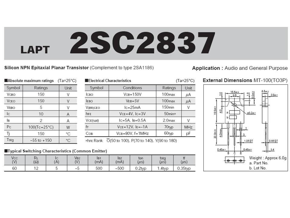

The Sanken 2SC2837 NPN has a typical Ft = 70Mhz, and the 2SA1186 PNP complement has a typical Ft = 60Mhz. I have used them in several multi-transistor output stages because of the low input capacitance and high Ft. A 24 transistor output stage driving 300 watts into 8 ohm load at 20Khz simulates to 0.01% THD. Driving 1200 watts into 1 ohm simulates to 0.04% THD @20Khz.
A Spice simulation of a "typical complementary topology" Class AB amp using global negative feedback driving 300 watts into 8 ohms at 20Khz simulates to 0.0002% THD. The idle power is less than 70 watts. Global feeback improves dampening.
With 70Mhz output transistors, it is difficult to find pre-driver transistors with both enough Ft (150-300Mhz rule of thumb) and enough power dissipation (20 watts) to take full advantage of the fast outputs. Krell often parallels several transistors for the pre-driver, perhaps to get optimum Ft, perhaps because they put their output transistors on several physically seperate heatsinks and use separate pre-drivers with each output group.
Anyone know of a 150Mhz, 160V, 20-30 watt pre-driver pair?
