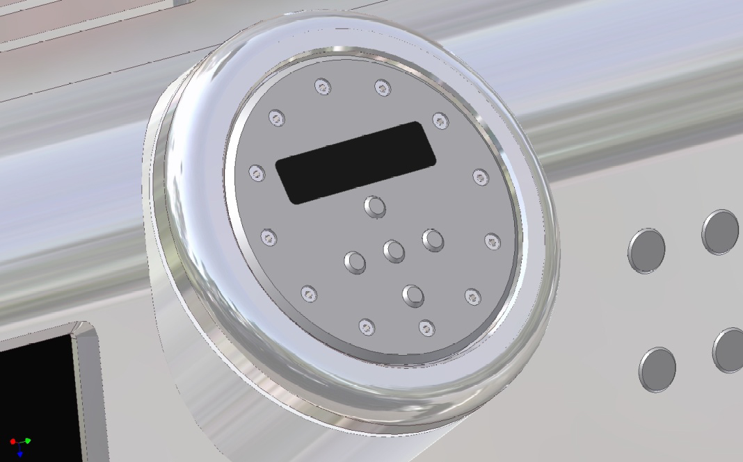

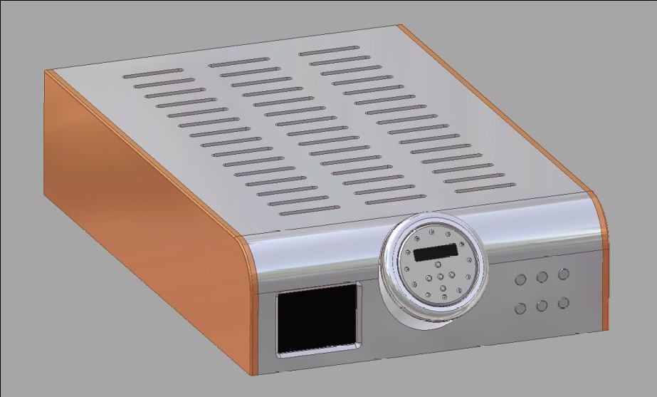

you will find a pic from the associated preamp (btw - also Nelson's "Concept" monaural power amps with an outdoor power supply)
and here the associated PDF:
http://www.dagostinoinc.com/documents/Preamp-release-1-11.pdf
