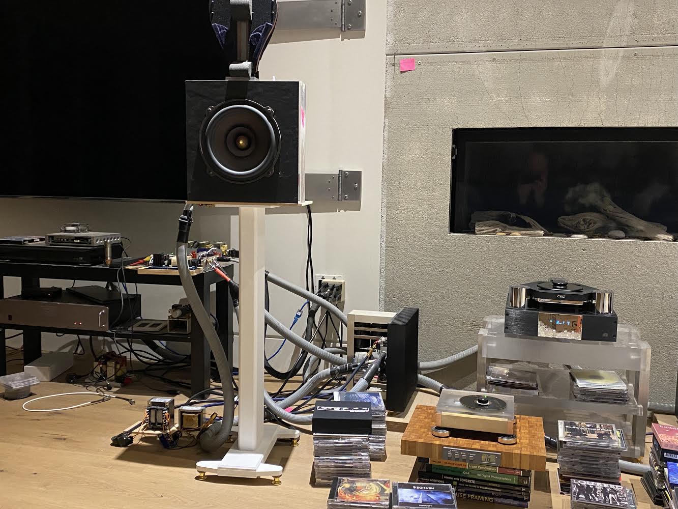

I’ve been using computer transport for 10 years or so and it seemed to work well. Last year, out of curiosity, I hooked up CD Transport and was pleasantly surprised: it sounded different, smoother and more analog like.

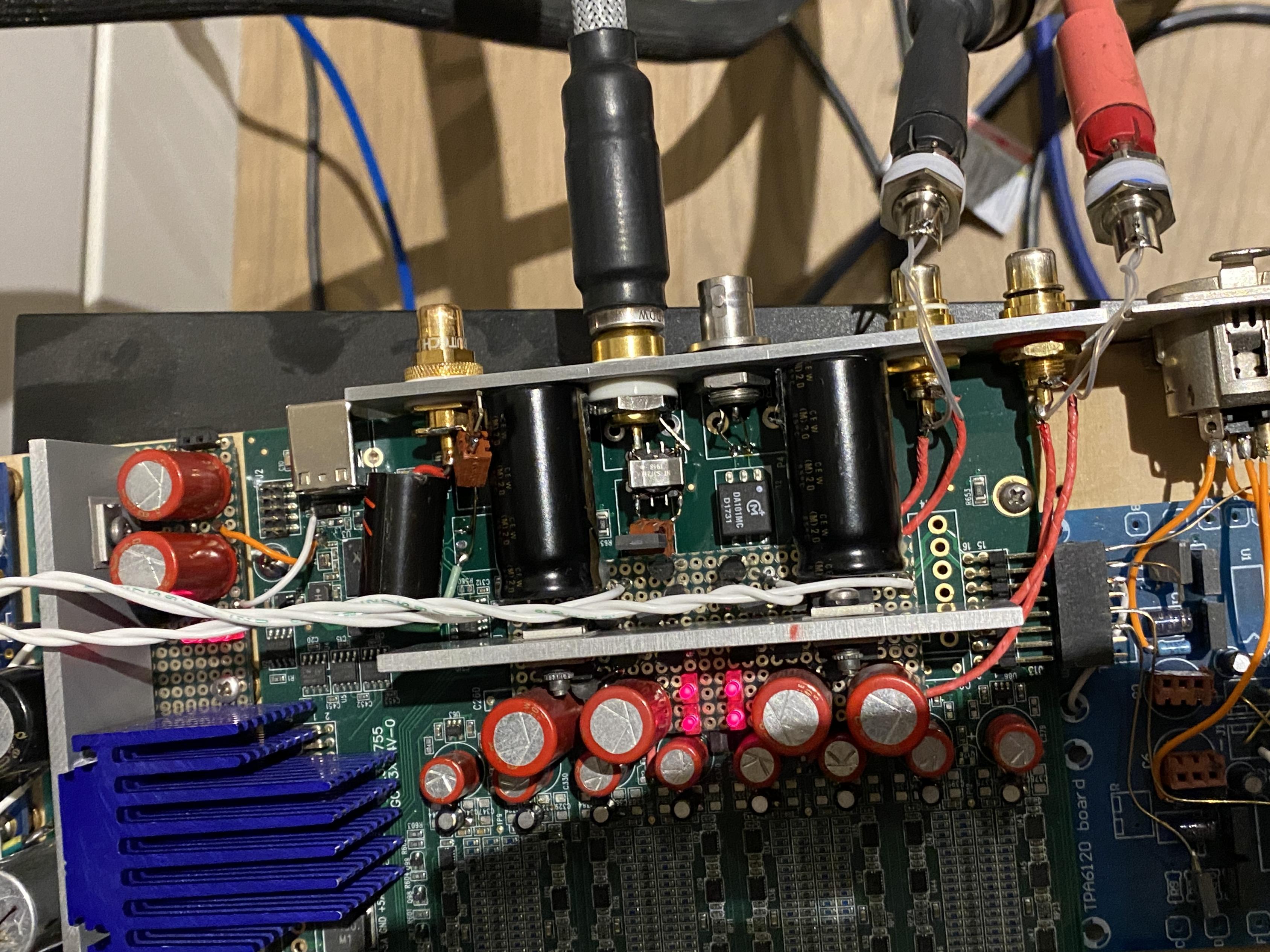

So CDT sits permanently in my system now and I basically don’t listen to computer at all. Recently, I’ve been experimenting with input interface on a DAC.
The Murata pulse transformers there are pretty good and both the Lundhal 1572 and Newava S22100 didn’t seem much of an improvement. I ended up with Newava S37211 and it seems just right when combined with Caddocks MK132. As pulse transformers have been criticized by some, I tried coupling capacitor on the other input and here I have Teflon V-Cap 0.01uF with nude Vishay. At the moment I didn’t make my mind what sounds better, on certain albums capacitor is better, on some other I think I prefer the transformer. Capacitor provides slightly better resolution and immediacy, transformer is a bit more coloured, but creates this impression of rounder, more organic sound.
The original transformer and resistor in a DAC is not bad at all, but it sounds more flat and less interesting.
I must say that I’ve been enjoying this DAC a lot and I never thought I’ll be going back to CDs, but here we are, I’m browsing discogs and getting more titles every week 😉

Please define "computer transport'. Is is a Windows pc also used for audio playback or is it a dedicated computer only for audio playback (using all resources for audio and a "just enough" OS)? That is quite a difference IMO as the latter win from CD players hands down in general.
Many a "media player" (as the dedicated computer now is called) is optimized for audio playback in high resolution with ultra low jitter either from network or from a local SSD. This is such a large difference with CD that comparing is dishonest in itself. Only nostalgia comes around the corner 🙂

My computer transport was described here: https://www.diyaudio.com/forums/ven...24-bit-384-khz-dac-module-39.html#post6011242. The OS is Windows Server 2019 with Audiophile Optimizer, files sourced from NAS. I downloaded quite a few so called high resolution files, but they never sounded better than my personal 16/44 rips.
The CEC TL0 has been slightly modified, with output cleaned out by removing coupling caps and SC coupling transformer. Also, a dedicated umbilical cord from PS replaces standard cable.
I’ve been thinking about touching that subject a while now. We’ve been discussing this DAC for years, but nobody really mentions the transports, and this DAC is only as good as the source.
