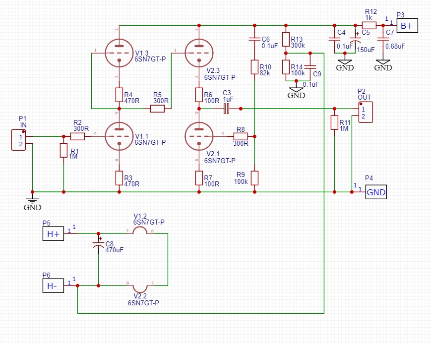

Hi Guys,
Probably a silly or obvious question, but I will ask anyway out of an abundance of caution.
Am I correct that a dam1921 can have the output taken directly from resistor ladder to feed a tube preamp without an output buffer?
Attached is the relevant preamp schematic for reference.
DAM1921 has 625 Ohm Zout and 1.3V when used single ended. Anything tube behind it is likely detrimental. It does not need gain like 99% of DACs and it has way lower output impedance than 99% of tube stages as well. So what would be the benefit of adding gain and upping output impedance? Exactly: nothing. It would add "tube magic" like higher noise and coloration (certainly with high gain circuits). One can tap oneself on the shoulder that one succeeded to add a tube again in this harsh digital world.
If one persists: with 1.3Veff one one could add a very low gain stage (or buffer). It all depends on the power amplifiers input impedance and gain. Since one can't deny the signal is already produced by "sand" one could consider an opamp stage as a buffer so practically no negative side effects and no added noise/coloration because of absurdly high gain stages. If one uses more than 1 digital or any other modern source (clearly except for old phono stages) and one uses a power/integrated amplifier with normal gain then one does not need gain in the form of a high gain preamp in the very most of cases.

Yes I do but of course it was meant as built in many cases. I see more too high gain tube DIY stuff than I like (in situations where their specifications are not suitable...). Did you see the schematic?
Poor design is poor design whether it is with tubes or without but in the case of tubes many think adding a tube circuit in whatever form makes the DAC a better device. Adding something unnecessary while at the same time degrading technical specifications never has led to improvement. With 2Veff sources a high gain preamp is a thing of the past. With DACs focus should be more on low gain, low noise, low output impedance circuits that can drive any amplifier behind it.
In other words: circuits must be designed for the purpose so with predefined calculated gain and other relevant specifications.
"Did you see the schematic?"
Several years ago I built this.
#26 tube, CCS load, capacitor coupled to S&B TVC.
Max. gain about 7.
Max. gain about 7.
Yes that is the one but with other tubes, no CCS and no TVC behind it 😀
When the circuit as attached and discussed is used after the DAC with volume control after the output it there will be "tube magic" indeed.
