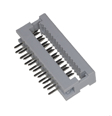

connection display board via cable
And this is my just finished dam1941, with Salas triplet too and display board (short version, w/o headphone and volume section).
Hello pecci,
thanks for showing your project, very nice build!
may I ask you regarding your realisation of the connection between DSP- and display board? which cable did you use ? do you have a parts number?
I have also the plan to connect the display board via a cable but was not able to find it at mouser, digi etc.
Many thanks and Regards
Werner
That cable and connectors are ok, but in that case you must first solder 2x10 male pins header (straight but better angled) on DSP board.
Actually on that side I use connector from attached photo, mount flat ribbon cable by press fit and solder them from underside (watch out for correct pinout)
I find them at local store and sorry haven’t any Mouser or DigiKey ref no.
Br
Be extremely cautious with the resistance of the strip cable! I also tried with a piece of cable from the drawer. It did not work, the display was half bright and all segment lit. I thougth I burnt the ICs when soldered but after many attempts of resoldering, troubleshooting I was unsuccesful. But i connected the control panel to the main board and then everything was OK. Then I decided to prepare a strip cable from individual wires with appr. 0,8mm diameter and voila it started to work properly. My distance is appr 20cm between the 2 panels.
