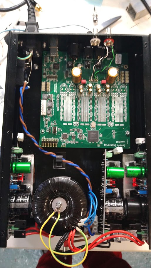

How does it work outside the case ? Check that the connector pins don't get shorted by the case, can happen if the board are mounted too low....
And check the area around U72 for shorts or bad soldering, the AES, BNC and RCA all goes though that RD422 receiver....

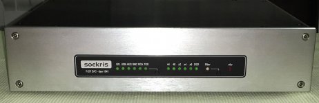

dam1941 plug-in module
I am happy to show the plug-in module, based on the eminent OEM line 1941 board.
This module is the latest in a series of various modules together forming a flexible audio system. Currently there are modules as 96/24 resolution DSP, IP- and USB recievers and an ADC. All modules work as plug-n-play to a 2-way I2S backbone bus.
All modules are housed in a standard carbon-fibre composite box which properties are strength, low-weight and RFI-resistence.
This DAC has a balanced analog output, straight from resistor network and aimed to drive a fully balanced earspeaker amp, using the re-introduced low-noise jfet LSK389 dual in the input stage. Linear Systems Reintroduces LSK389 Ultra-Low Noise N-Channel JFET | audioXpress
The 1941 board, which here replace the dam1121 board is the pinnacle of Soekris production so far.
Imgur: The magic of the Internet

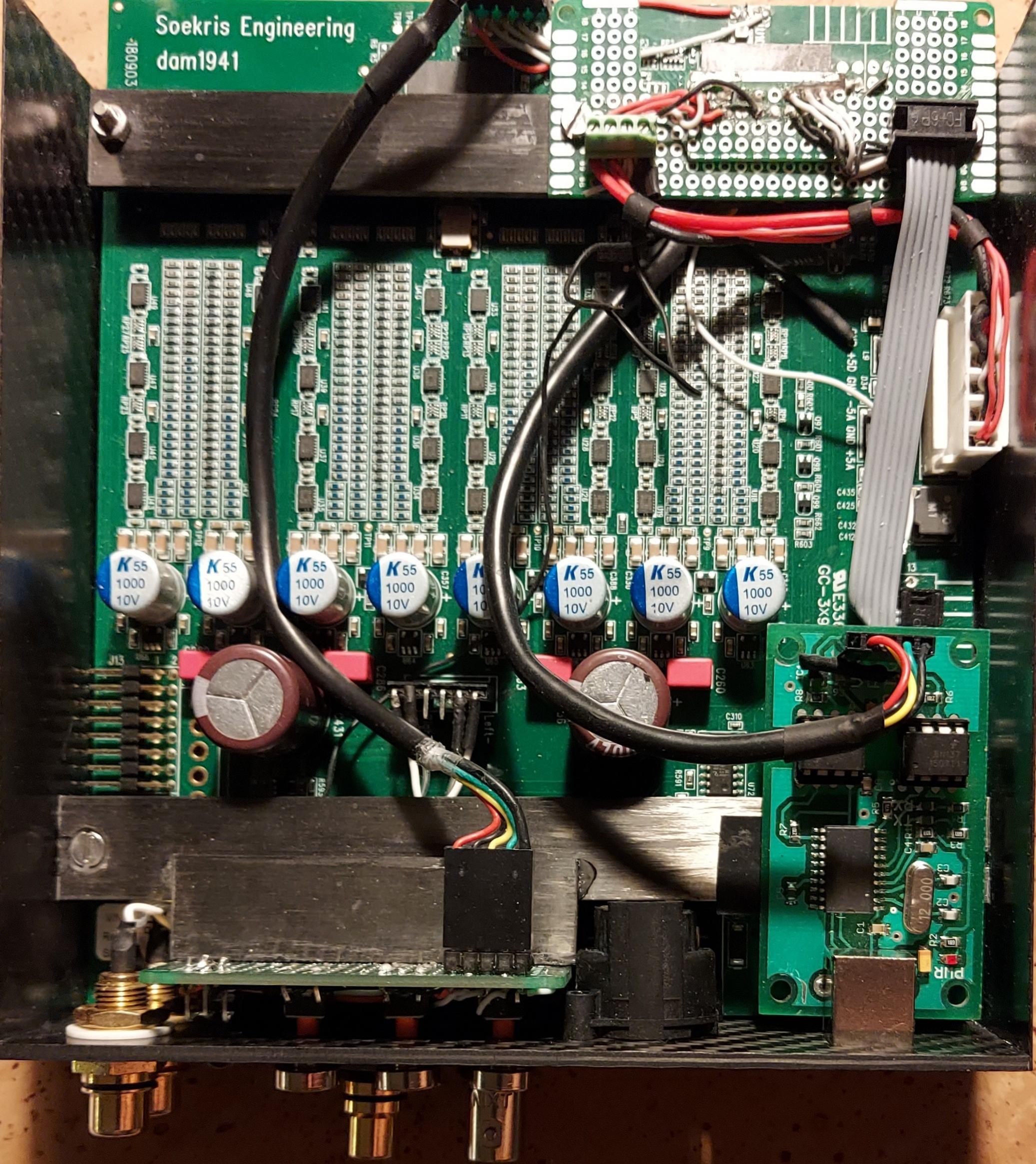

Very nicely doneA picture of my solution with Salas ultrabibs triplet. Works really fine
And this is my just finished dam1941, with Salas triplet too and display board (short version, w/o headphone and volume section).
It was pure joy to assembling all during last few weeks and I’m especially proud on my still hands and good eyes to solder tiny smd chips on dsp board.
I set parallel mode in uManager, and wired together + and – pins to use direct unbalanced outputs. I don’t like any CF, transformers, etc.. and connect dam directly to my new toy for next few weeks: dht preamp STC 3A/141A
All working perfectly from the start with nice refined and full integrated sound, from top to bottom. For sure this project is highly recommended from my side, with very good sound for money ratio. Thank you Søren, Salas, Teabag and all others from our DiyAudio community.
