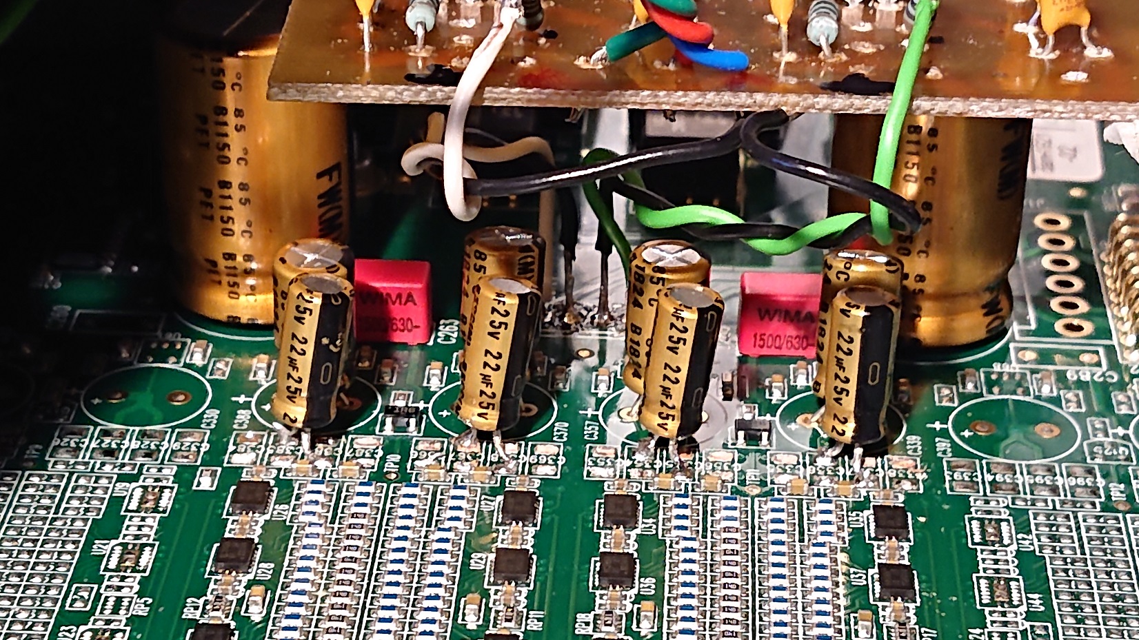

There was a previous discussion about it already, and not everybody agreed with my choices.
Just put less capacitance there and see how it works for you 😉
6.3V after regulators should be fine.
Thank you for your reply.
Luckily I have the chance to put in 47,220,470 or even 2200u BGs but I don't want to destroy my pcb by soldering/desoldering different caps again and again. I read the whole topic (others as well) and I saw the posts about the value and realized that the value itself has a positive effect on the distortion, so practically high capacitance BGs would be the best choice. This raised my question why did you choose much smaller ones? These were available or something else affected your choice? I'm really curious about your reasons if there were any apart from the availability of the caps.
Of course the decision is mine but any help is much appreciated.
There is such a thing as too much capacitance. Once exceeded the sound turns slow and compressed.

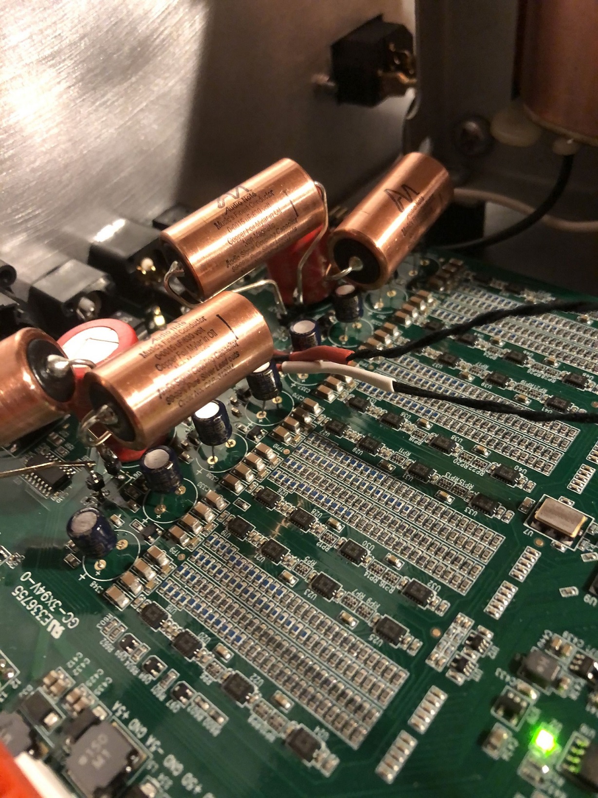

I usually install sockets and then I can swap the caps without need to solder them each time. Distortion is one thing, but I don't think it translates directly into sound signature. I'm of the opinion that the actual type and capacitance value is much more critical when it comes to sound signature. Black Gates are not perfect, but for some reason they present the signature I kinda like.
I started building amps with a lot of capacitance like everybody else. I thought the more, the better. Then Junji Kimura came up with Gaincard and surprisingly, he had only 2000uF of filtering caps in 50W amp. That was completely different approach. I found it interesting though and did my own experiments which confirmed that the amp with much less capacitance can actually sound better: more transparency, detail and speed. With high efficiency drivers it did not affect bass performance at all. I actually preferred the bass this way.
So if it worked for amp, I thought it may as well work for other stages and I started experimenting with much smaller caps in my version of TDA1543 DAC. And it worked. Since then I always use as little capacitance as possible.
As I do not have a stock of BG, I used Mundorf smooth foil (not raw) which you use for cross overs normally with 15uf. Sounds much better than was in before. I think the sound signature is more important than the actual value. Maybe Kaisei is nowadays a good choice as well... or PP.

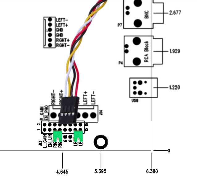

1941 parallel mode
Hi everyboby,
I see in the DAM1941 user manual :
"The dam1941 can be set for “Parallel” mode, in that case it will be single ended outputs with an
output impedance of 313 ohms"
How I do to connect my DAM1941 in parallel mode ?
Thanks for ansewering and best regards
Hi everyboby,
Hi everyboby,
As per manual, in uManager do a "set mode=parallel". Then parallel the two resistors string per channel, ie, short the + and - outputs....
That function was added after the first release, so it's not documented very good. It was discussed earlier on in this thread.
Will shorten the pin 5-7 and pin 13-15 with a jumper and then use the pin 8-10-12-14 like in the picture works too?
