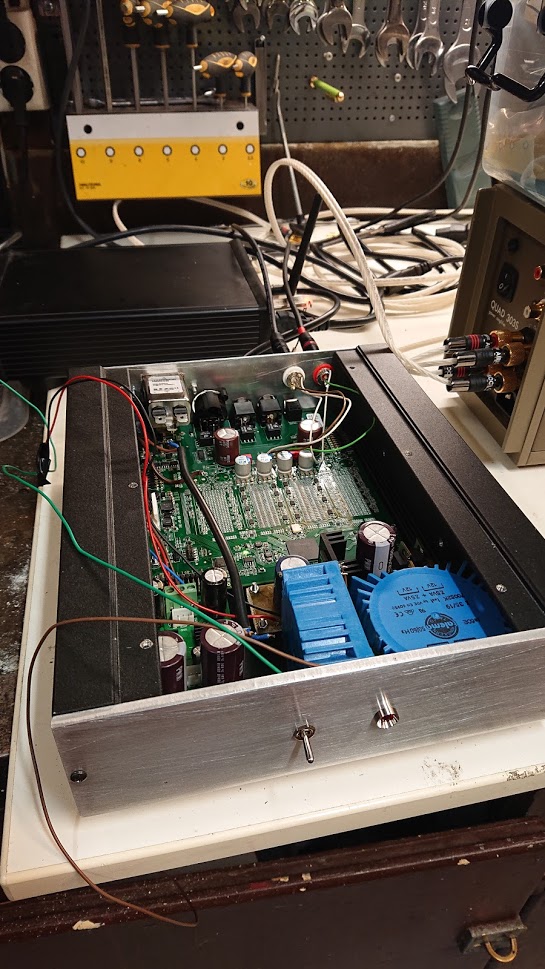

Twist the + and - cables for outputs?
I will, its just a test run at the moment.🙂

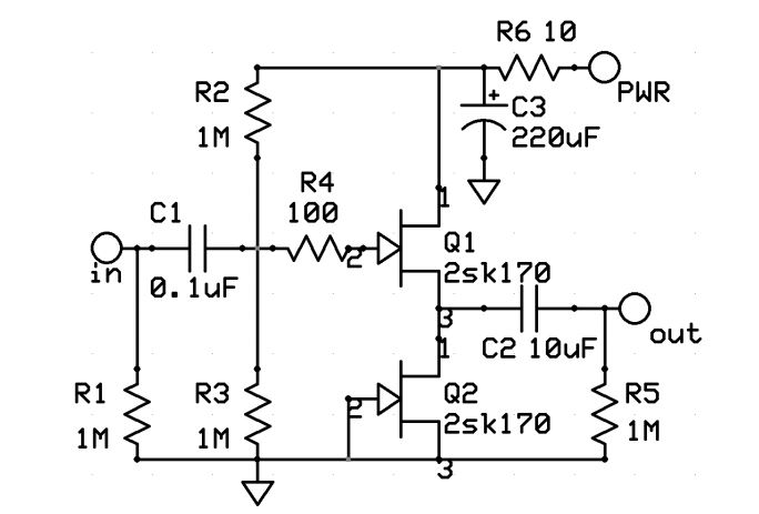

I will try to set a LePacific buffer stage after "raw" to be able to connect to different sources. Have had good result with it earlier and think it would be nice implemented.
Well...why add two coupling caps into your chain to achieve what ? The 1941 has already 620/310 ohm output impedance only....which should actually drive anything I could imagine...
Why not just add one of those H2 generators Pass gives away as presents? 😀
Okay. I see you have your thougts but I will have a try anyway. Could be as simple as an tube amp can sound better or a transformers sound better... Have nothing to do with measurements or calculation. Just what please your ear. Could skip the first cap sins there is no DC i assume..
