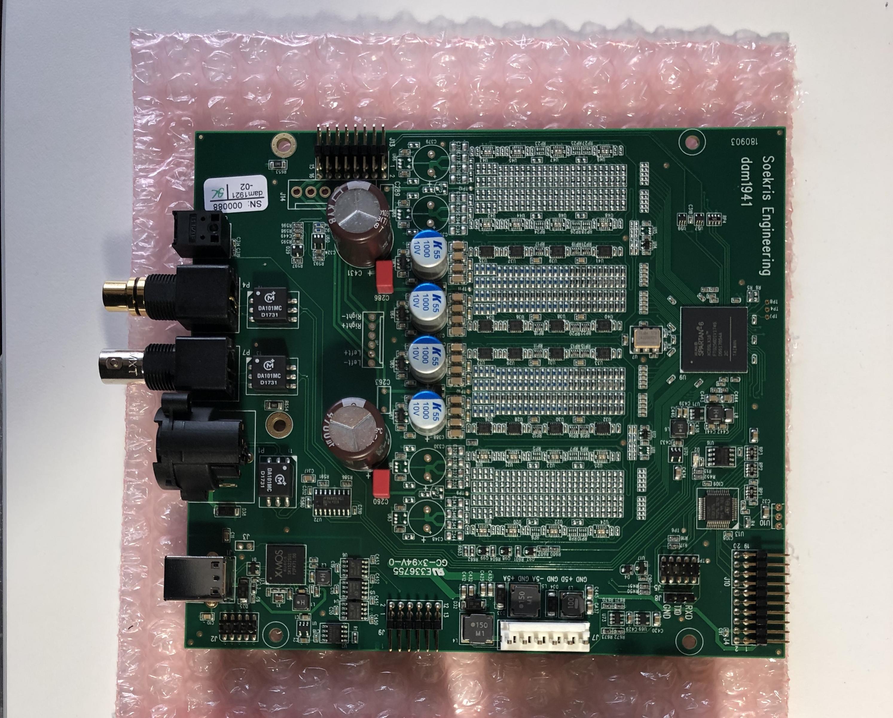

Sören,
Is the red capacitors C260 placed correctly?
It looks strange as it is connected to the ladder that is not in use.
Hmm, that's right, there should be no capacitor at C260. but it should be at C263.... The stock I have here is correct, so probably just a single mistake that got though.... I assume you can move it yourself ?
