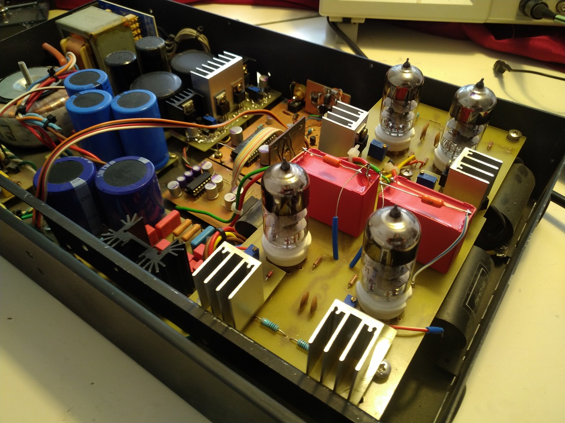

This year I had a bit refreshed my old DAC, I / V conversion was changed from passive to ground grid, tubes are the same 6S4P, all CCS now have double FET instead of lower DN2540 in cascade and for all digital circuits except for PCM1702 voltage regulators are now ADP7118. High voltage power is a copy of the power supply from ARC LS25MKII.
Otherwise DAC is an old school CS8414-PMD100-2xPCM1702.

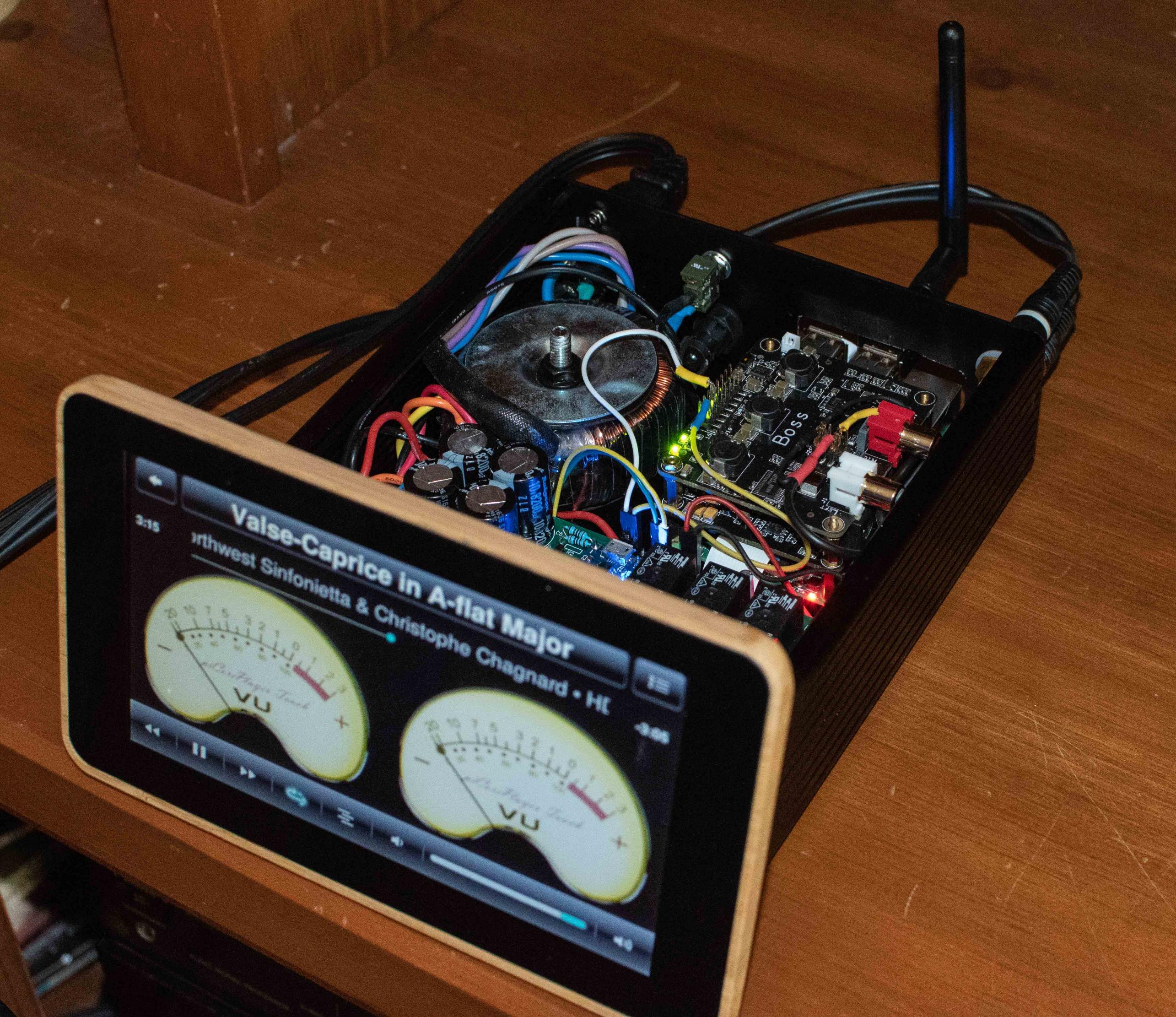

My piCorePlayer (Allo based)
I put together a piCorePlayer using a Hammond chassis. It has an official Raspberry Pi touchscreen and uses an Allo isolator between the Pi and the Allo Boss DAC. It also has LiPo batteries to power the isolator and DAC. The small board in the middle is a custom board I designed to host the +5 volt linear regulated supply and a charging circuit for the LiPos.
The display controller is underneath the batteries and is flopped down to a horizontal mounting position.
When the player is quiescent, the batteries are placed in parallel for charging and when active, in series for powering the isolator and DAC. The switching is done by 3 relays controlled by a GPIO pin on the Pi. When powering the DAC, the batteries are completely floating and therefore the DAC is galvanically isolated from the Pi power supply and ground.
The setup is currently running piCorePlayer 3.5 and LMS. It is driving a passive preamp which is connected to a McCormack DNA 0.5 and Martin Logan Aerius i's. It sounds very clean, particularly playing 24-bit FLACs and is dead silent between tracks. Having played with various DAC setups, I'm pretty happy with the battery solution.

I like what you did with the Vu-Meters 😎 I would like to see a video on how smooth the actually work? I have those on my Aurender and is sooo jerky, the might as well have left it away…. 🙁

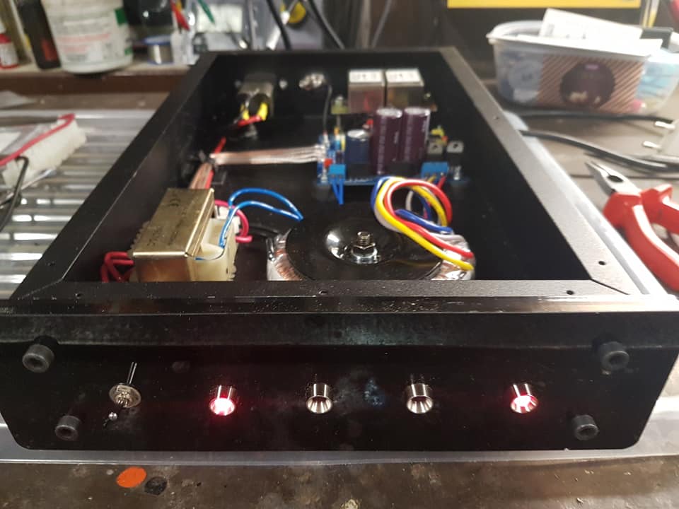

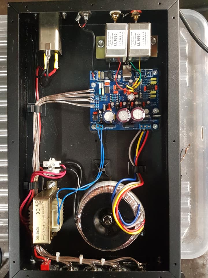

CS4398DAC
I ordered an CS4398DAC card from China. Replaced to good quality parts in Powersupply stage. Audio grade capacitors and plenty of power. I wanted to replase the output op-amp stage with transformer stage. Replaced with Lundahl 1690 1:1 transformer. Im really happy with the result and fits my tube rigg really well. Really better sound than my Rega DAC.
You really did it your way and it's great that you've been rewarded.
Quality parts not only worth soundwise but will also extend the longevity of your dac, nice move.

I've been publishing in Croatian audio forums for a long time.
This version is far more advanced than the ones from that time, but I did not publish any scheme or project. This would be a new output stage. It was designed for current DAC.
