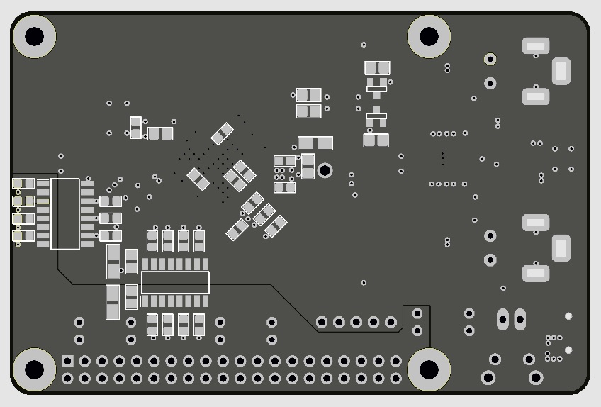

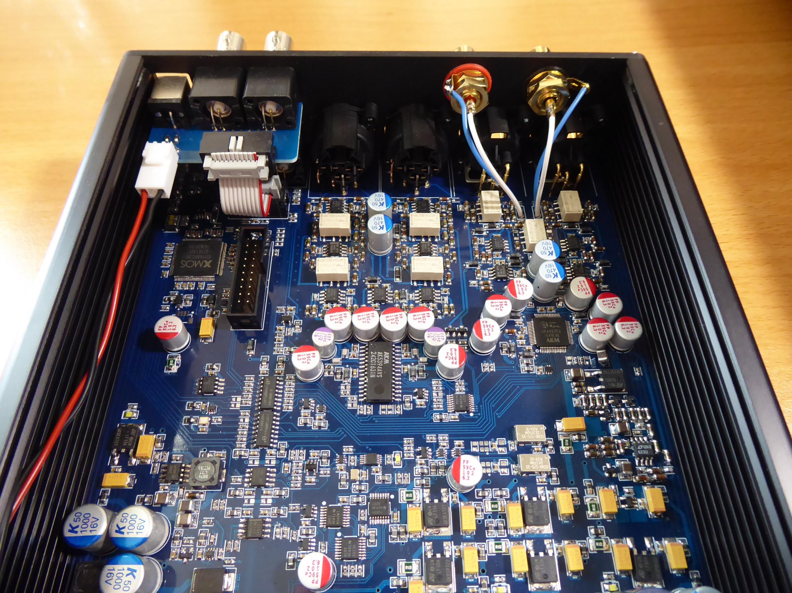

PCBs for first prototype are ready to be ordered.
Since I have no any experience with CPLD based DACs, it will be a simple SLAVE one, for learning purpose, but for the final design, it will be a MASTER version, I hope. (CPLD will send 45/49 MCLKs and BCLKs to RPi)
Nice! looking forward to see further progress!

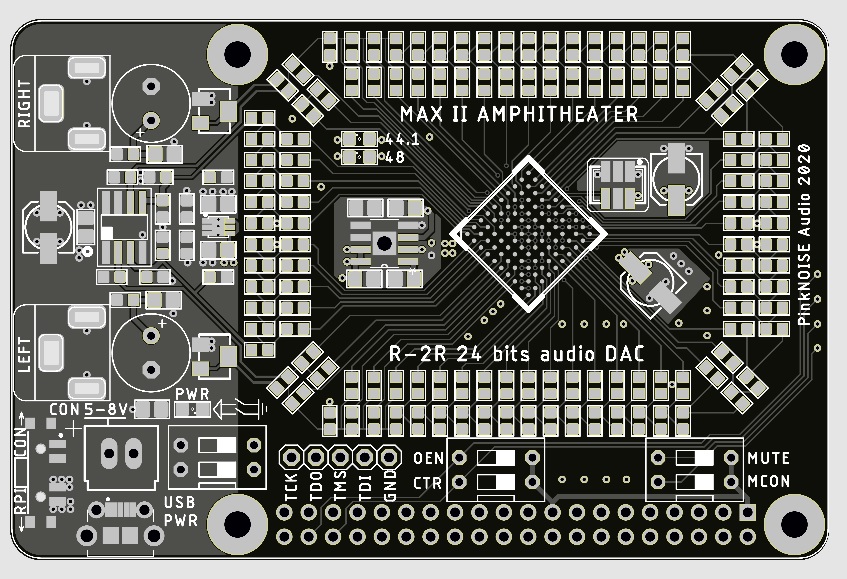

First test: it realy sounds amazing.
This is the DAC with the worst THD I've ever built, at least in theory. My newer RPi didn't arrived yet, but the old one is good enough for testing.🙂
On the PCB there is one technical issue: the low noise power supply for opamp is missing ADP7118, because I ordered the wrong package!!!, so you will see a short wire in that area. Opamp is low noise, low enough THD, ISL28291, but for the moment it is powered directly from main 5V power supply.
I am sorry for the video quality, it is a preview only.
For me, there are 3 premieres: first R-2R DAC, first CPLD project and first BGA package soldered.

Nice work. Next steps, reclocking the digital signals ?

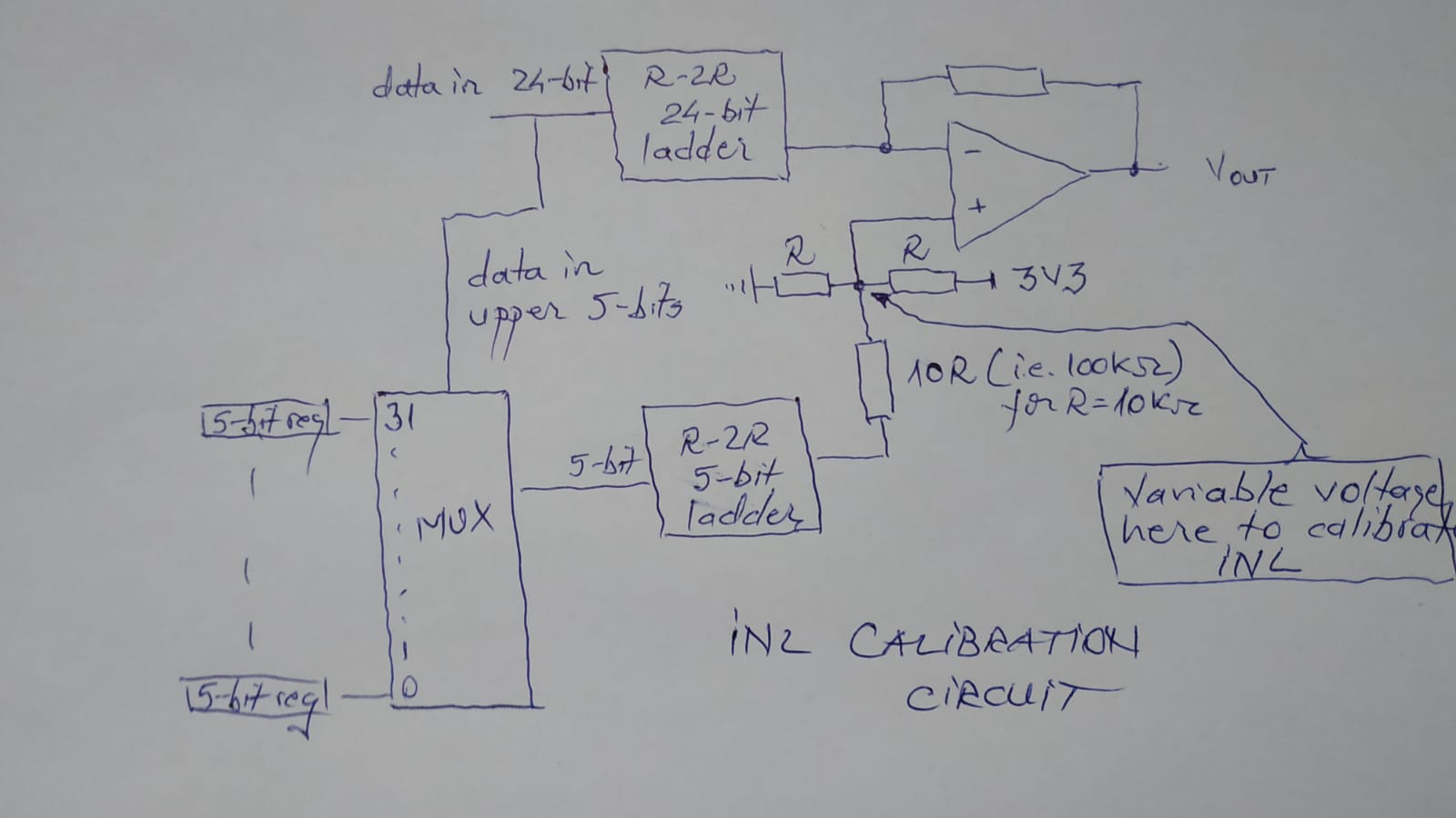

The board says 24 bit. Did you do a linearity test ?
Thank you. Yes, I have planed to make the master version (RPi slave) of this DAC. I will use the same PCB, with some modification for signal isolator.
It is funny, because I thought initially that I have to reverse it 180 degrees only, but after a ordered PCB, I realised that even if data pins are simetrical, VCC and GND pins of the IC are not!!!🙂
Next-next step is FPGA based project, to deal also with DSD(dop) signals from RPi
Not yet. Actually both (left + right) 5-bit R-2R ladders for INL calibration are inactive at this moment. I will use variable voltage on opamp non-inverting input to deal with INL. See please the picture below.

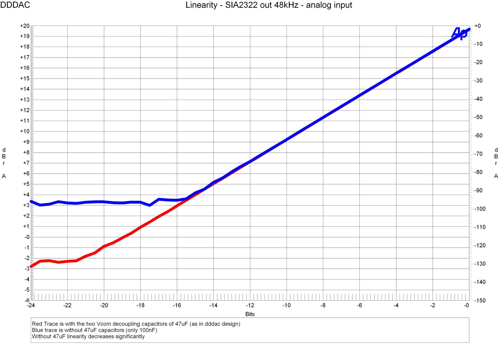

Thorp, not sure if you have the equipment to do a linearity test up to 24 bits, but if you want I can run that for you on my Audio Precision equipment.
for example, below is the linearity of the DDDAC 1794 - as you will see it is almost impossible to reach true 24 bit linearity 🙄
This was actually a test I ran as some one mentioned the Vcom decoupling on the PCM1794 was not necessary. I proved him wrong as you can see ...
Of course R2R dacs with non-laser trimmed resistors for LSBs and wanting to do 24 bit is quit a challenge, so checking this is a MUST so you know if you reached your design goals
any way up to you !
any way up to you !
Thank you @dddac for your feedback.
Now I see your point: of course it is not a trully 24 bit dac! When I named that, I reffered to the "size" of R-2R ladder.
This is a learning project, actually my goal is to (start) learn about FPGAs & CPLDs. I don't even have a modern RPi (but it will arrive today, the courier just called me 🙂 )
It is just a hobby and, yes, you are right, I don't have any expensive equipment, but I wish to! 🙂
On the other side, I am on your side: I also want to reach the best possible version of something I work to. Even if I believe that no one can hear any difference between "with 47uF" and "without 47uF", I still woluld do as you did! Perception can be subjective, but the numbers (math) don't lie, actually they are our common language.

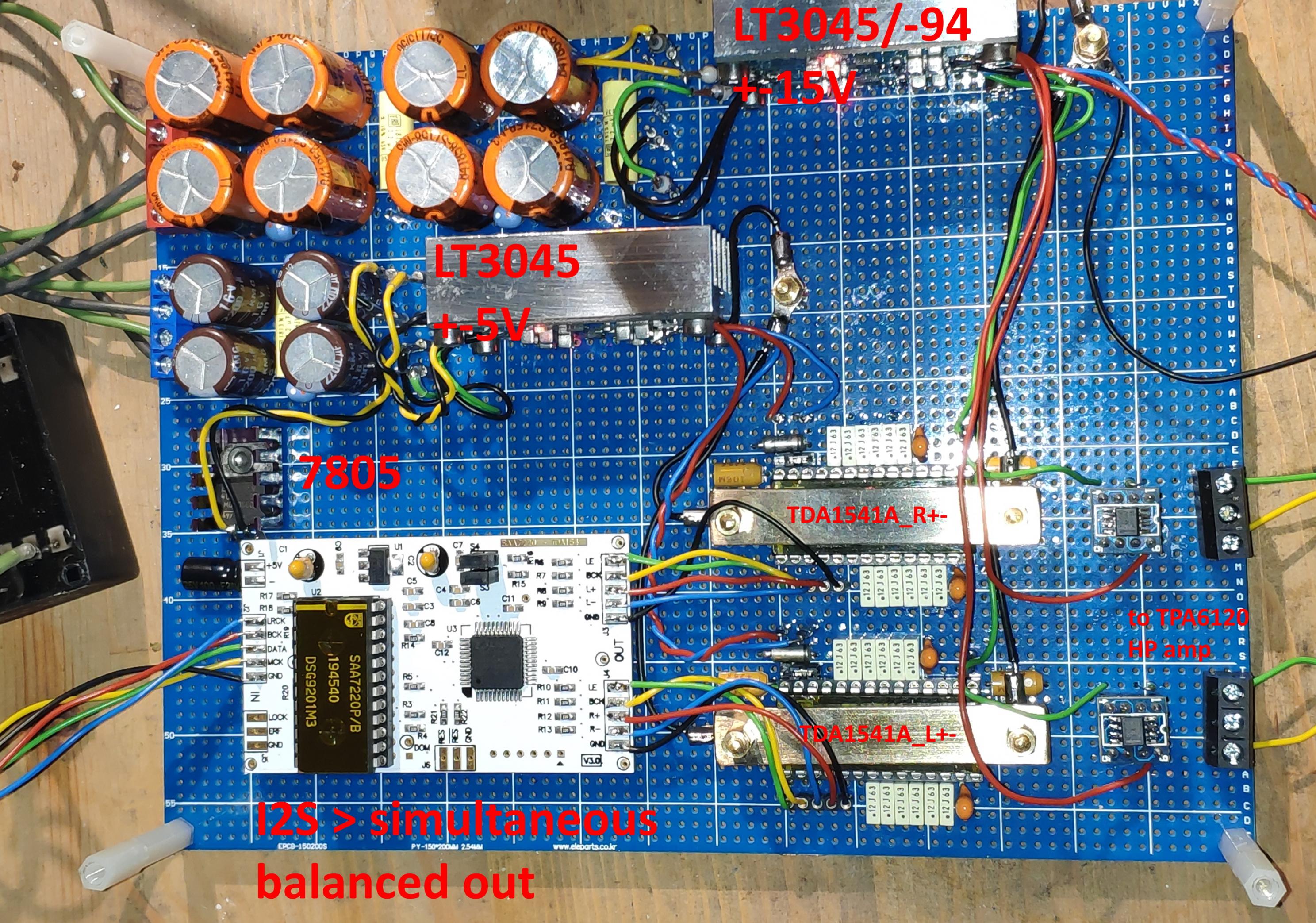

balanced TDA1541
A straight-forward balanced TDA1541 testbed to confirm the AliXpress I2S to simultaneous board (the white pcb) really works.
It's not finished yet (who wonders?), the analog output stage is just a quick'n dirty OPA1656 active I/V followed by a cheap TPA6120 headphone amp.
I'll switching to a passive R tube amplified setup later.
On my try-out list are the Broskie "unbalancer" and the Tubeclinic 6N16B preamp.
