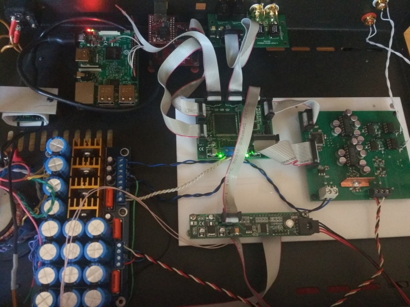

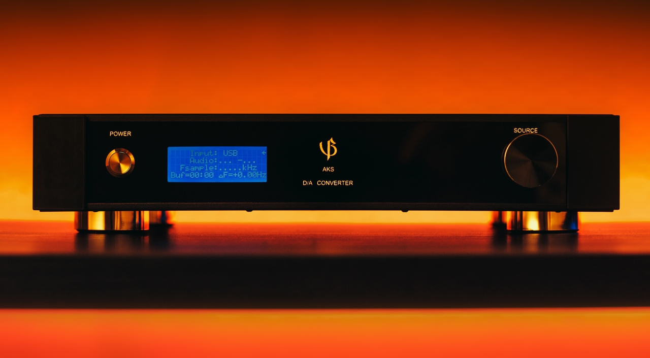

Finally I finished my DIY DAC project
2 SPDIF, 2 optic, USB (xmos), Raspberry pi3 > FIFO > sm5847 > PCM1702 > Nazar out

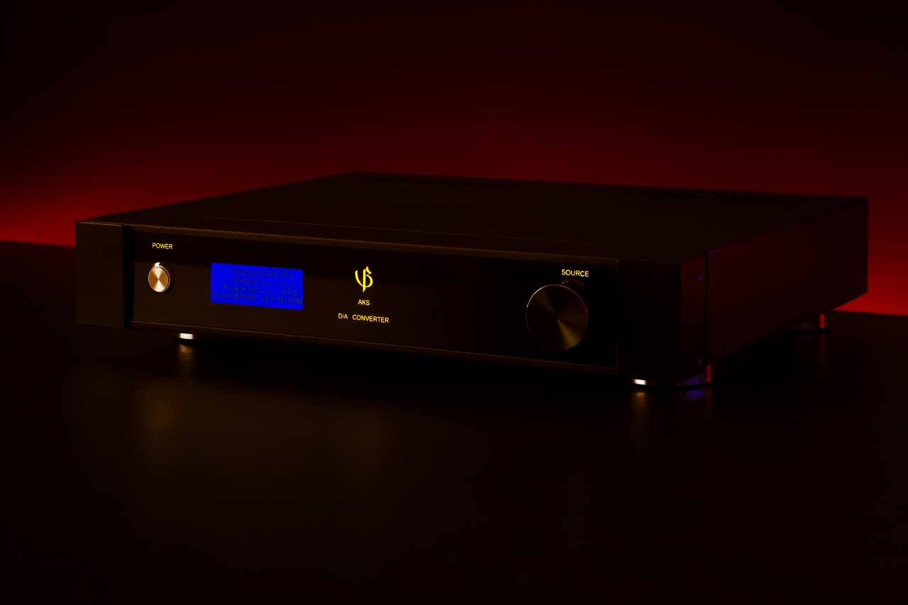

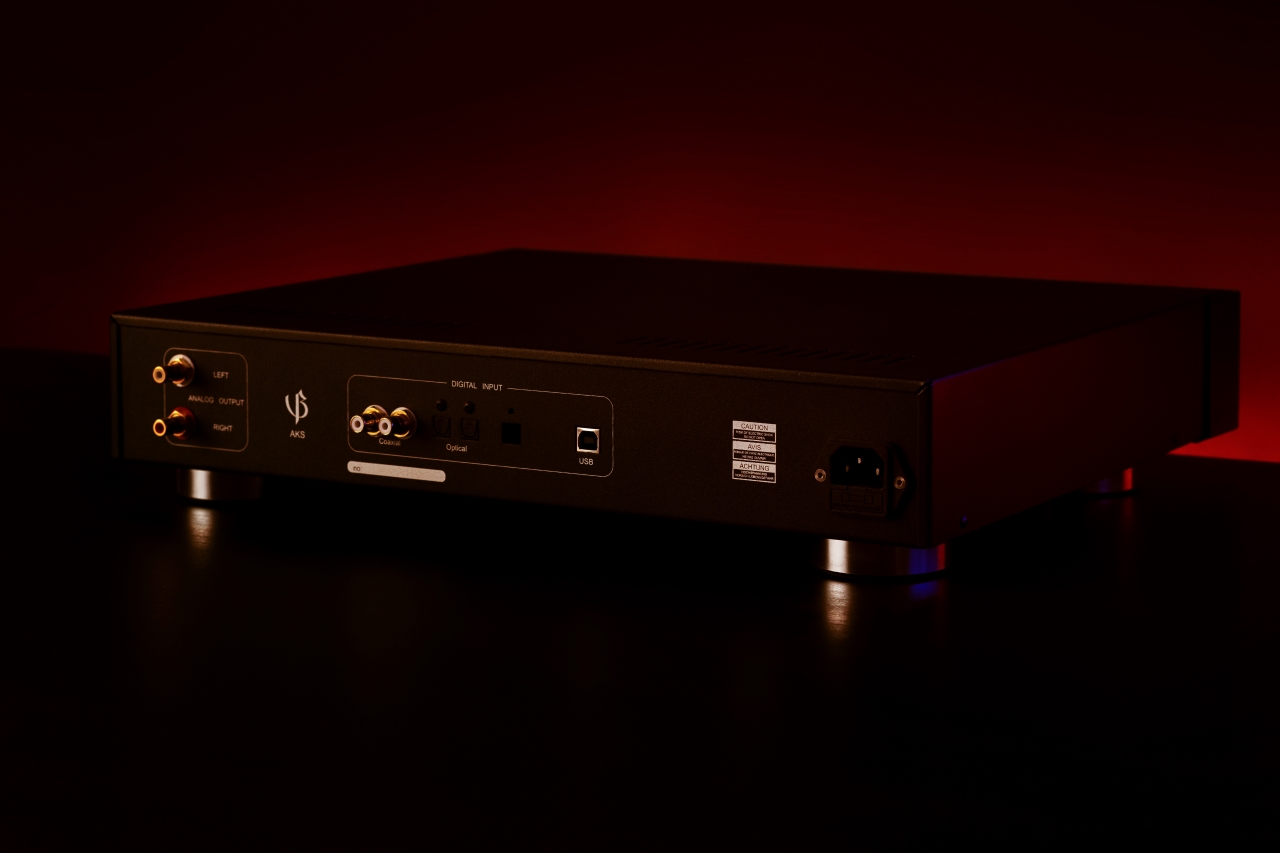

This is my favorite dac, LemonDAC.
Wolfson WM8805 receiver, Sabre9023P DAC, Atmega1284p Controller.
Salas pre-regulator, 8 super low noise dc-dc converters (LT3042, TPS7A4700x)
Individual PSU for controller, display and usb receiver.
The engraving of the case has be made on a diy CNC.
Outside view of the dac: LemonDac - YouTube
Inside view of the dac: YouTube

Hi Percival007,

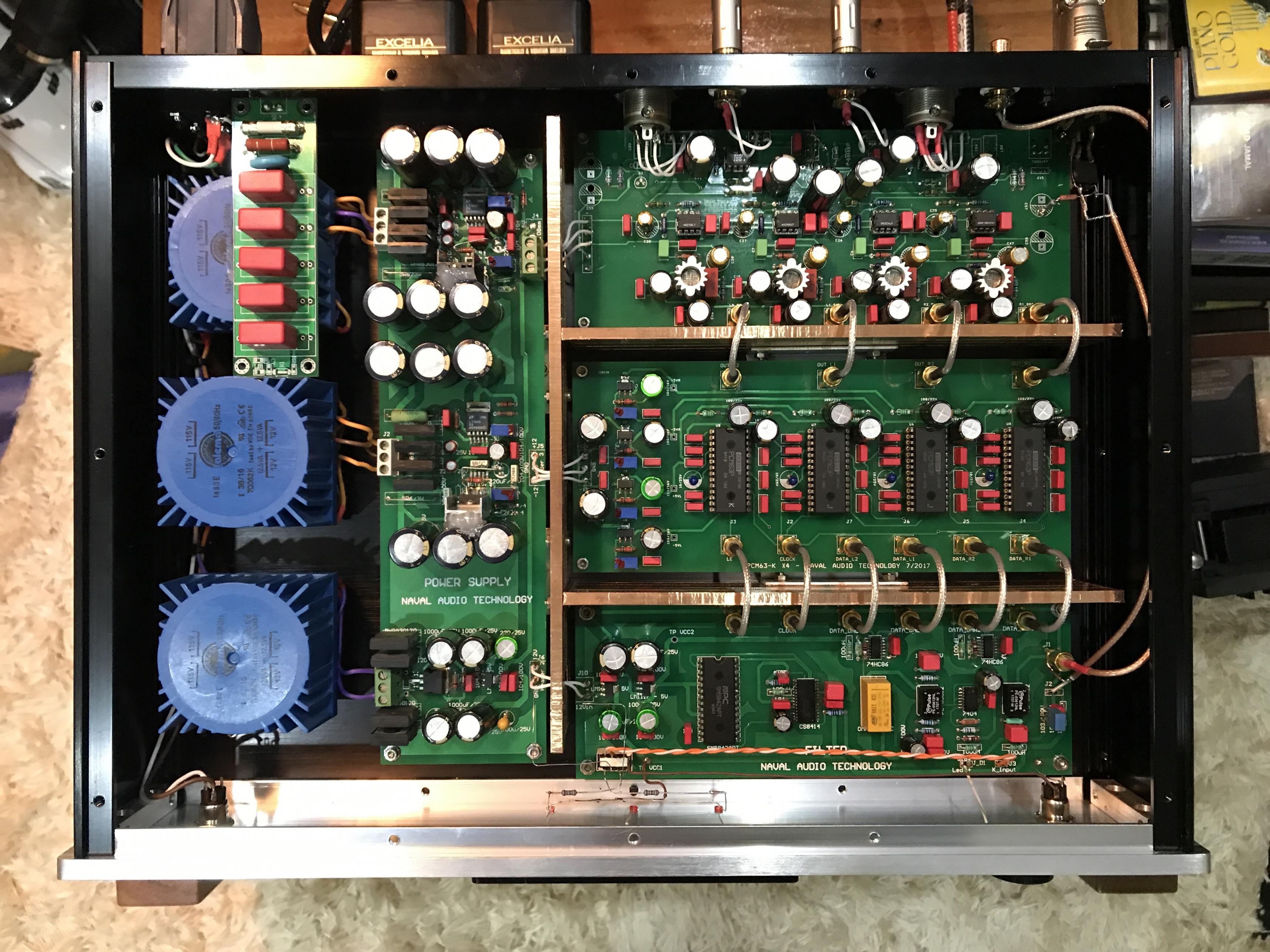

The case from China (~25$)
And I did internal separation of the plastic (10mm) and the copper tape.
It's good for unti-noise.
Cheer,

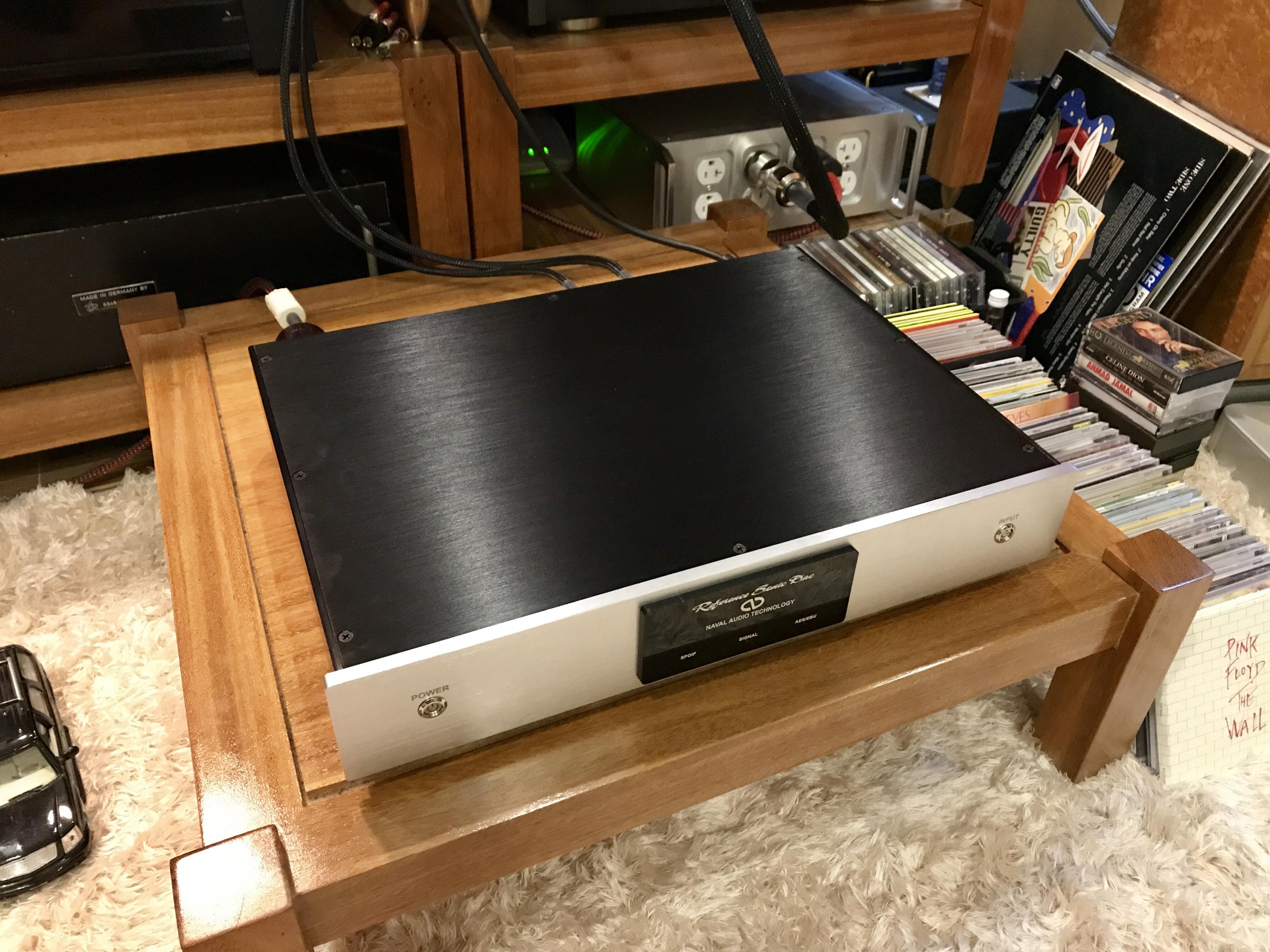

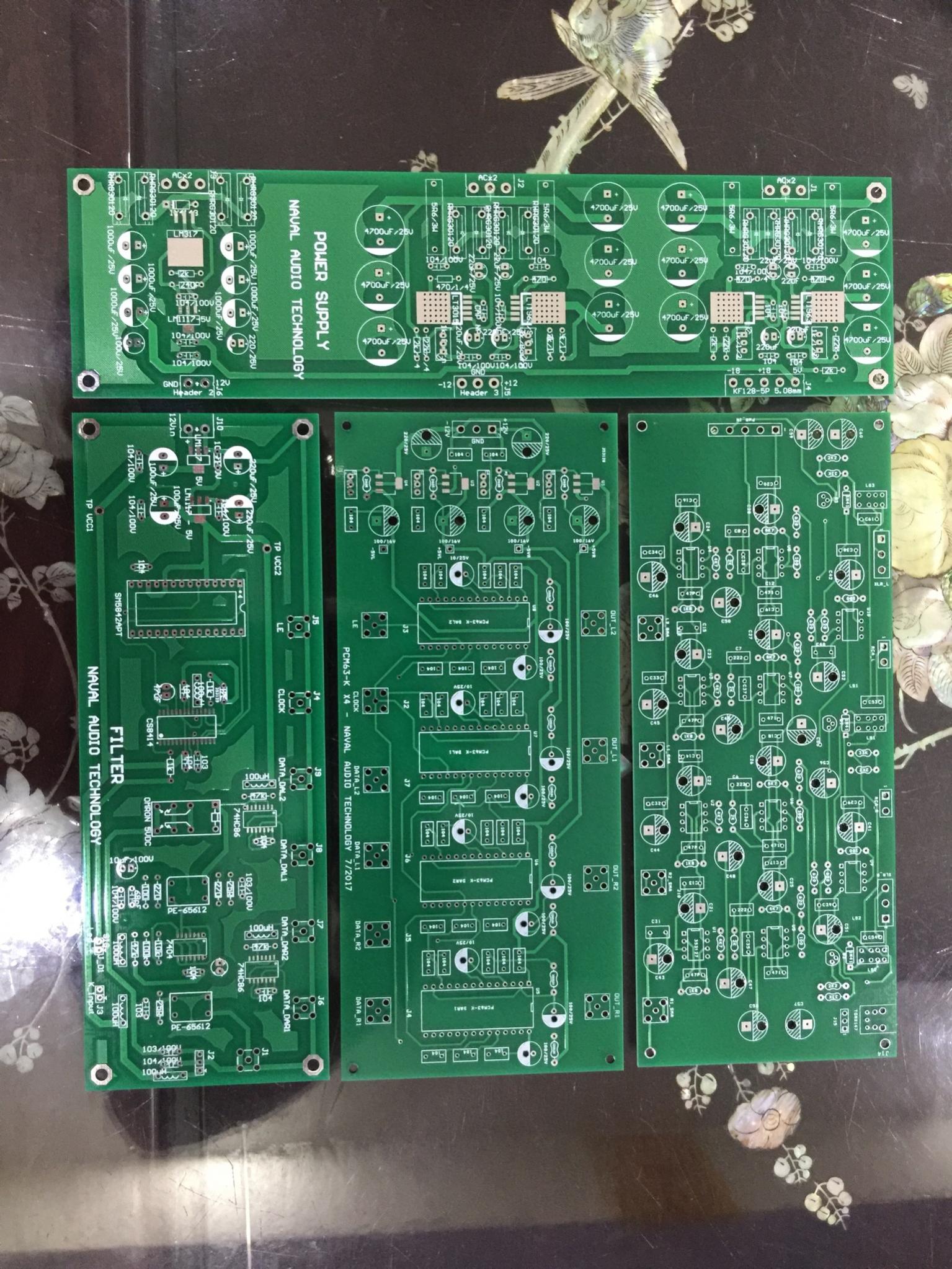

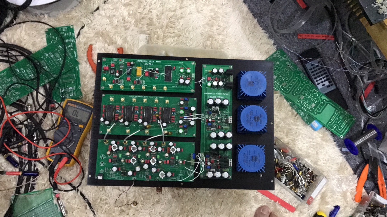

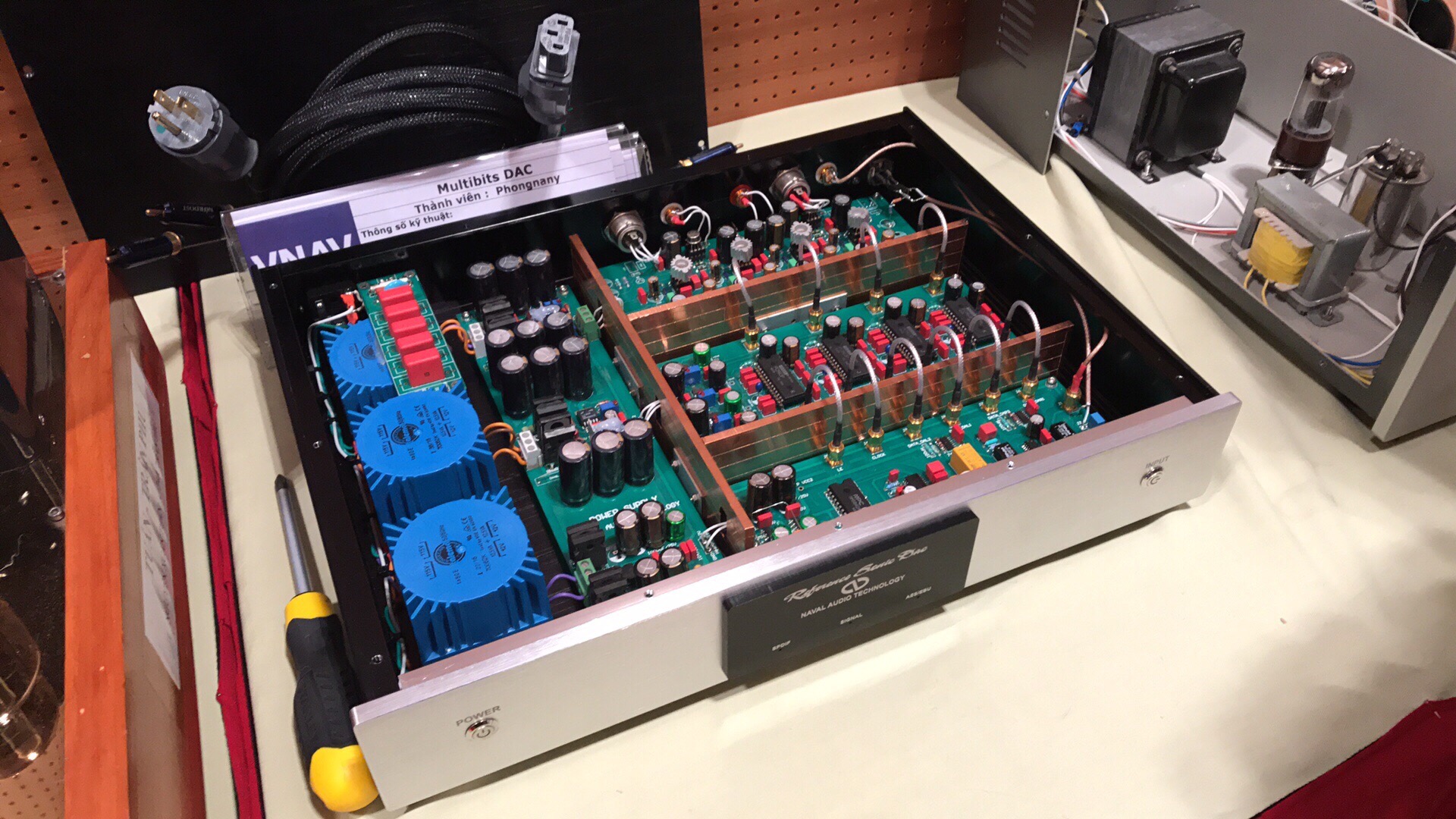

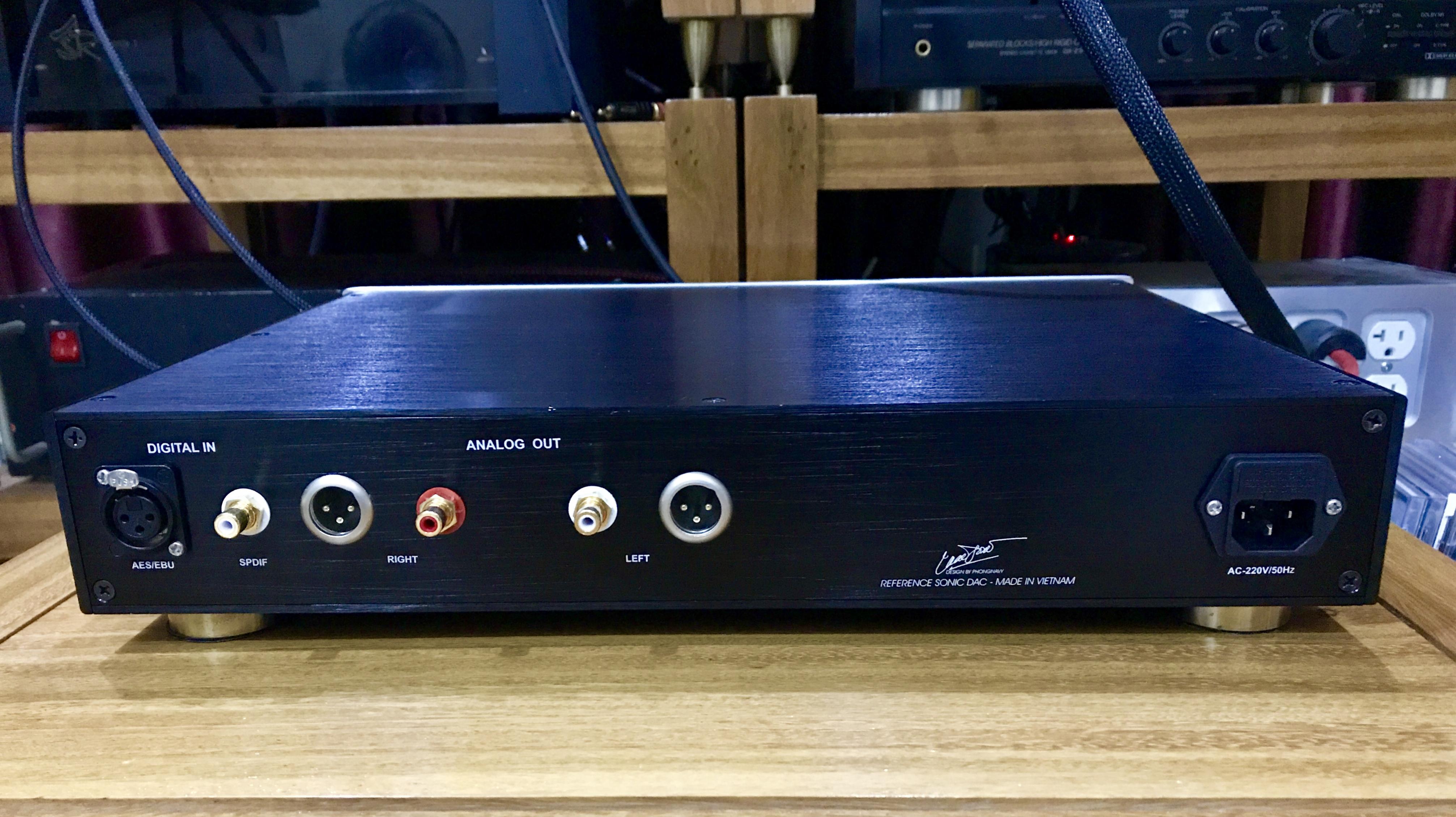

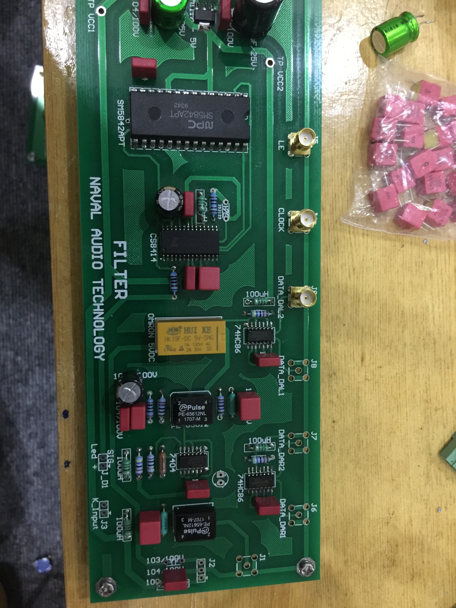

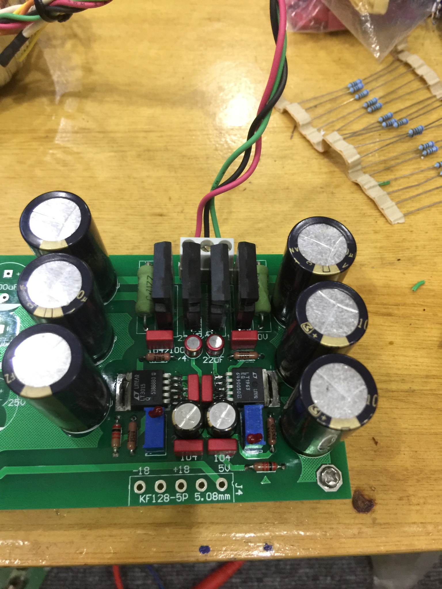

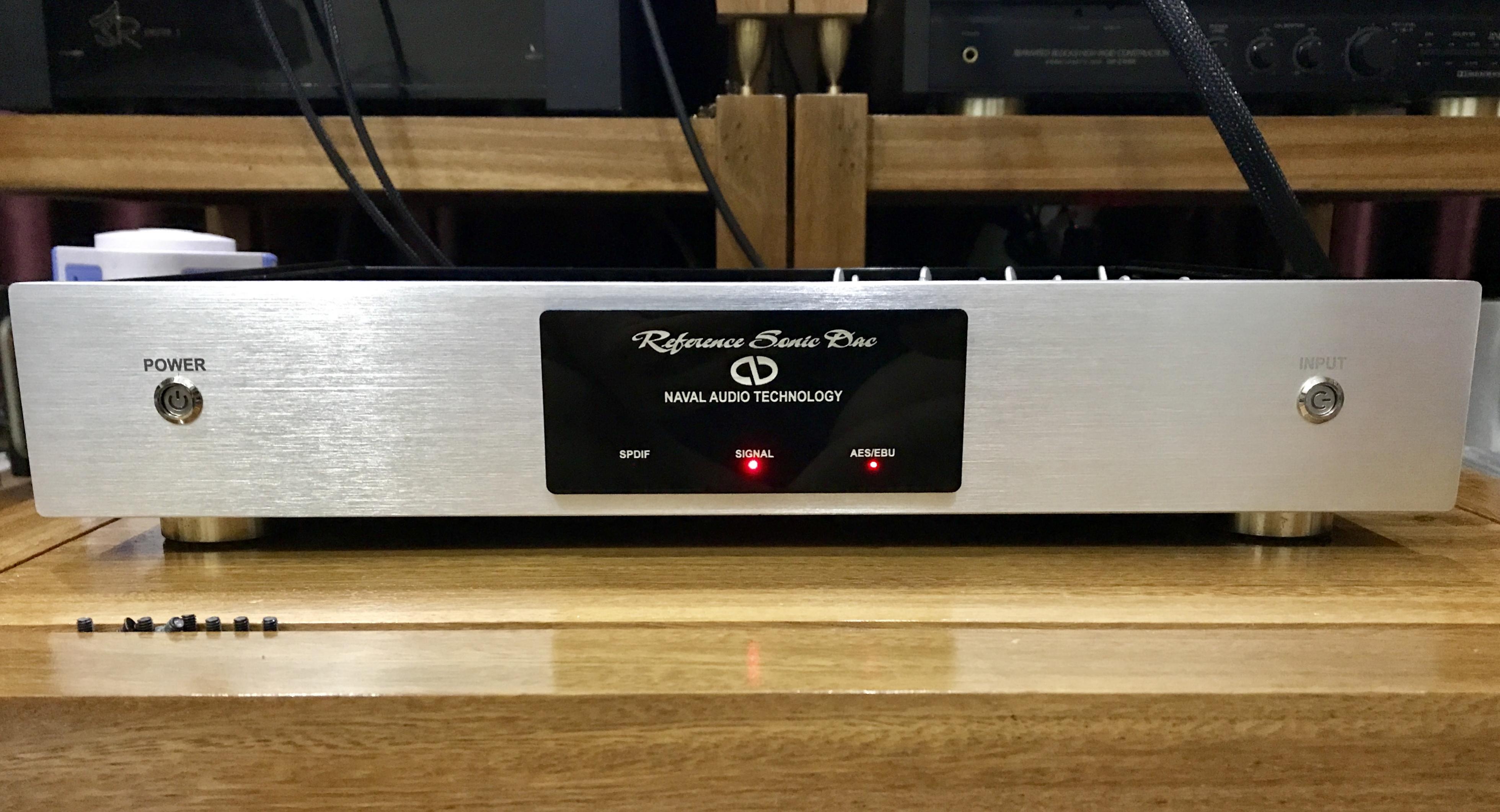

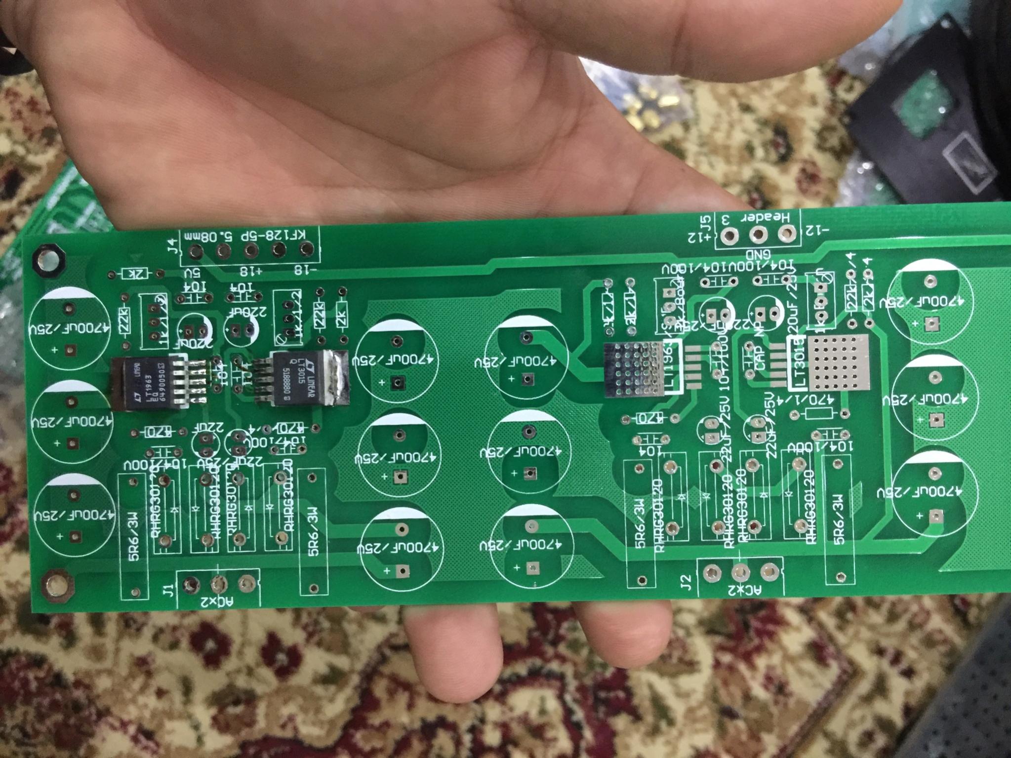

My DAC specifications:
1. Pwr supply: LT1963-3015, LM317 and LT1117-5
2. Digtal in, sampling, clk: 74HC00, 74HC86, CS8414, SM5842
3. D/A: 4xPCM63-K
4. I/V, Buffer: 10xNE5534 or equivalent
Number 2 board, 3 board and 4 board conneted by SMA connector and cables

Ok ddac, Thank you for your interest!
3. D/A: 4xPCM63-K
That's a sweet setup. I thought those were SMA, just wasn't 100% sure from the photos. I would have never thought of using those. I actually use those in a couple of field monitoring devices I have created for clients. Used the IP67 bulkheads which looked bigger than what you used.
