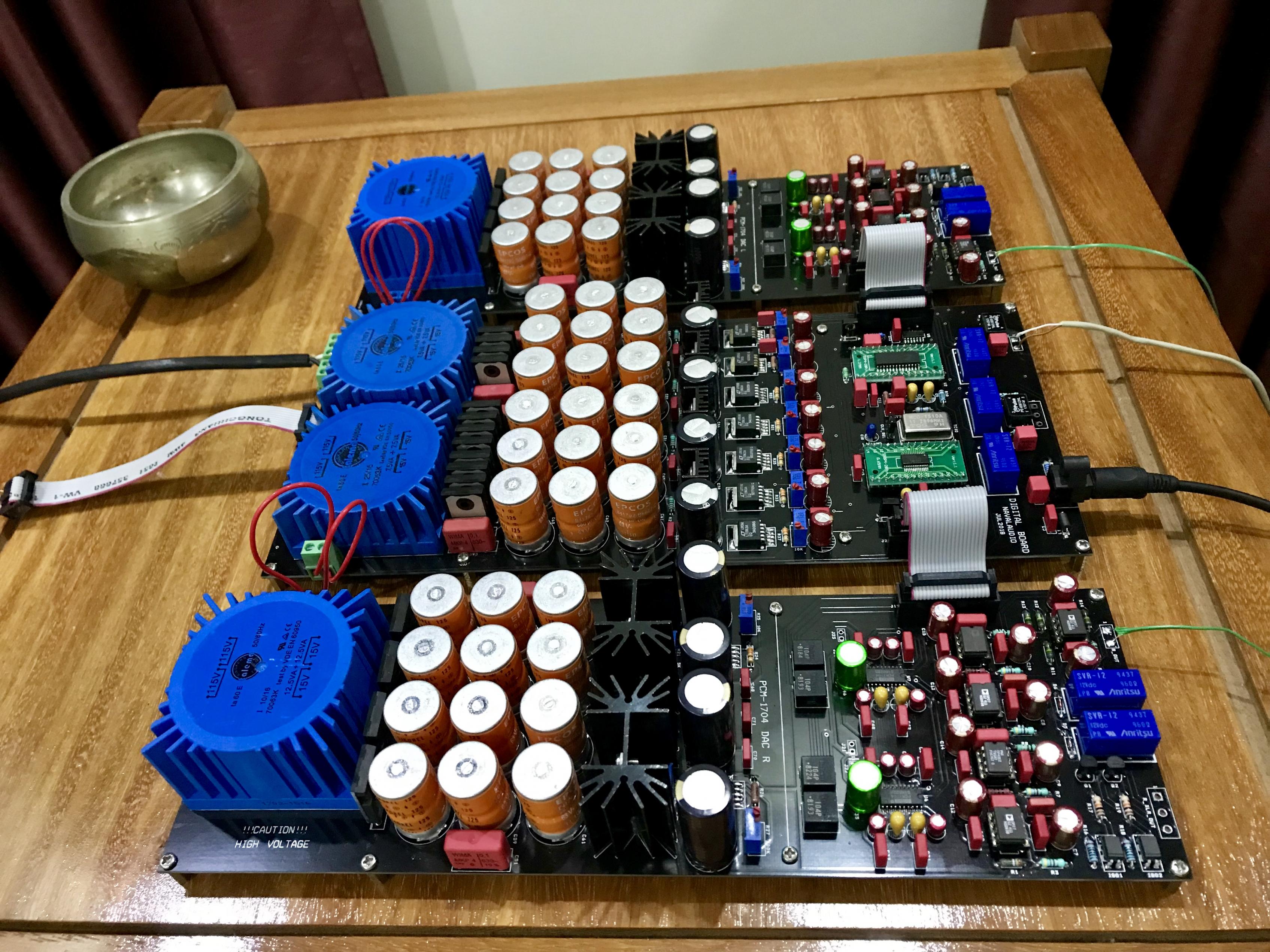

If you ever redesign the DAC to have I2S/USB input, I would love to have a board set. Always fancy in old-time NOS DAC. 🙂
It would love neater if you make the PSU board bigger to fit those 3 Talema transformers onboard.
Tks, maybe coming soon.If you ever redesign the DAC to have I2S/USB input, I would love to have a board set. Always fancy in old-time NOS DAC. 🙂
and I Always fancy in old-time NOS DAC, too

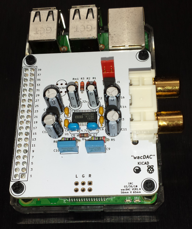

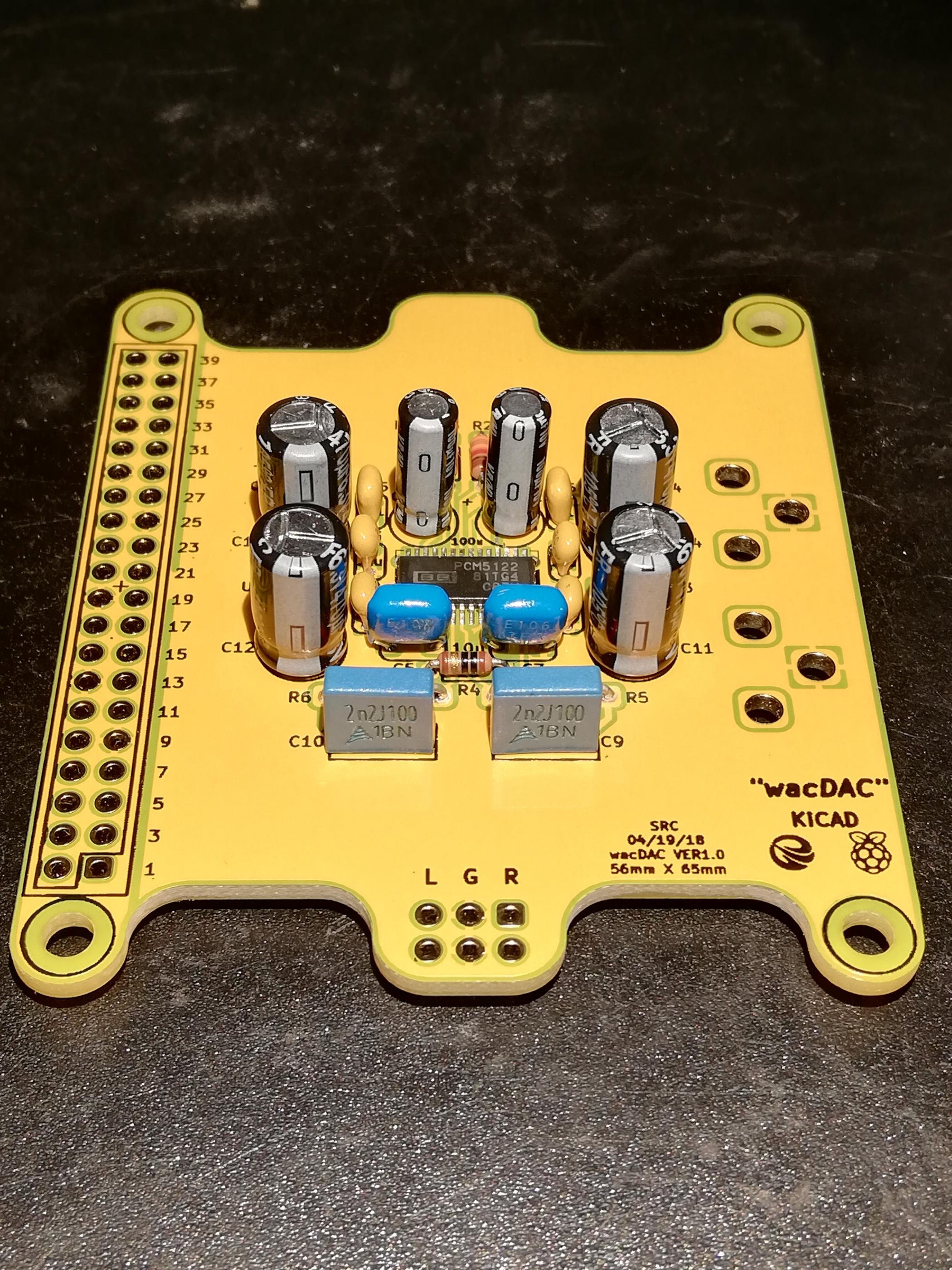

Second go at my DIY DAC
Low temp solder paste is your friend!
Some extra PCBs if anyone is interested
PCM 5122 based
Cheers
Nice work!

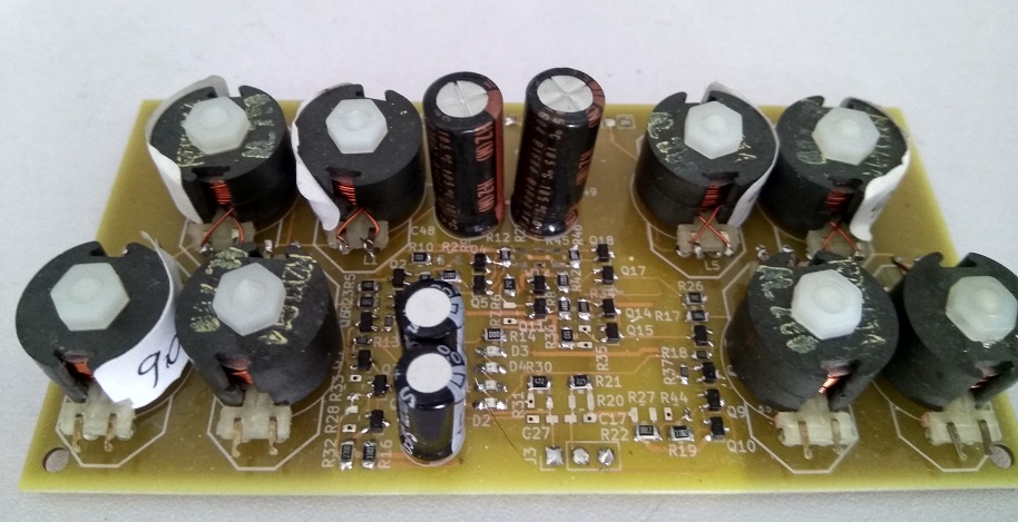

Hey folks, I've decided to post photos of several D/A converters of mine here. I hope you will enjoy it 😉
First of all, moving-average 32x AD1865 DAC with no digital filter whatsoever (linear interpolation in hardware thanks to moving-average idea):
Another one is with one AD1864/AD1865 and an ASRC (AD1896) acting as digital filter upsampling to 210,9375 kHz. The analog filter is 10th order FDNR (frequency dependend negative resistor - Frequency dependent negative resistor - Wikipedia):
Several spinoffs were made of this idea resulting in discrette I/V stage with an active correction of input impedance with AD1864/AD1865, PCM1704 and TDA1541A:
THD of that D/A converter was well beyond three zeros after the dot:
PCM1704:
TDA1541A with low noise current source to create a bipolar output from it:

But you have not said what they sound like!
Which do you prefer and why, compared to the others?
All of them do sound different and it is hard to pick one up since it all depends on your whole system, but if I had to choose one for mine I would go for moving-average with 32x AD1865. In fact, that is the one playing right now, however, the one with 1x AD1865 is quite good as well.
In general I do appreciate the sound from all of them, however, there is one which I didn't like much and that was PCM1704. I don't know what is about that chip, but I just don't like the way it sounds - it's not bad, but definitely worse than the others.
Lots of hours spent in PCB layout there, kudos.
I see you have some fairly complex active filters after your DAC, based on opamps. Have you tried LC (passive) filters? I ask because I tried a complex opamp-based elliptic filter after my DAC and didn't like the sound much. These days I only use passive filters - attached prototype 9th order LC filter I/V stage.
It's frequency dependent negative resistance and those opamps are not in the path of an audio signal. Take a look:

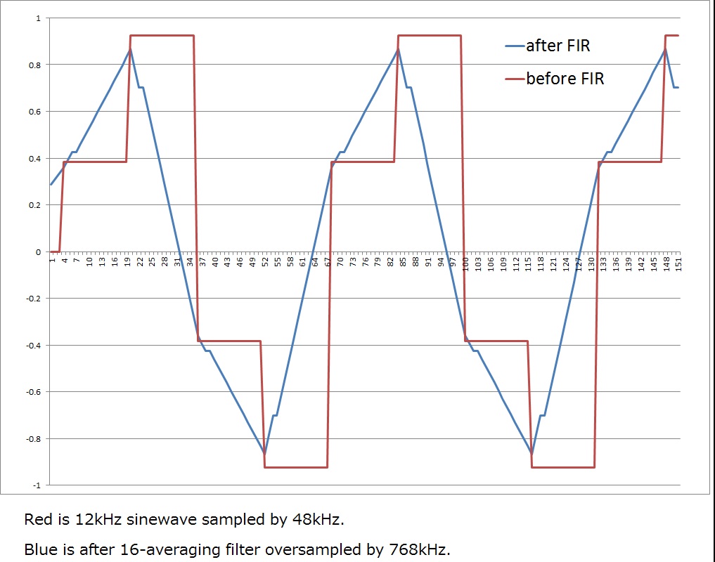

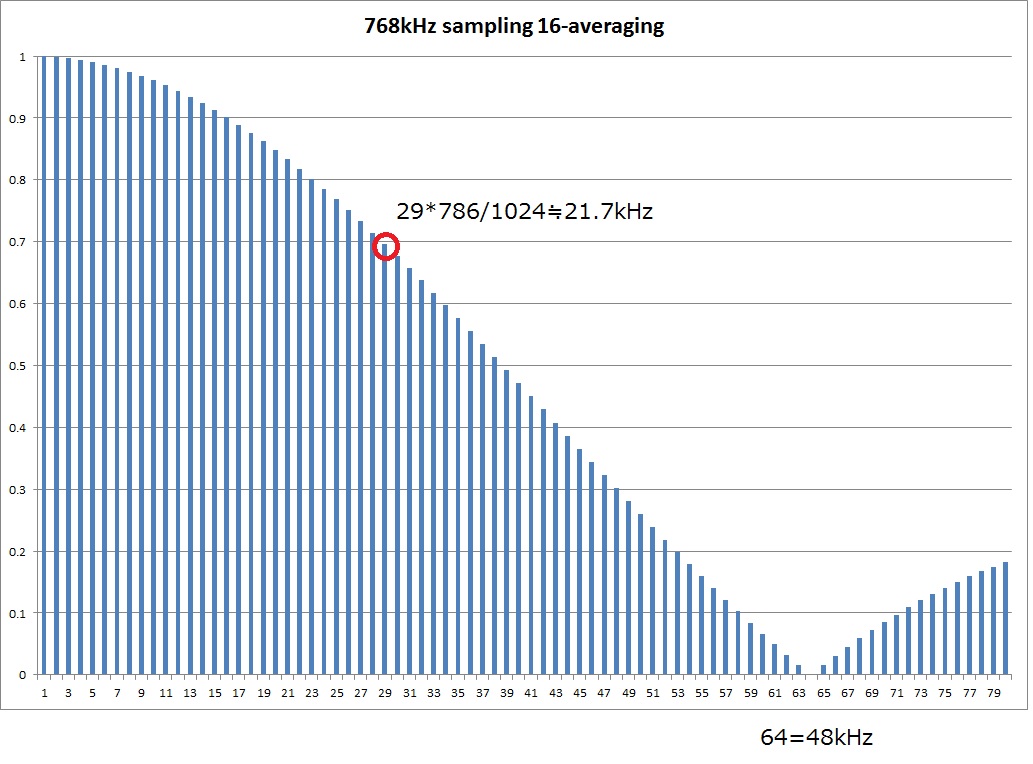

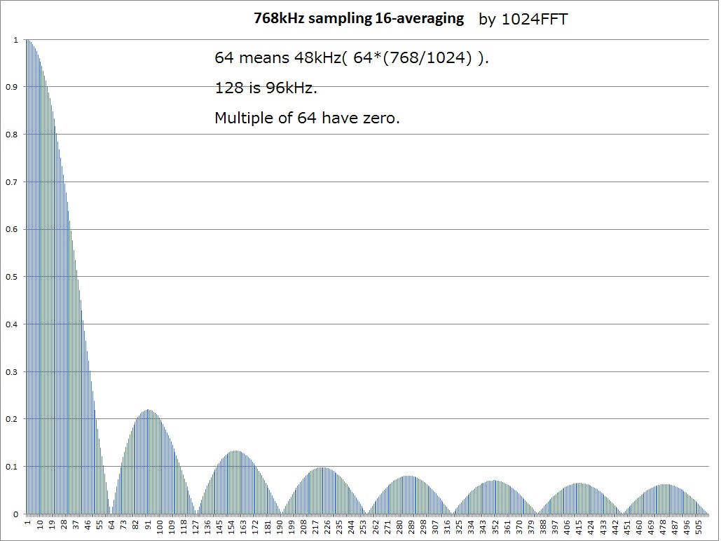

Thank you for your detailed explanation. It's very interesting and exciting! This is the first time to see 16 averaging by analog DAC and the performance.
I did SIM from your screenshot of 10kHz with 16 averaging. I guess original data is sampled by 48kHz and upsampled to 768kHz to do analog interpolation.
The attached is 1024 length FFT. The second one is magnifying of the first. The third is 12kHz sinewave before and after the filter. It looks like your pic of 10kHz.🙂
Cool! Indeed it is, I'm sorry I did not mention it. It's upsampled by a factor of 16 which means that for 48 kHz input it is running at 768 kHz on the output and for 192 kHz input it is running at... whooping 3.072 MHz 🙂

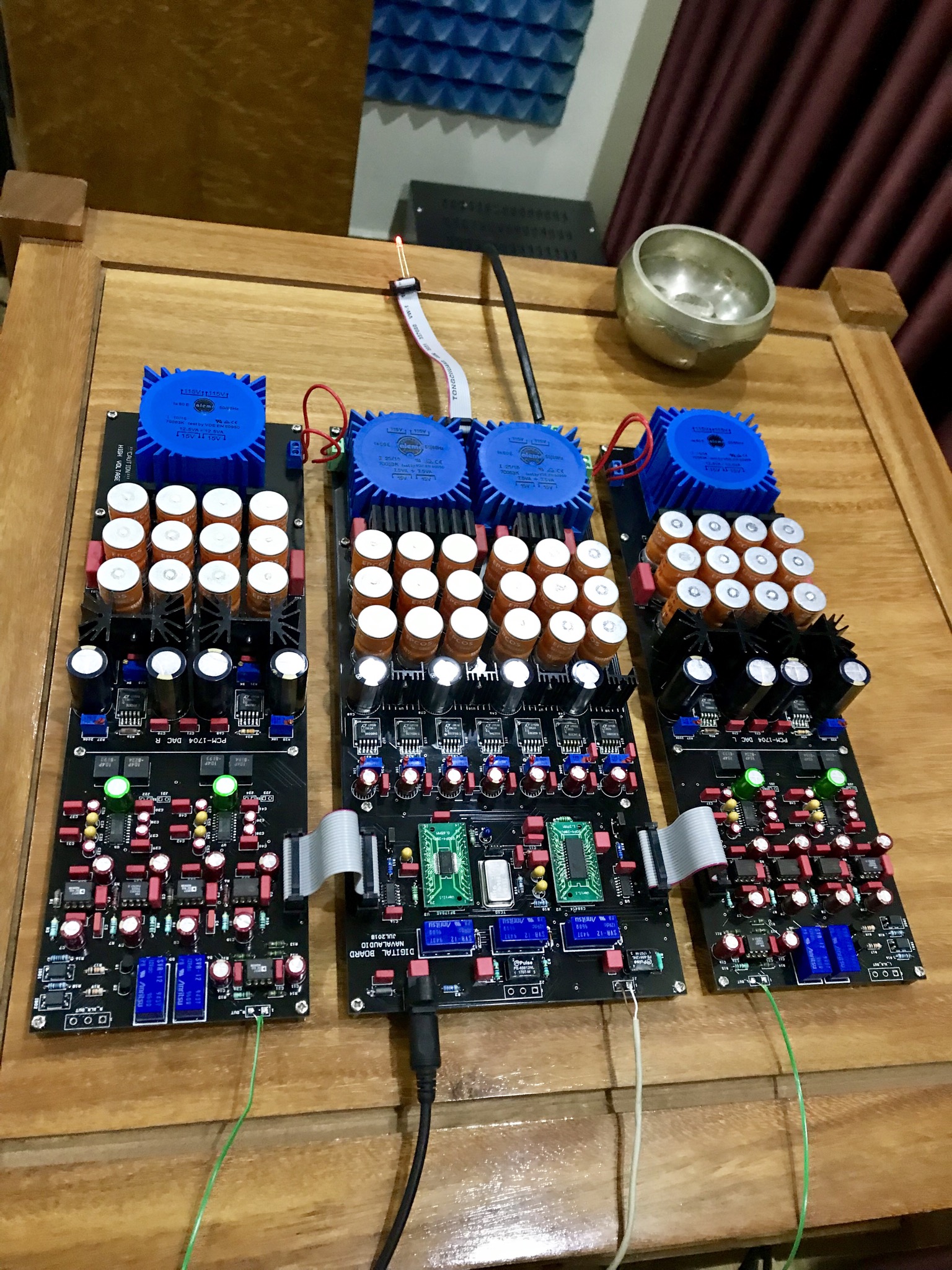

My new DAC
DAC chip: PCM-1704
Sampling/Filter: CS8414 and DF1704E
Digital Input: Spdif/ Optical and AES/EBU
Analog output: RCA and XLR
PSU with 4 Telama transformer
This ‘s DAC for CD transport! 🙂
