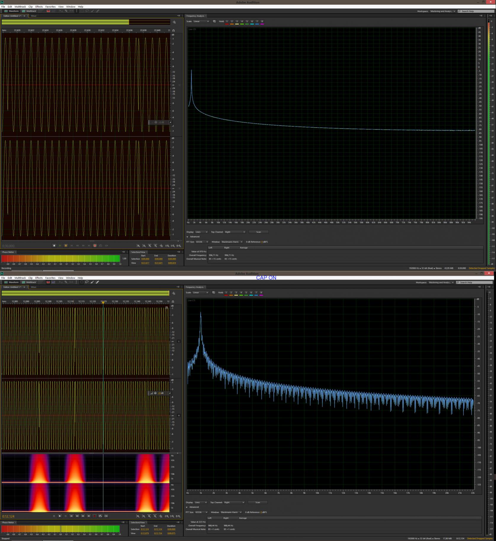

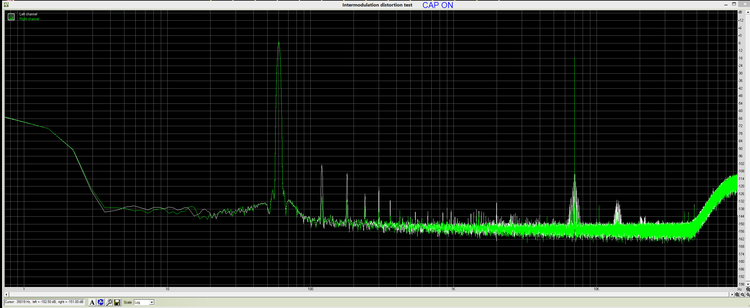

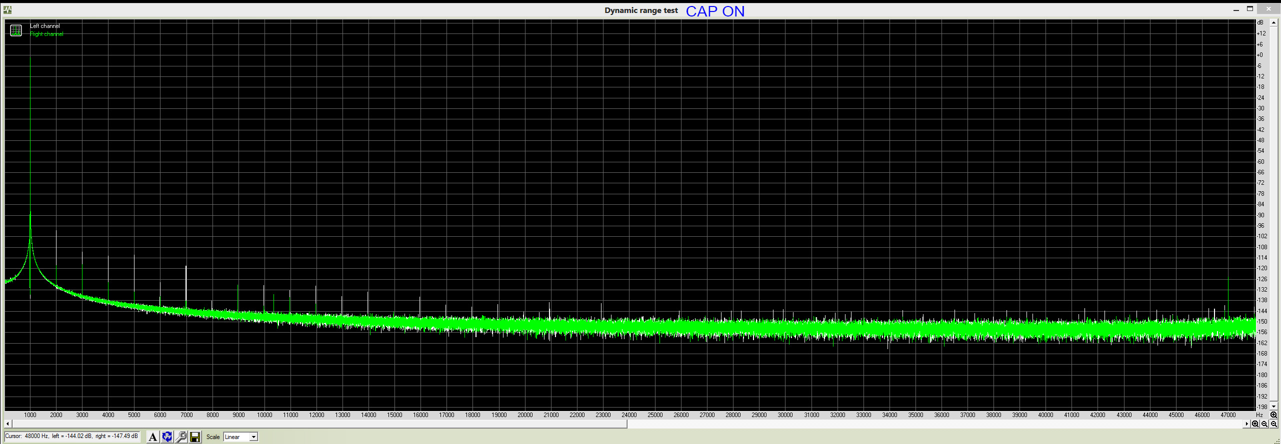

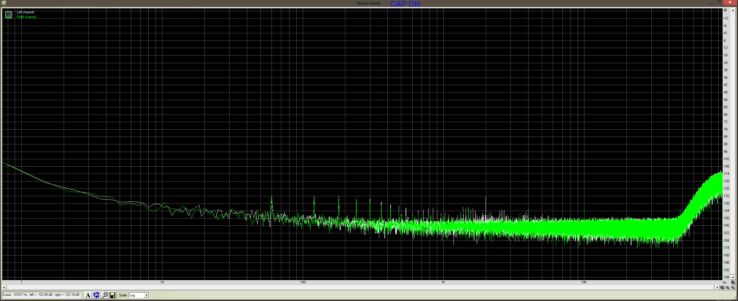

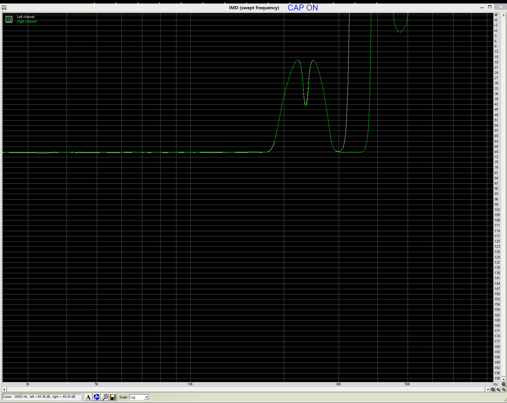

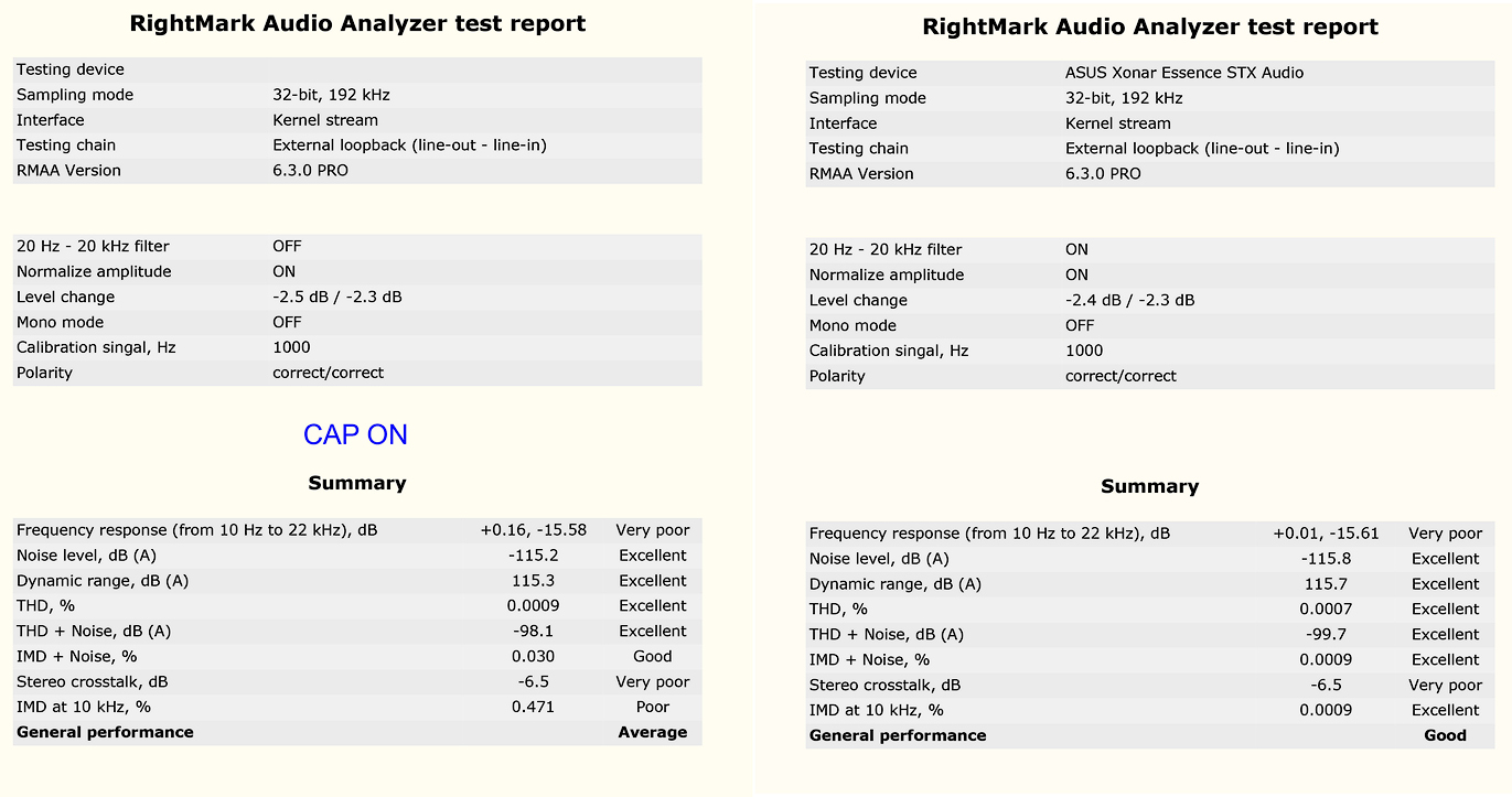

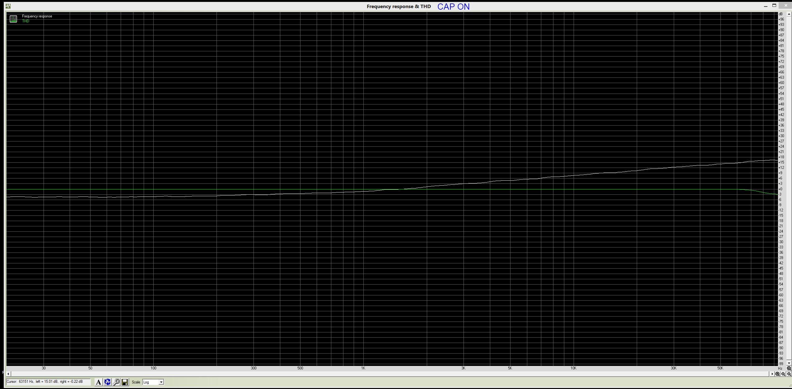

Well, well... We have some tests...
Not quite well results...🙁 But results at least to start with. There is not less "smog" after these tests, I may say...
First let`s take a look at what I`ve done so far.

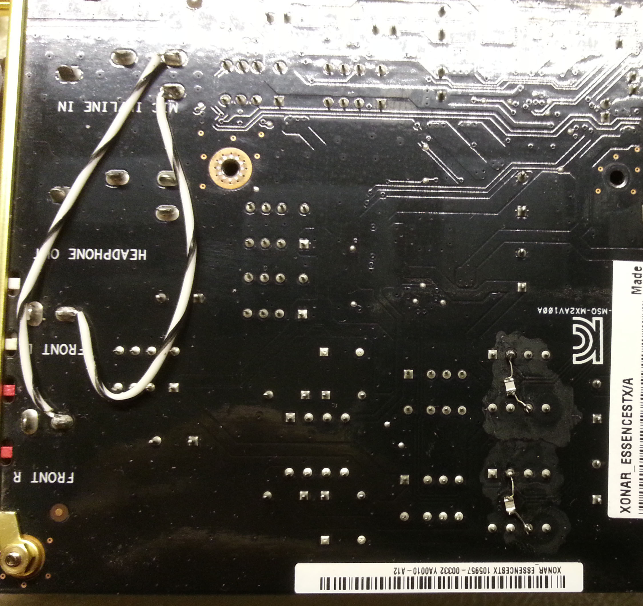

I have used a brand new and unmodified Xonar STX sound card (For sure, I did not bought it for this test 😀 )
Computer running win 8/64bit, Quad cores i7 processor, lot of memory, and so on...
Loop from Line output to input. Used RMAA Pro audio analyses software.
I have tested first the sound card as it is, and you may see here the results. You may note that the channels on this board are not quite equal. Asus made in China quality...😉 Then I have soldered in the caps over the DAC (PCM 1792) output phases, and tested again in the same setup. You have also the pictures here (pictures marked with "CAP ON"). Of course I have also listened to a test recording (that I have used earlier for my illustration of the sound stage changes), played out on this unmodified board. I used 1n film SMD cap, as you can see in picture. The same cap I use on my modified board and it gave me an obvious effect. It may not be the best choice, for the best effect, but for test purposes, I appreciated as good enough.
You may also note that the board have already all the filtering in place, as the factory designed and deliver it.

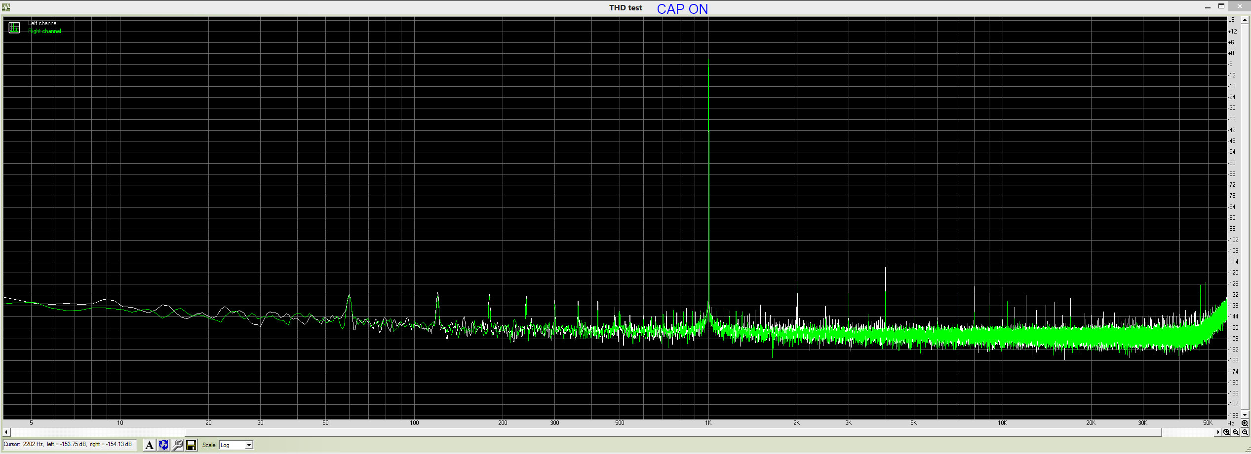

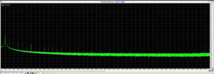

I did another test using a 1Khz sine generated file played out with Foobar/ASIO64bit Out on the sound card, and recorded in with Adobe Audition/MME/LineIn input. The same computer, the same sound card with loop connection on it. Without cap on board, and with cap on it. You have the results on the picture here by.
One may note here that are to be seen some artefacts or breaks in streaming of this file in the system. Is due for sure to the way the playback and recording are made using the same hardware. There may be not enough time for both tasks somewhere in processing... This issue it happen also in both cases (with/without caps), so has not a so big impact for the final conclusion of the tests.
The most exciting for me was to find out if on this brand new sound card, which is a good enough consumer device, the effect of these caps it might be the same obvious as I experienced on my modified board (same type).
At once, the caps it were in place, the sound scene it were open, the bass got deeper and weighty. Well, all the good and benefits of this effect it were present. So I test it with RMAA...😕
Up to you to judge this further contradictory approach. While the test shows not so good, the ears and brain says WOW!

tons of IMD!!!... That crap is added to signal....maybe is nice sounding crap 😀

I have tested with resistors in a different test session, and I`ve got only a worse sound on output. It were better sound when I had only the caps in this test configuration I used. But in the same time is this IMD which is really bead...

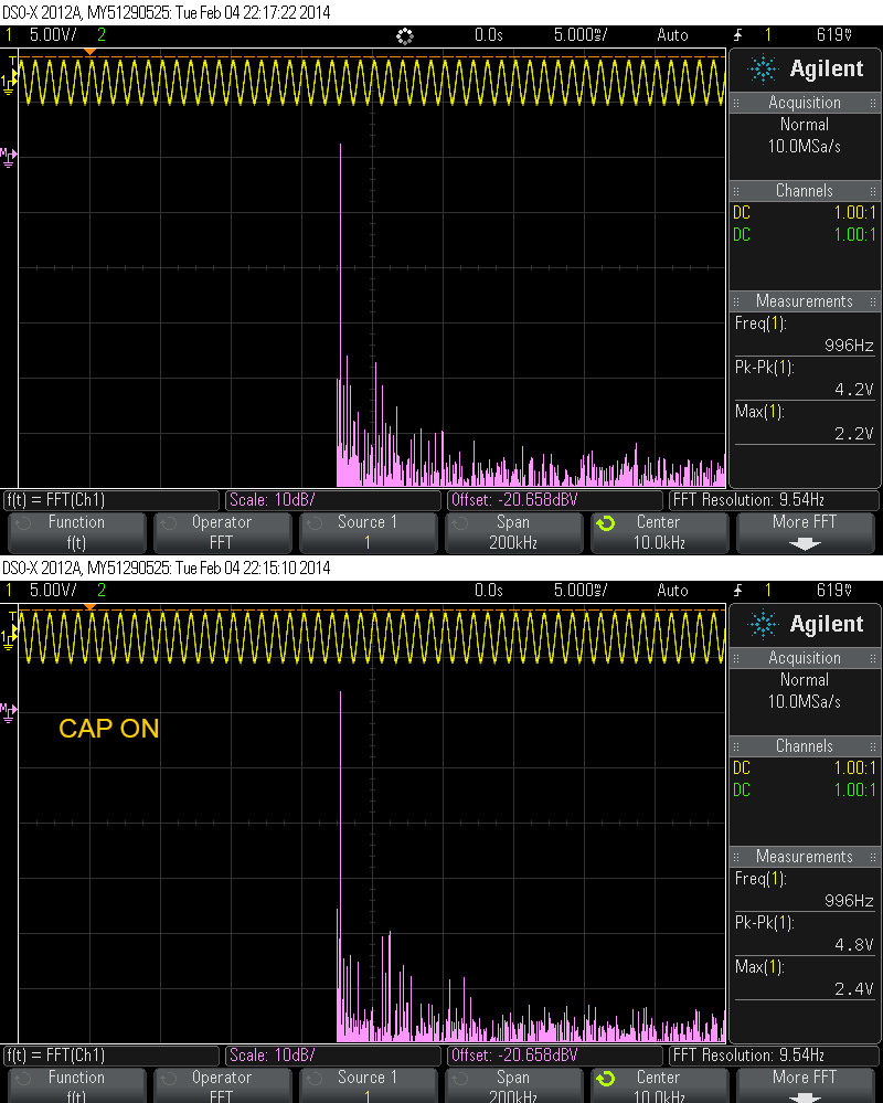

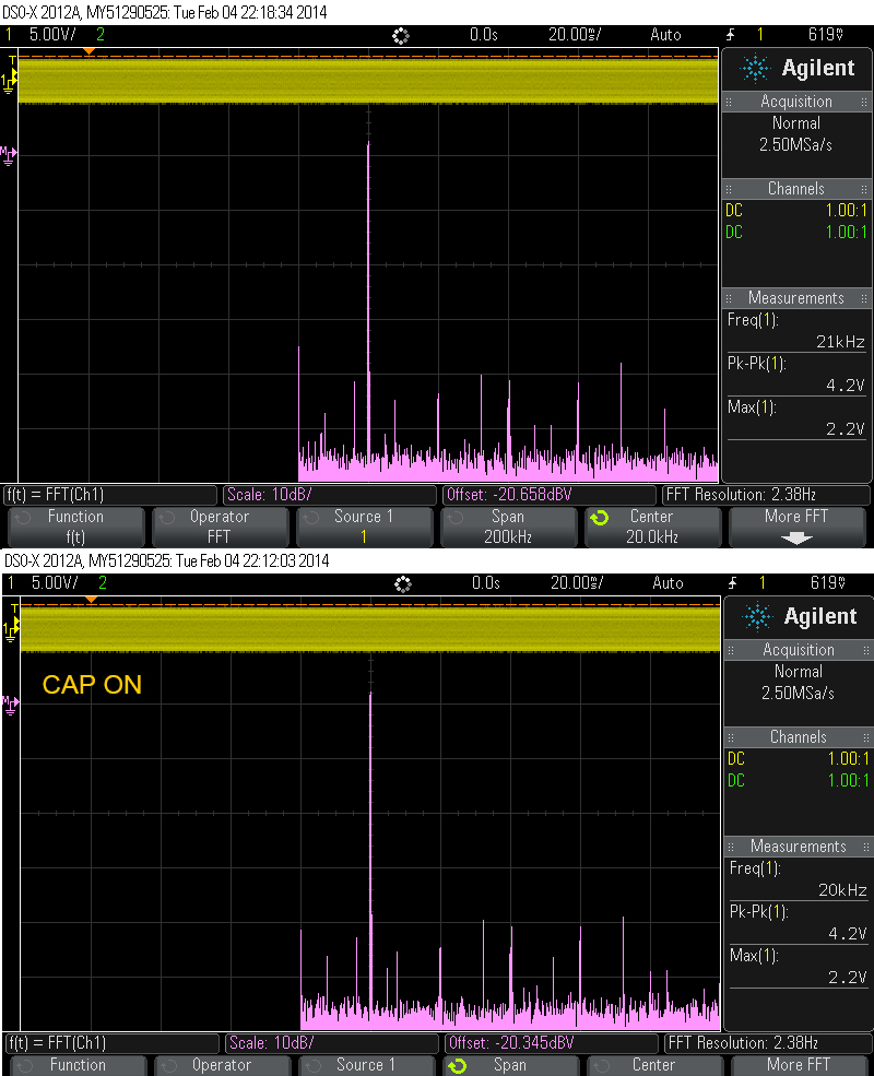

A little bit more testing...
This time without loop connection. A 1Khz and 20Khz sine signals files played out on the sound card, with/without caps connected. Signals are measured on output RCAs of the board.
I have verified the "rule" for setup of the filter: there is -1.2dB on 20Khz relative to 1Khz, using 1nF on this hardware.
