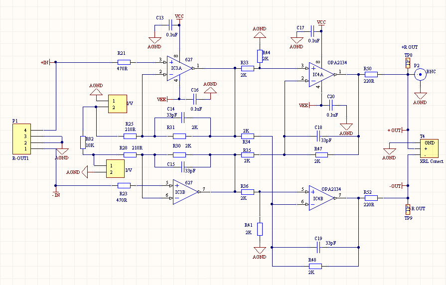

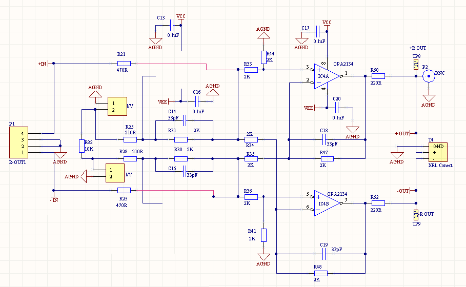

Perfect! so after new driver installation and ASIO driver installation there are still problems ?
- The problems are the same what I had written in my first posts #1777,#1779,#1780 except asio works(by it dsd too). This is a big difference of course. Maybe Vista but in the driver's readme there is Vista explicitly. You are right I should try in win7 or xp but I do not know where to get a machine yet.
- I have no connectors and box I only tried "coax in" and "rca out". The 48 khz spdif limit bothers me a little, that I could not buy a Torx147 more because I have a lots of Toslink device. So if quanghao had the connectors in stock (I need all the seven) I would ask him to sell them to me. I would ask also the smd parts what need for the #1586,#1620 repairs and the pic programmer. The connectors are important I would not wait the others.
- I have only tl072s in the IV - the opa627s not paired yet - but the sound is promising. It would be a heartache sending the dac back 🙂

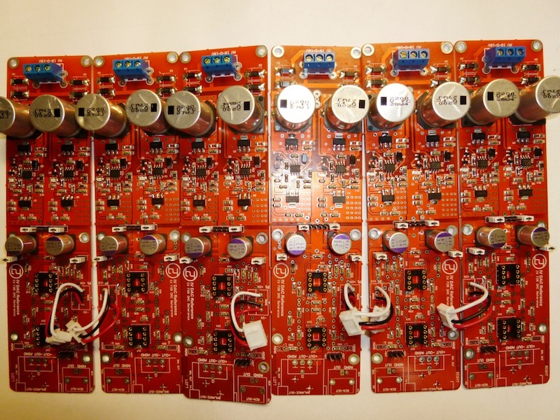

Hi quanghao,
May I ask you to send me the smd parts that I wrote about to Andrea below. In the shunts of the IV the 10 ohm resistors was replaced with 15 ohm only in three places send me a 15 ohm too, please. If you have them in stock I would like to buy from you the DAC's connectors and that cheap programmer. Many thanks!
- I have no connectors and box I only tried "coax in" and "rca out". The 48 khz spdif limit bothers me a little, that I could not buy a Torx147 more because I have a lots of Toslink device. So if quanghao had the connectors in stock (I need all the seven) I would ask him to sell them to me. I would ask also the smd parts what need for the #1586,#1620 repairs and the pic programmer. The connectors are important I would not wait the for others.
Seems you put in-correct name on the address, my name is Rachmanto 😕
Despite the wrong name on the address, I received the packet yesterday. So I will start to build it tomorrow. Thanks to Quanghao.
Before I do anything stupid, please somebody confirm that the following are correct :
Use jumper as I want to power Amanero from USB for the start.
Update Amanero firmware as per the instruction here : ES9018 USB DAC - Hi-Resolution System (is this the latest firmware version ?)
Later after everything is OK, remove jumper + remove Amanero regulator if I want to power Amanero from the DAC board.
My DAC is from the latest batch sent by Quanghao, so it should have mod to remove the shunt oscilation, right ?
Thanks in advance
Update Amanero firmware as per the instruction here : ES9018 USB DAC - Hi-Resolution System* (is this the latest firmware version ?)
your DAC, i make Latest firmware ( no need change )
Yes
No mode all, Your DAC I have to fix all, you only make and run

OP-AMP Output Stage note
The op-amp output stage has been design to have a good voltage amplification because the ES9018 with 10-20 ohm resistors as load give a very low output signal.
This output stage is used in Mark Levinson no. 380 and it is published on OPA627 datasheet like a suggested High Speed Instrumentation Amplifier.
If you remove the jumps on the output of the DAC module it is possible to use the full 1Vrms output of the ES19018 DAC.
In this case you need to reduce the op-amp voltage amplification near to zero removing the jumps on op-amp module.
But if we don't need a voltage amplification on op-amp module I suggest to eliminate the first op-amp and bypass it as show in my second image.
In this case we will keep only one op-amp on the signal path to create the un-balanced output.
