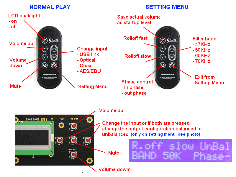

You can set the startup Volume, see guide
It's OK now, thank you. BTW, I have a strange problem. Whenever I use the remote for my air conditioner, the DAC output become distorted with lots of pops which I'm afraid could break the speaker. The solution is very simple, turn on AC before the DAC perhaps I need to upgrade my AC into audiophile grade AC hahaha
