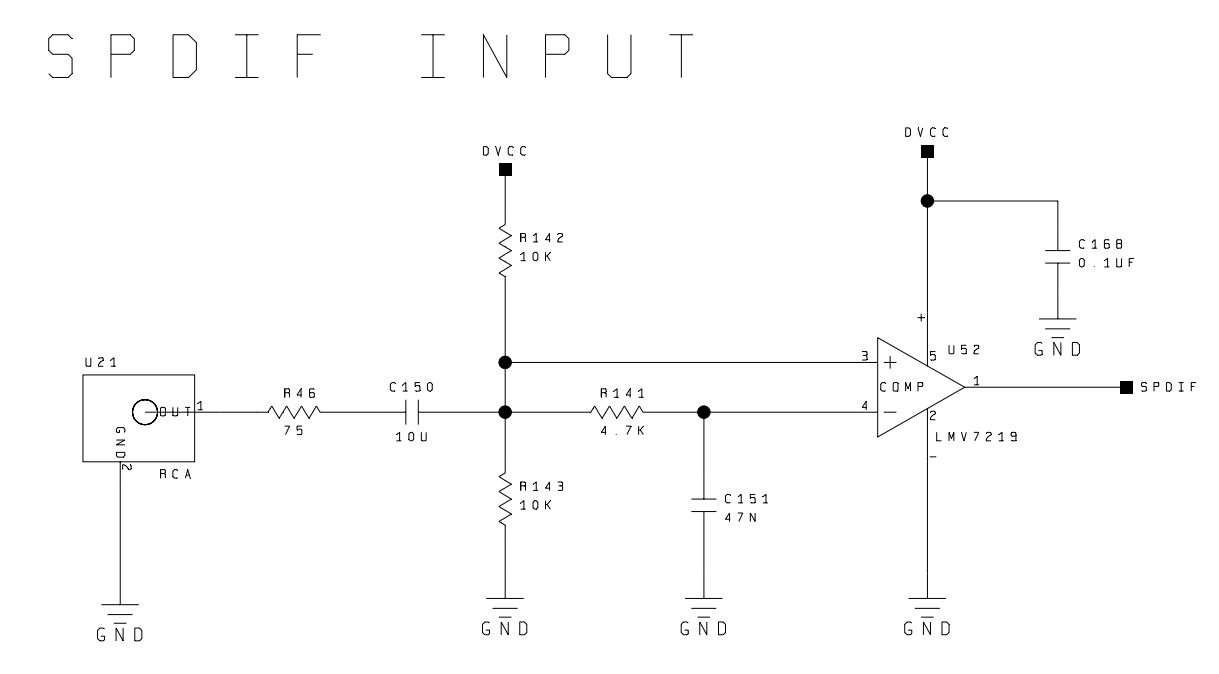

5) misterwolf , Halook [SOLVED]
problem: spdif does not work with some non standard sources
solution: eliminate the 75ohm and add a 1uF capacitor after the input transformer (cut the pcb jump).

Optical input ok up to 192kHz, coaxial ok up to 48kHz, bad or no lock from 88 to 192kHz, but i have not a specific spdif cable. I've also tested with a certificated 75ohm satellite cable. Tested with or without 75r cond., also bypassing DA1001, with two different sound card on the same pc.
Misterwolf why do;nt you try to take the pulse transformer out. I did and added a 75 ohm BEFORE the 10 nf COPPER cap. It is fatastic and noise and lock problem is vanished.
Erlend,
thanks for replay, i have used 10nf with 75r to ground before cond, without trasformer. Now lock up to 88kHz ...and with 150r up to 96kHz.
ok, new setup. 10nf wima + 300pf polystyrene and metal oxide 100r to ground (no trasformer). 96khz lock with glitch sometimes. over 96khz no lock.

I think Lundahl 1684 will solve my problem. I will order them next week.
