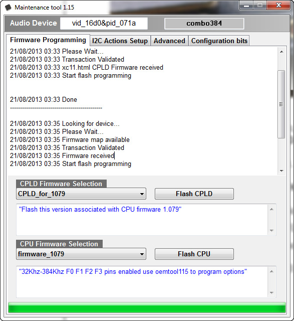

Just been running more tests...
DSD plays but PCM remains silent. The PCM rates are correct on the display though. Made one other observation which I did not realise previously - only left channel (right side output) works for DSD. Looks like something is seriously wrong? Shall try "swapping channels" on the firmware to see if it makes any difference.
Tried different permutations. The right channel (left side of the DAC) does not work with the Amanero. Still no PCM playback. Coax works fine - both channels work OK. No way for me to test optical and AES. I hope there isn't a fault. Really disappointed! Obviously, it might still be the Amanero at fault and will be grateful if someone can test it for me, or send me a module that is definitely known to work. Quanghao - are you sending me the parts we discussed previously?

As I have tried to explain a few times....
USB input (Amanero):
DSD: ONLY right channel works
PCM: Does not work at all (silent but correct rate + lock on display). Works like DSD above if on-the-fly conversion to DSD
Tried JRiver (KS) + Foobar + HQplayer (linux) + mplayer (linux) + aplay (linux)
Tried different firmware revisions +/- swap PCM/DSD channels (various permutations)

Did y'all flash the Amanero properly?
Choose "CPLD_for_1080" and "firmware_1080" for the latest FWs.
Done mean OK
1080 ok
