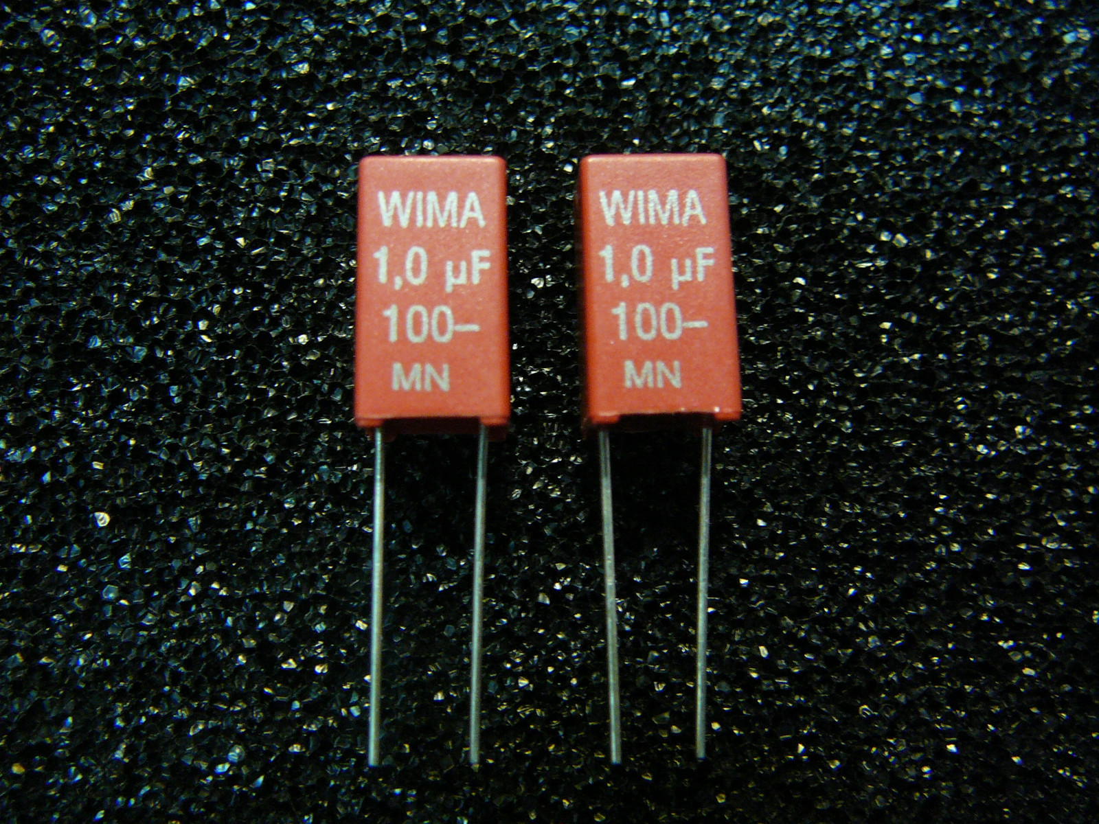

I have cut the trace on the PCB between the pins of C36 and installed a capacitor "Wima 1.0uF 50V". The 75 ohms resistance is still removed : the DAC can now lock at 96 KHz without not any noise at all.

This cap can use 0.1uF to 10UF, but i not like wimma cap,
I like VISHAY 0.1uF ( 0.1uf / 100VAC/160VDC, MKP-1837, Metalized Polypropylene,)

I will try 4.7uF 50V "Black Gate" non polarised capacitors from Rubycon... It can be quite good too.I like VISHAY 0.1uF ( 0.1uf / 100VAC/160VDC, MKP-1837, Metalized Polypropylene,)

I have best results with BG NX High Q 100 nf . Hate the Vishay 1837 and Wima.
