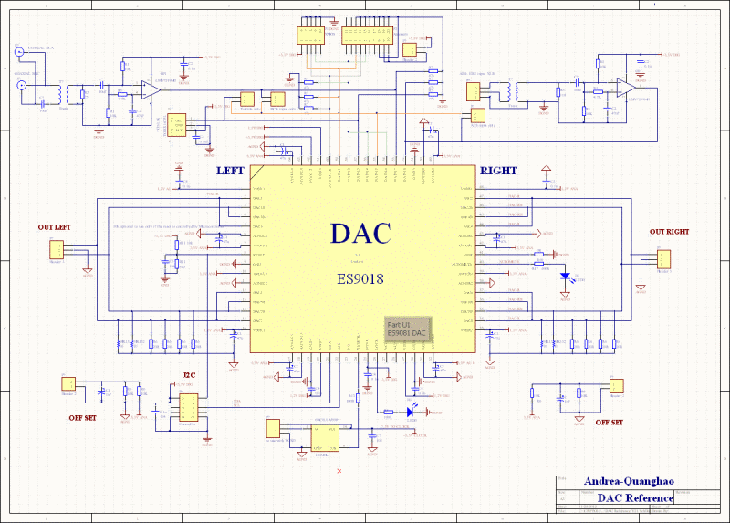

And a readable one of the DAC board - the one on ES9018 USB DAC - Hi-Resolution System* is just too small to be useful.

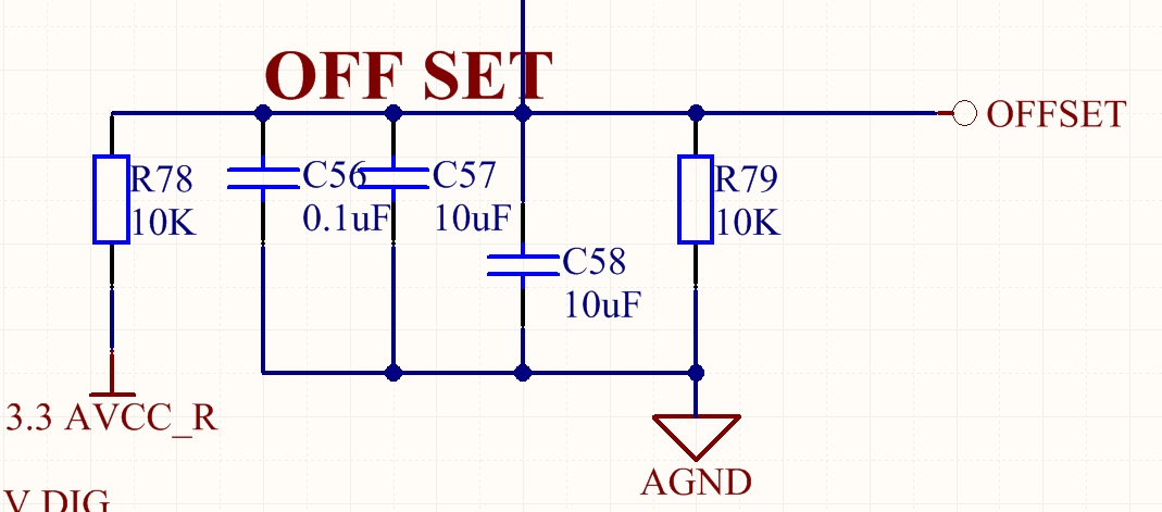

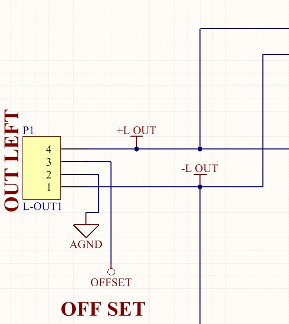

What exactly is OFFSET? By any chance a reference of the DC offset of the DAC output?
you note, the DAC output with IV opam, I did not use the DC off set - because DC is set off virtual mass, so I do not like.
Just change the jumper and GND is unchanged
If you want to use the DC offset properly connect the points on the PCB (labeled DC off set)

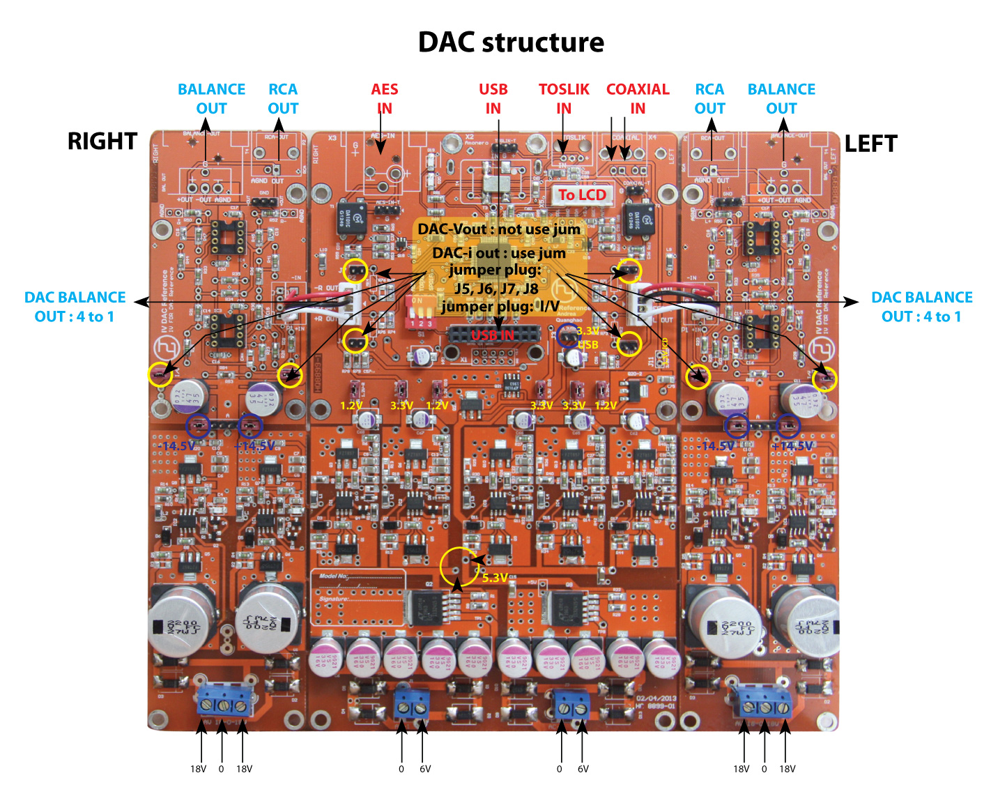

What are all of the other jumpers used for on the DAC board? I'm asking about all of the jumpers which have voltages listed next to them on the board.
I'm confused as to what their purpose is. And I was speculating that these might allow for external power-supply options, such as a method to externally power the clock if we wanted.
this image you can see

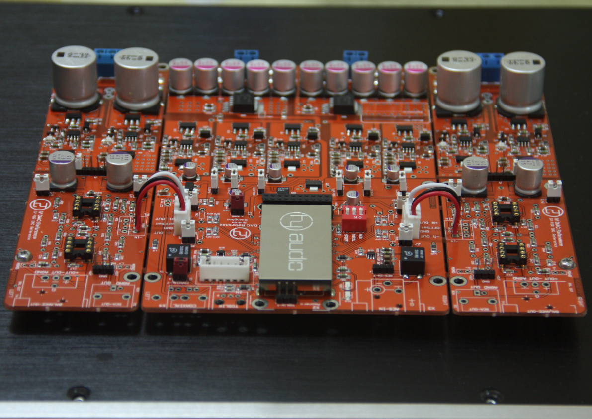

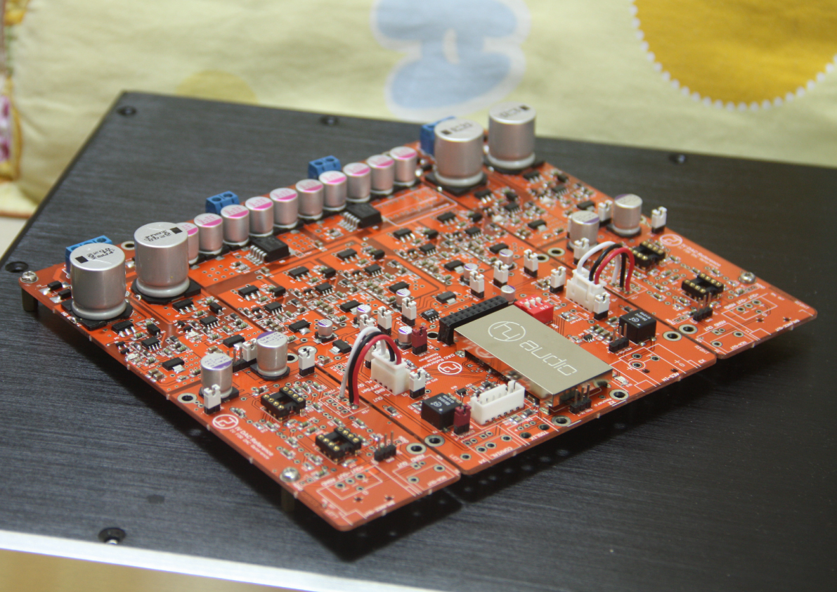

You will receive complete DAC
A. You will receive complete DAC:
And this is the complete picture dac, you see
some of you did not purchase USB, so you purchase or subscribe themselves from me, I will always fitting for you.
Thank you
1. claudio52. DAC Finis without USB
2. Smoothquark DAC Finis without USB
3. Myfavoritettthing DAC Finis without USB
4. NicMac DAC Finis without USB
5. Mattmax DAC Finis without USB
6. gjorgji DAC Finis with USB
7. Masterkey DAC Finis without USB
