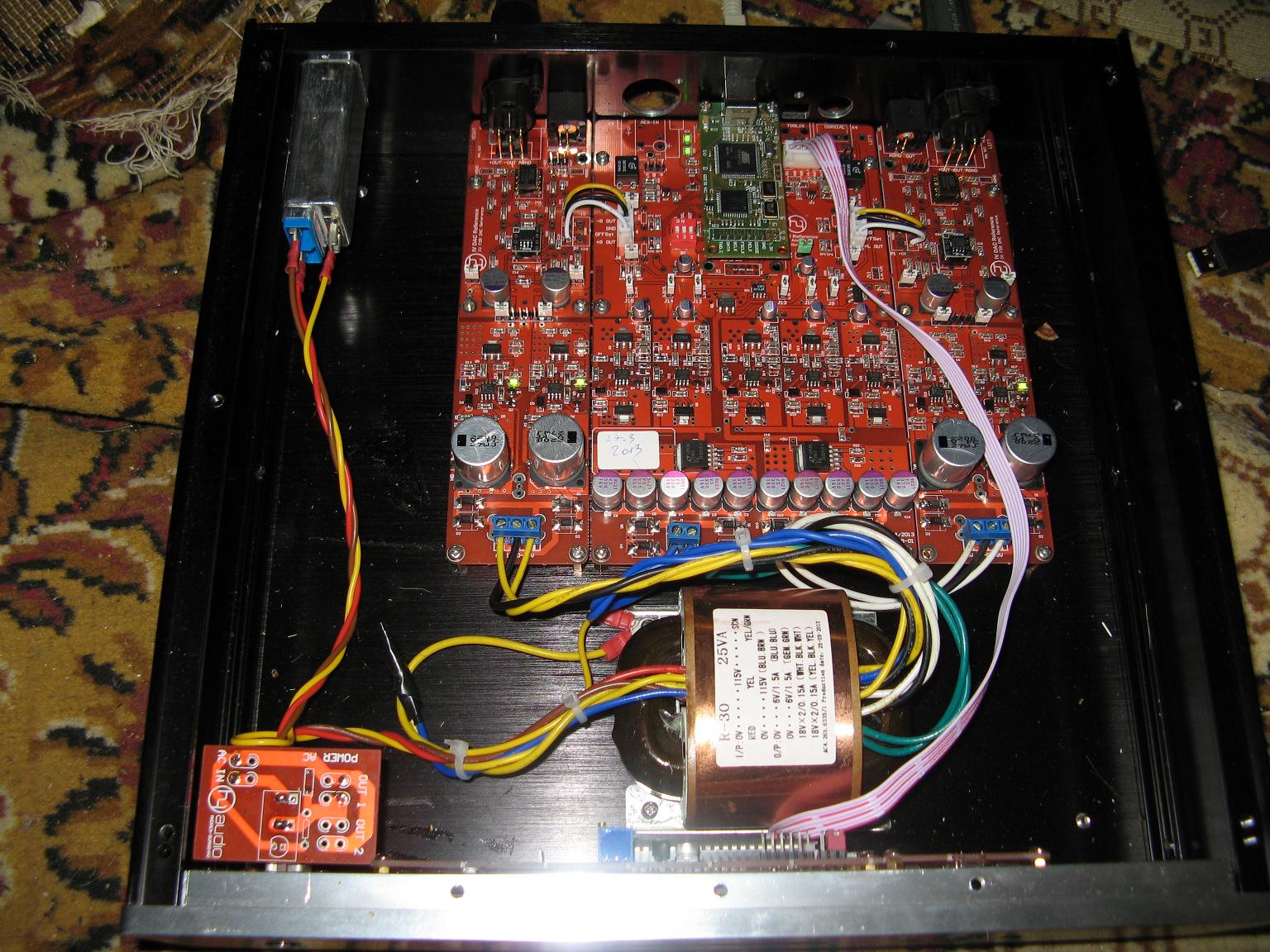

Got mine wired up too, installing drivers took more time than assembly. Packaging was a bit thin as mentioned by others. However my case was not dropped, only shaken as the board was hanging by one bolt and the screws for the power connectors was rattling inside the chassis. Supplying screws for the XLR connectors was nice 🙂, however missing correct length standoff for the Amanero board (no biggie). Sounding great so far. I'll wait with the tin shield until those new output boards are perfected and possibly order both at once.
Thanks a ton for the time and effort in putting this GB together.
-Rgs

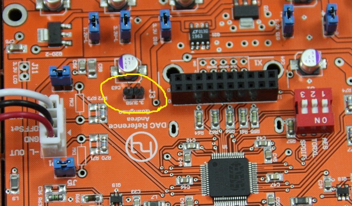

Hello everybody
I received mine a few days ago, but got the time to test it only yesterday...
and I wasn't getting any sound out of it!
I tried only USB for the moment, I connected the transformer and two RCAs for output, then plugged the OP and powered
the system power up, and show DSD USB lock on the display. I can control everything from the panel, but no sound using Foobar and all the drivers installed (onto 2 different PC, with Windows 7 and Windows 8)
Any suggestion? The modification of the Amanero is absolutely necessary for playing?
This evening I will also try coax...
Boxi80; please use : [url=http://www.jriver.com/ said:JRiver Media Center software[/url]
best for usb and music!
may be you use jum for J3 ( 3.3V usb) , please take it out !
thanks
Boxi80; may be you use jum for J3 ( 3.3V usb) said:thanks Quanghao!
the problem was exactly this one... I was in a hurry to try it and I didn't check everything
It's playing right now!
thanks again
