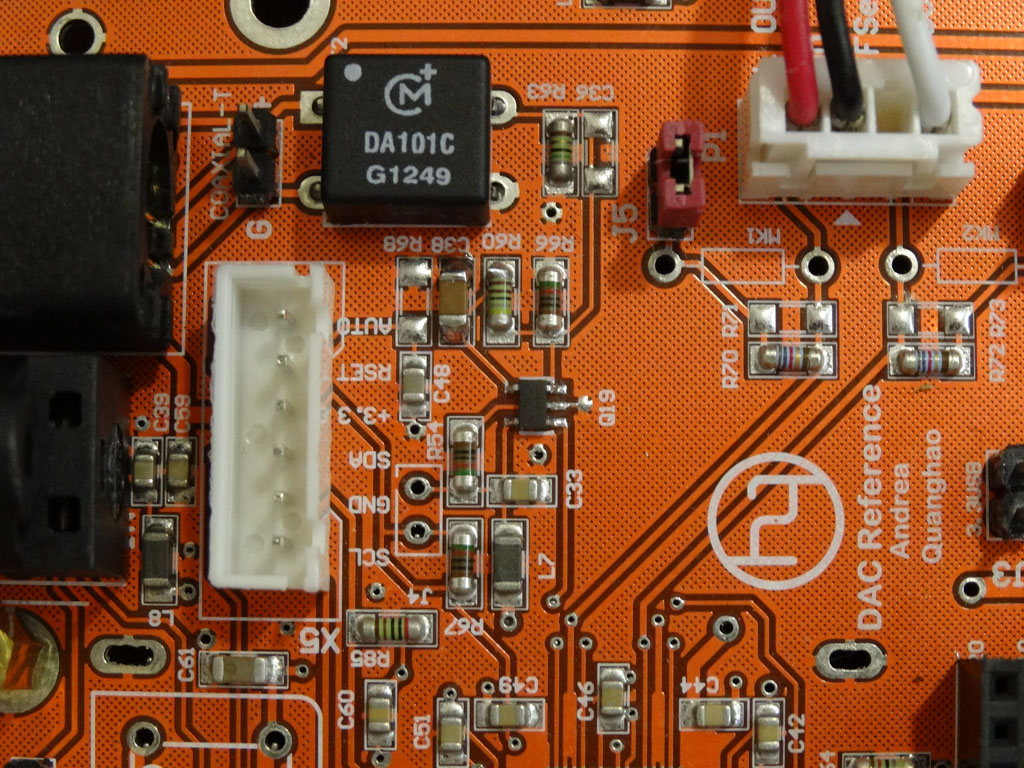

Here is close up of the spdif section of my board
Just for info, I noticed that Hifiduino has a pre-production board (I believe). His board's C36 has a cap and C35 has a resister (?) and Crystek CCHD-950-100 osci.

Hi Halook,
Here is close up of the spdif section of my board.
- On mine, R68 is installed but this part of the circuit does not concern the coaxial input.
R68 is not part of the in put.
It's distributed R DAC chip set - ** Although this code worked, but still need to keep this resistor **, I welded it for your self the 2nd post. The first time you send is not it.
You should keep it. If not please help me weld it, or worth 3.3k Ohm 3.3K Ohm (SMD 1206). No need resistors good.
