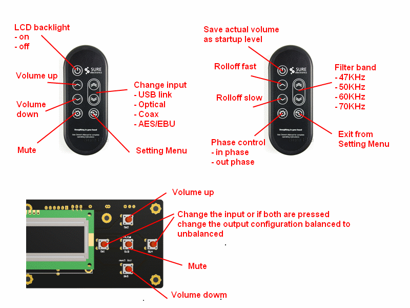

I have realead a new frmware version with the possibility to change the output configuration and get an un-balanced signal on output.
You can connect directly the DAC output to your amplifier with a single capacitor or add a normal single ended stage like my DAC End with AD1865.
Here the new firmware and the manual of the remote command.
It is possible update the firmware with the cheap Pickit2 or any other clone.
