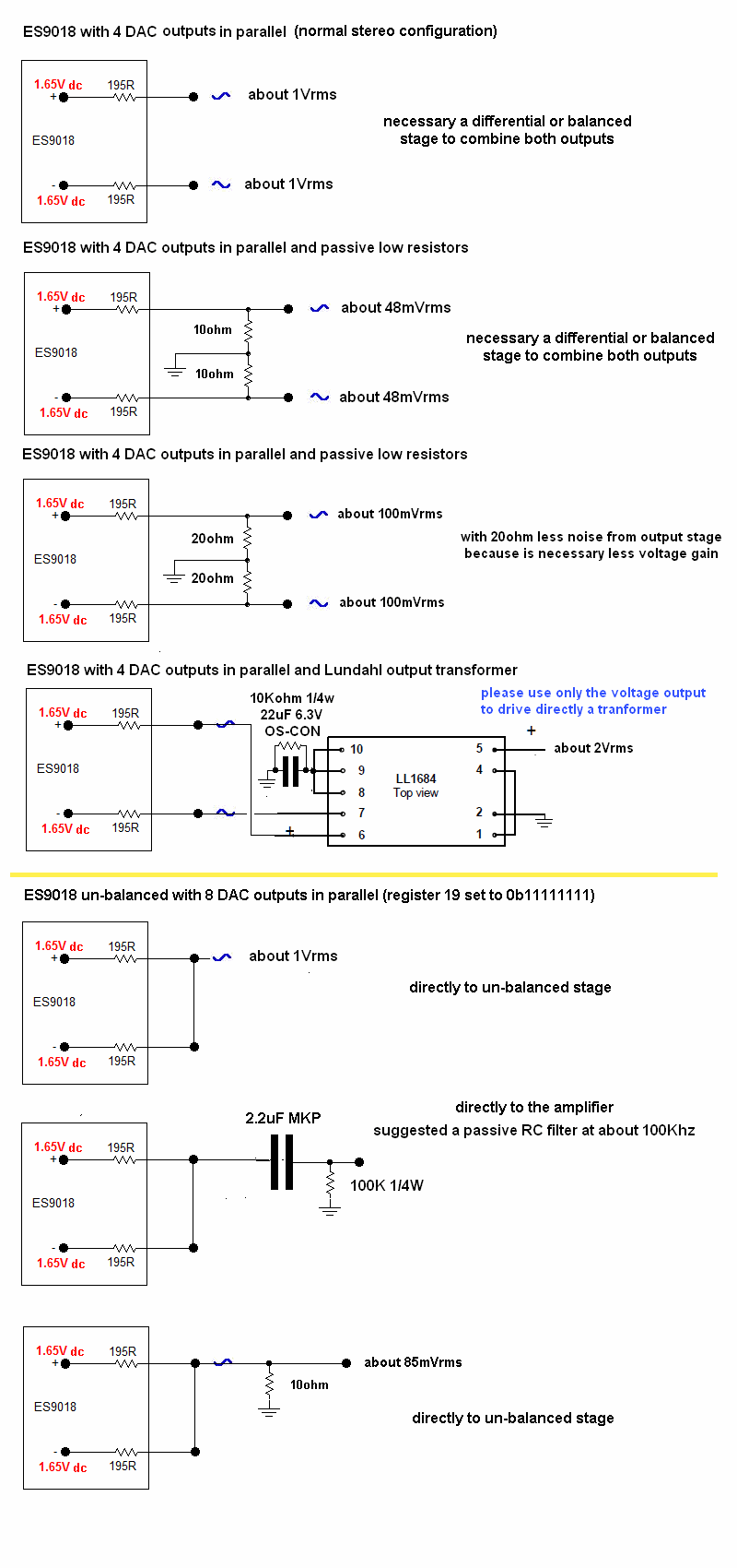

ES9018 in un-balanced mode
I have found that it is possible convert the output of the ES9018 in un-balanced
As Danny wrote , it's very interresting to have unbalanced outputs from ES9018 but, could you give us more informations do to this (tutorial) ? URL ?

yes, you can use un-balanced with this DAC and the new code, I have updet all new code for all.
DAC 32 out Un-balaced well with IV Of DAC-END 2 ( IV uase tube 5687 )

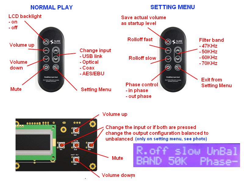

Balanced - Unbalanced
Good news and good job.
A basic question : with the same code , can we switch from balanced to unbalanced (and vice-versa) ? If yes , in what manner ?

output stage considerations
The ES9018 is not a pure current output like AD1955 and PCM1794.
In the datasheet is mention the current output but I consider a force to the chip.
So will be necessary some listen tests to check the best configuration.
Here there are some output configurations including the un-balanced available with the last firmware release.
Hi Guanghao,
Br
Jacky
yes, all in one , you can run balanced and unbalanced!
thanks
See the attached image in post #606can we switch from balanced to unbalanced (and vice-versa) ? If yes , in what manner?
The left/right front panel buttons are labelled as:
"Change the input or if both are pressed change the output configuration balanced to unbalanced"
setting menu
here the last guide.
The microprocessor stores in the flash the information about the output configuration, so you do not need to set this to any swith-on.
Balenced-Unbalanced
Thank you all for your cooperation and your very clear explanations.
