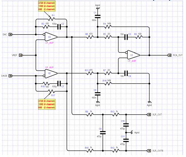

1) Original ES9018 schematic for evaluation - active IV with feedback (balanced)
Common op-amp configuration

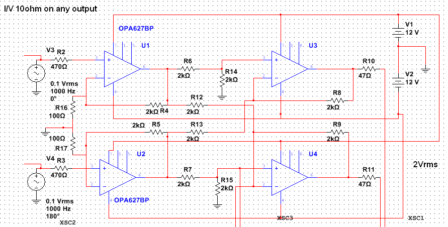

2) Actual op-amp module
used also in Mark Levinson no. 380 and published on OPA627 datasheet as High Speed Instrumentation Amplifier (balanced to use in voltage or current mode with passive IV)

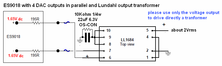

3) Lundahl LL1684 (balanced in voltage mode)

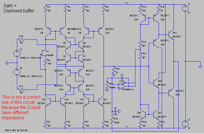

4) Satri design (not suggested)

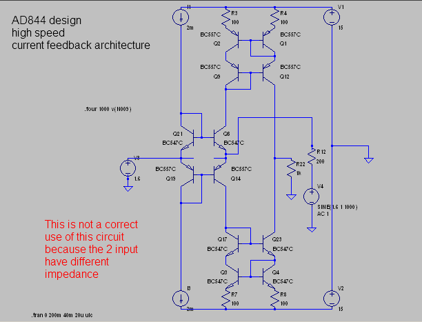

5) AD844 design (not suggested)

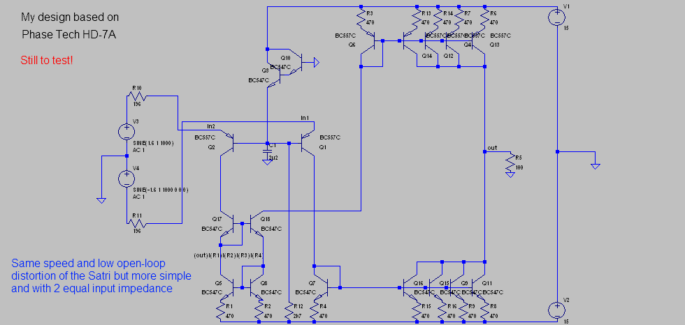

6) My design based on Phase Tech HD-7A (balanced current mode)

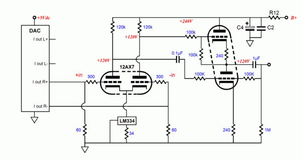

9) Broskie unbalancer, scroll down to "Unbalancer as I-to-V Converter"
Some people who have tried it, find it one of the best.
That's great !!!I should test many of these in the next days.
That's great !!!
I don't consider the Broskie unbalancer a good circuit for many reasons.

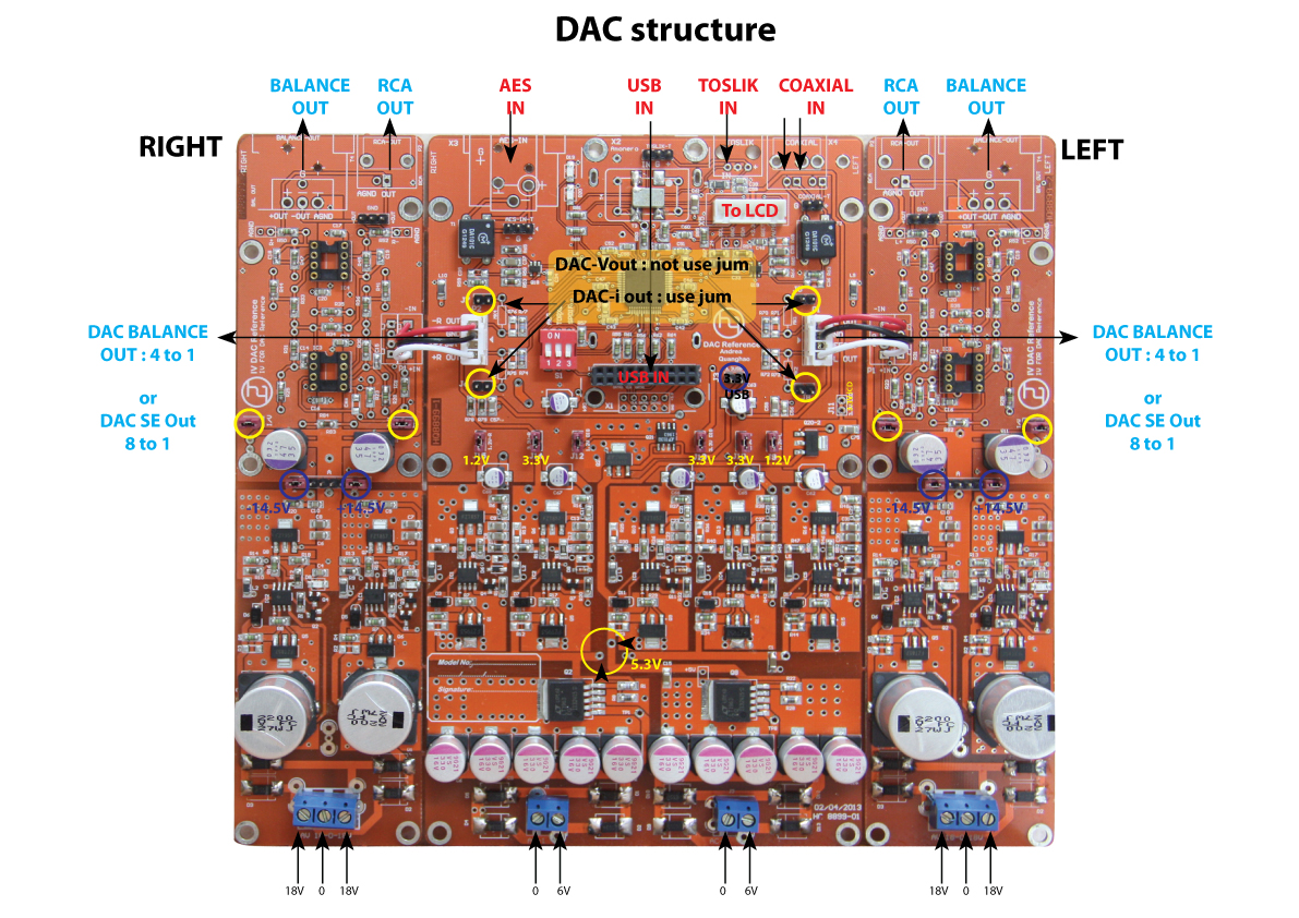

Hi Quanghao,
Thank you for all your hard work.
I've received ES9018 DAC kits on 1st June.
I hope that you should provide a detailed instructions for assembling your ES9018 KITS.
- cable wiring
- jumper setting
- remote control function
- precautions
- troubleshoot
- etc...
Thank you

Hi Quanghao,
Will this XLR fits the I/V out board?
Please also provide us links for procuring all the necessary I/O connectors
halook
yes
