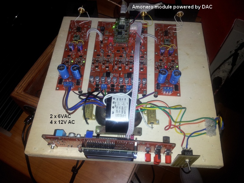

Amanero company is testing a custom ASIO driver to use more USB DAC module as a single multi channel audio device.
This mean 2 usb cable for any stereo channels.
I will give you an update soon about this solution.

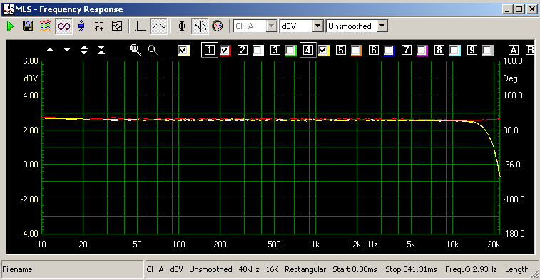

Nice, so we can in realtime adjust the settings to our preferencesI have integrated in the firmware the rolloff setting, fast to slow.
