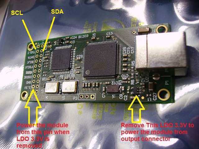

In the picture, it says Amanero module is powered by the DAC.
Is there a dedicated regulator on the DAC to power the Amanero?
Or did you share one?
yes, in this DAC have one

a separate power supply 3.3V for USB, you can simply use Jum.
And how to remove the power supply from the computer like this photo.
Thank you!
Thank you!
Thanks for the info and the pic.
Nice to know, I thought I was going to need to supply seperate power for the Amanero. I didn't want to use USB power for it, nice to find out that I don't need to worry about that.
