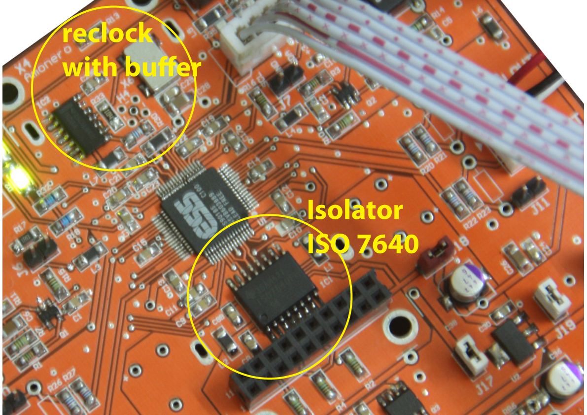

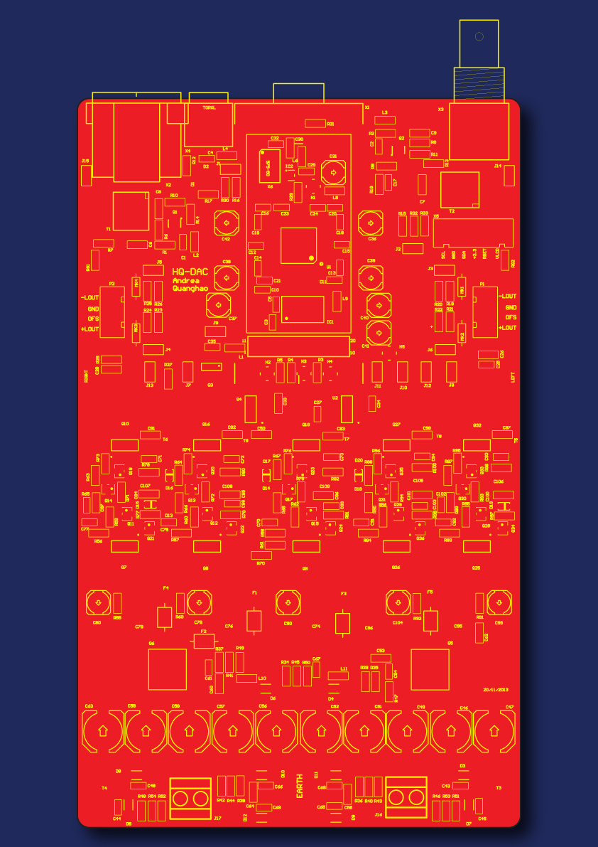

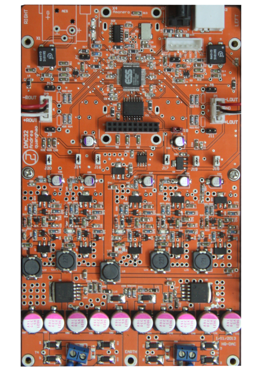

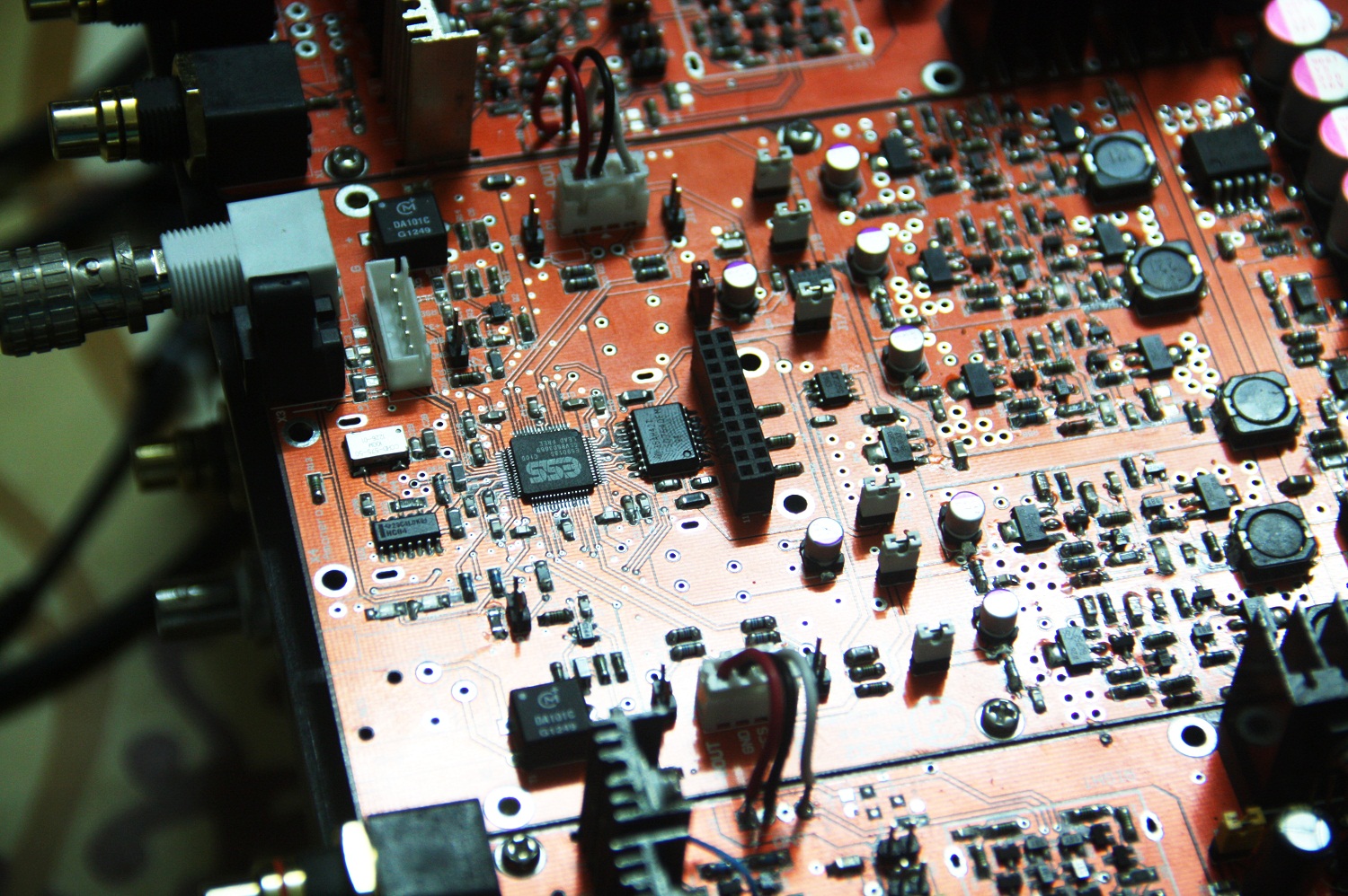

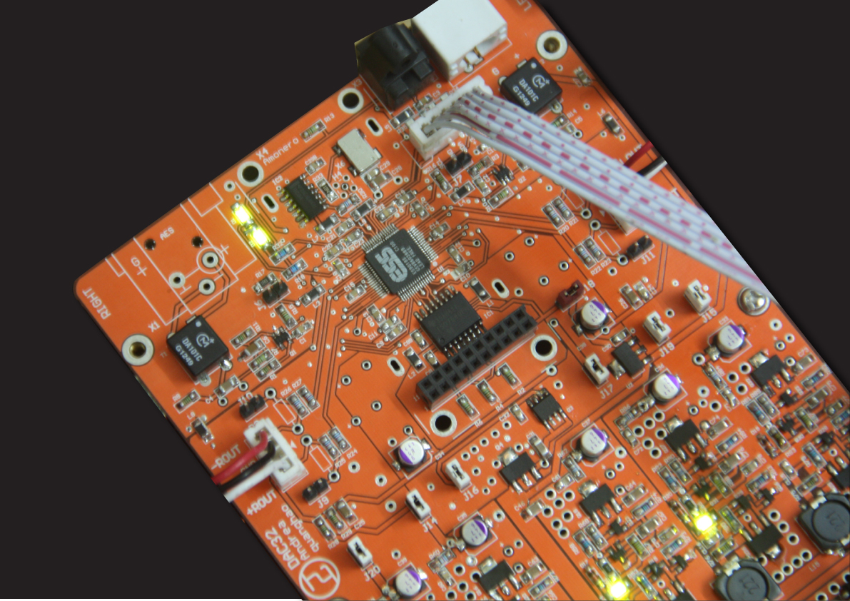

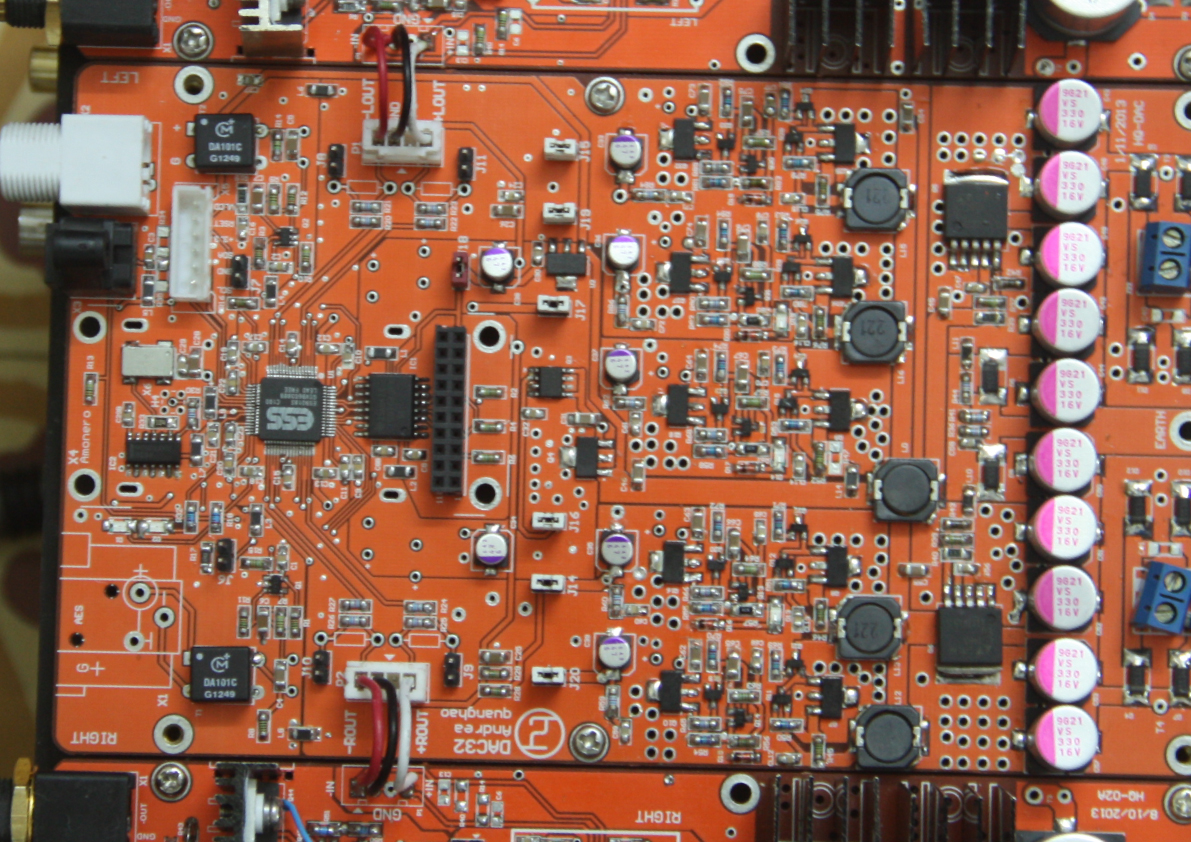

and here is the next image, I run tests before production DAC PCB version 2!

Regarding the output stage, based on my humble understanding, your design is like this:
ES9018 V-out > Discrete V/I > I Amplication > Discrete I/V > MOSFET Class A ouput.
Am I right?
I'm wondering why don't design like this:
ES9018 I-out > I Amplication (like SATRI circuits, which I like very much!) > Discrete I/V > MOSFET Class A ouput.
BTW, what is the purpose of the OPA2134?
I really like the headphone-friendly output design!
Thanks.
