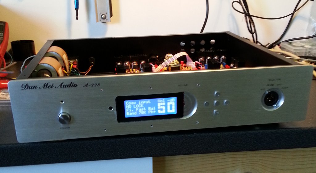

Hi all!

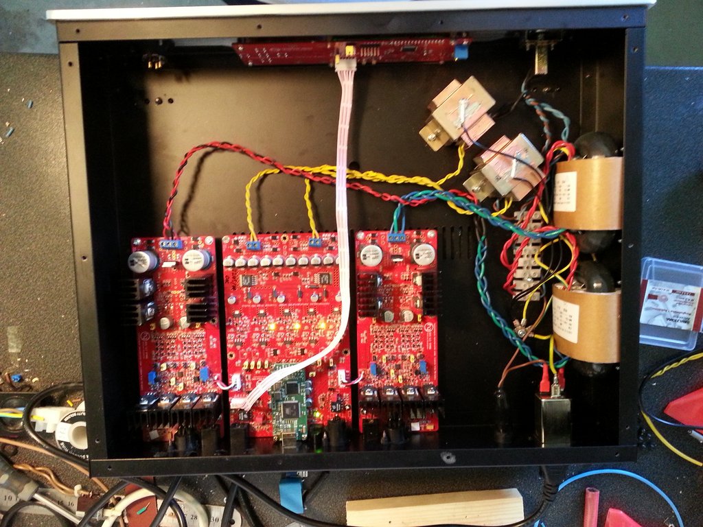

The slowest build in this group buy is nearing completion. The boards has been lying and waiting for me getting the time to get them a cosy case to live in.
As you can see from the pictures i used transformers out of my parts bin. The r-cores for the output stages are quite overrated. The EI:s for the DAC are standard surplus that got a copper tape bellyband that are grounded on the starground.
All boards are connected to case via the XLR connectors. All the transformers has their screens connected to a starground that are earthed.
I tried to keep as big distance as possible between the transformers and the boards. The EI are orientated for the lowest radiation in the directions of the board.
Well how does it sound? Beautiful, but maybe a little confusing. Very laid back with out losing details. Rich mid, fantastic treble. The bass is.... well maybe overly rich. I can not shake the feeling the the non global feedback stage could benefit from some feedback....
I have some other 9018 dacs that sound fantastic. They sound more or less the same. This dac is totally different and much better than the others. Still after a few days och listening the final verdict got me hanging. As other pointed out there is something about the bass. It is not boomy, but rather rich, maybe a tad to rich.
Im using my stax 202 with a transformer at the moment, and will soon have a proper amp up and running, then i can have a proper listening.
Hmm... This post was longer than i had planned, time for some questions:
1.
I have a quite loud turn off thump, quite annoying. Loud enough to get my making the famous stax fart. I have not seen any comments about that. Is it normal, is there a remedy?
2.
It has big trouble getting a lock via optical in from my TV, 48khz PCM. My other 9018 dac has the same trouble. I tried another non sabre dac and it worked fine. Then the TV outputs ther sampling rates it is fine, only troubles with 48khz. Is this a general problem or is it my TV?
3. I have a very, very slight buzz coming from the channels closest to the transformers. I will add that I will add a thick steel screen around the boards as soon as i get the time. Hopefully that will kill the buzz. But is the grund connection via the XLRS enough? Should ground the boards to a proper star ground?
4.
Has anyone tried to get the output directly from the output of the dac to a high impedance (>50k) amplifier via serial capacitors without any output stage or transformer?
Thanks for your time and thank you Andrea and Quanghao for a exelent DAC.
B.r Christian
