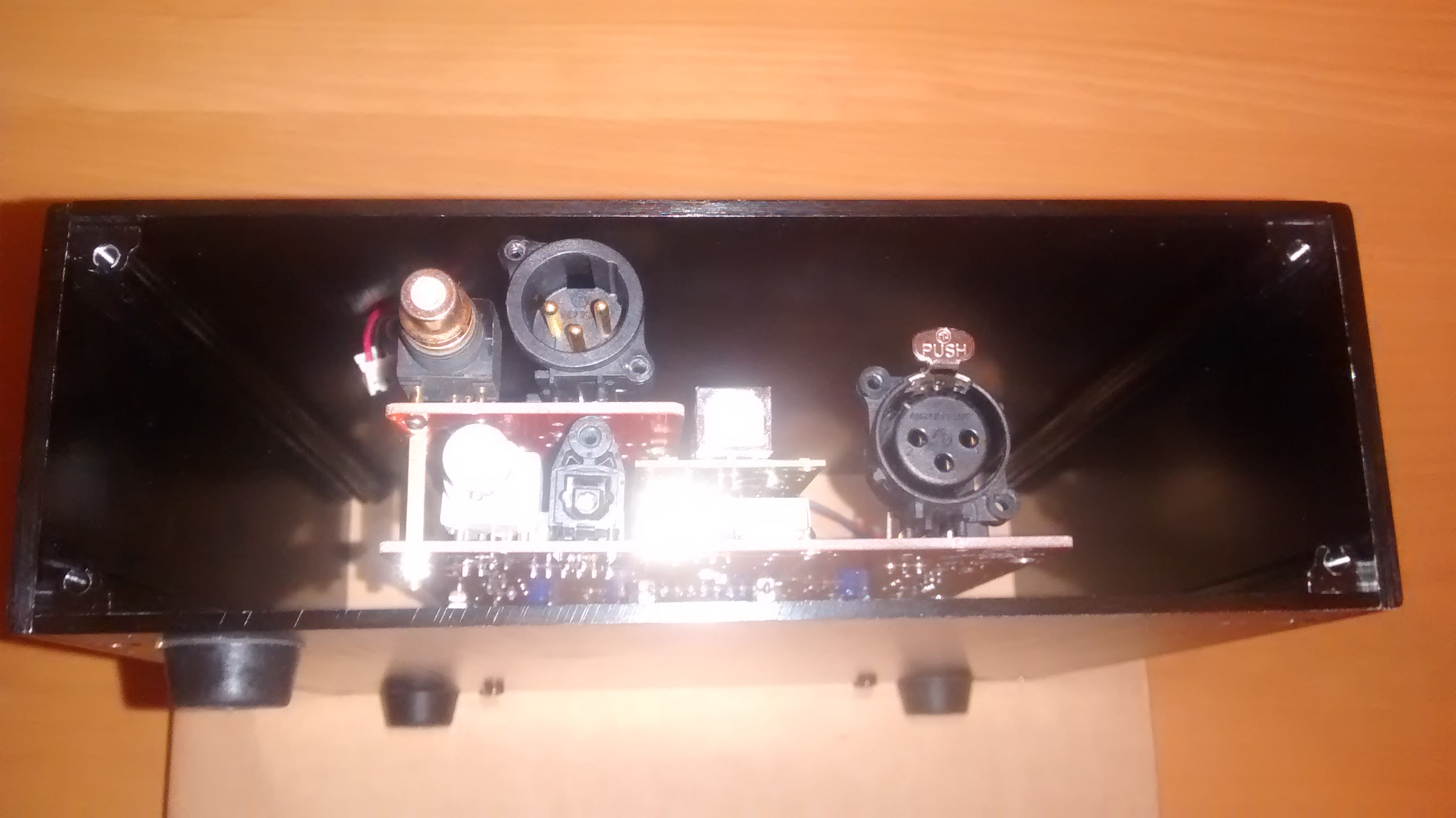

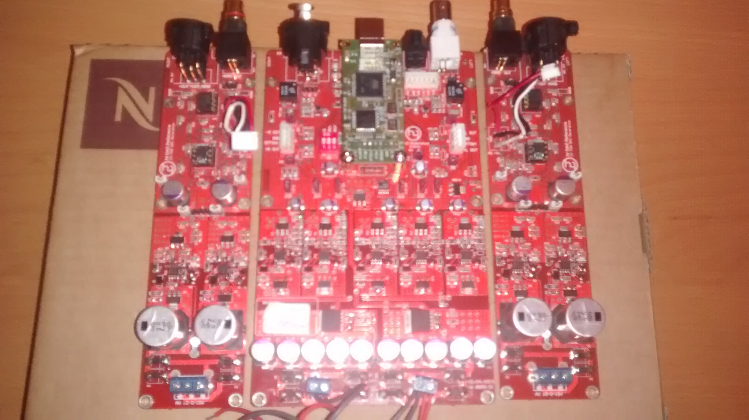

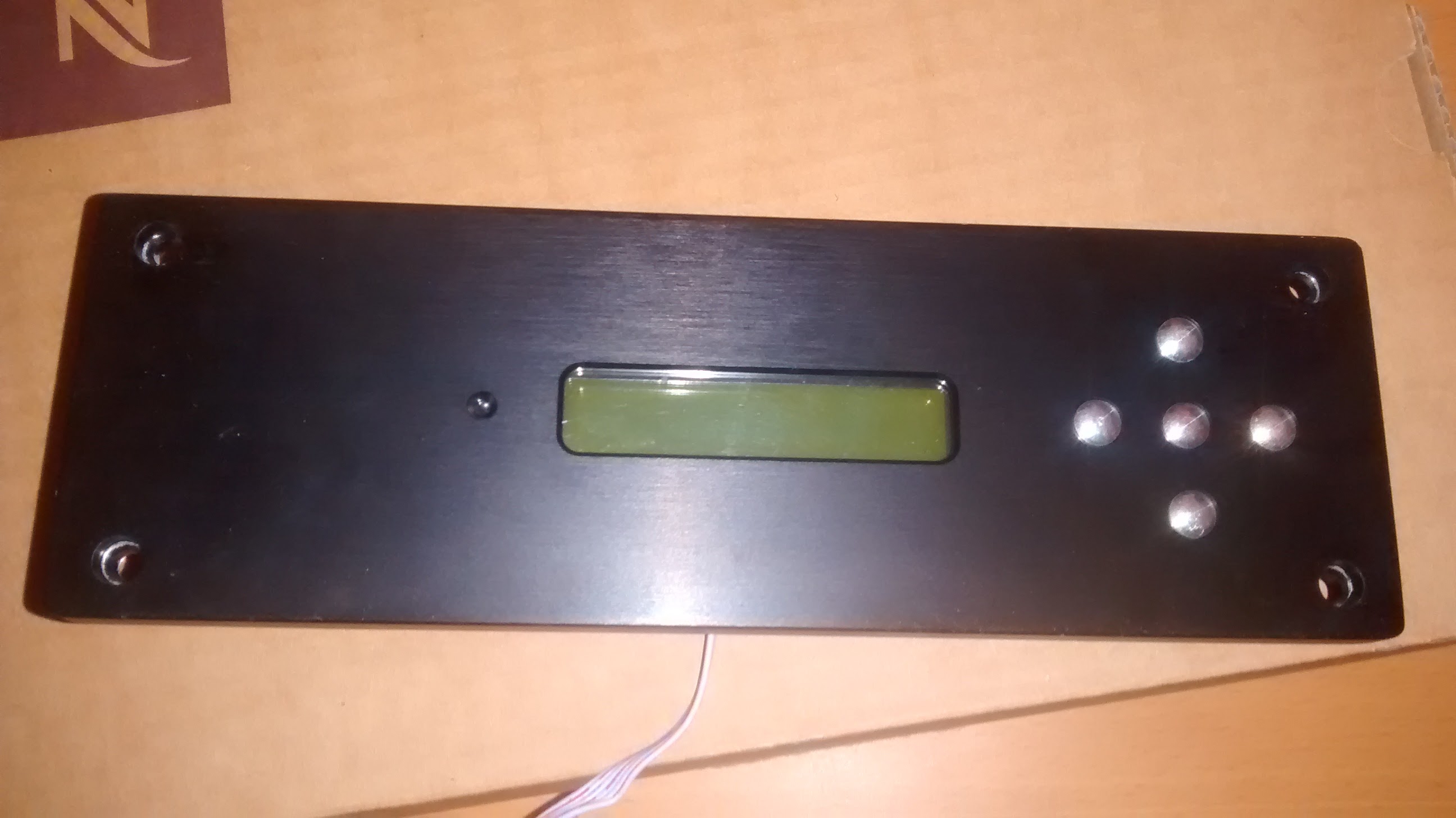

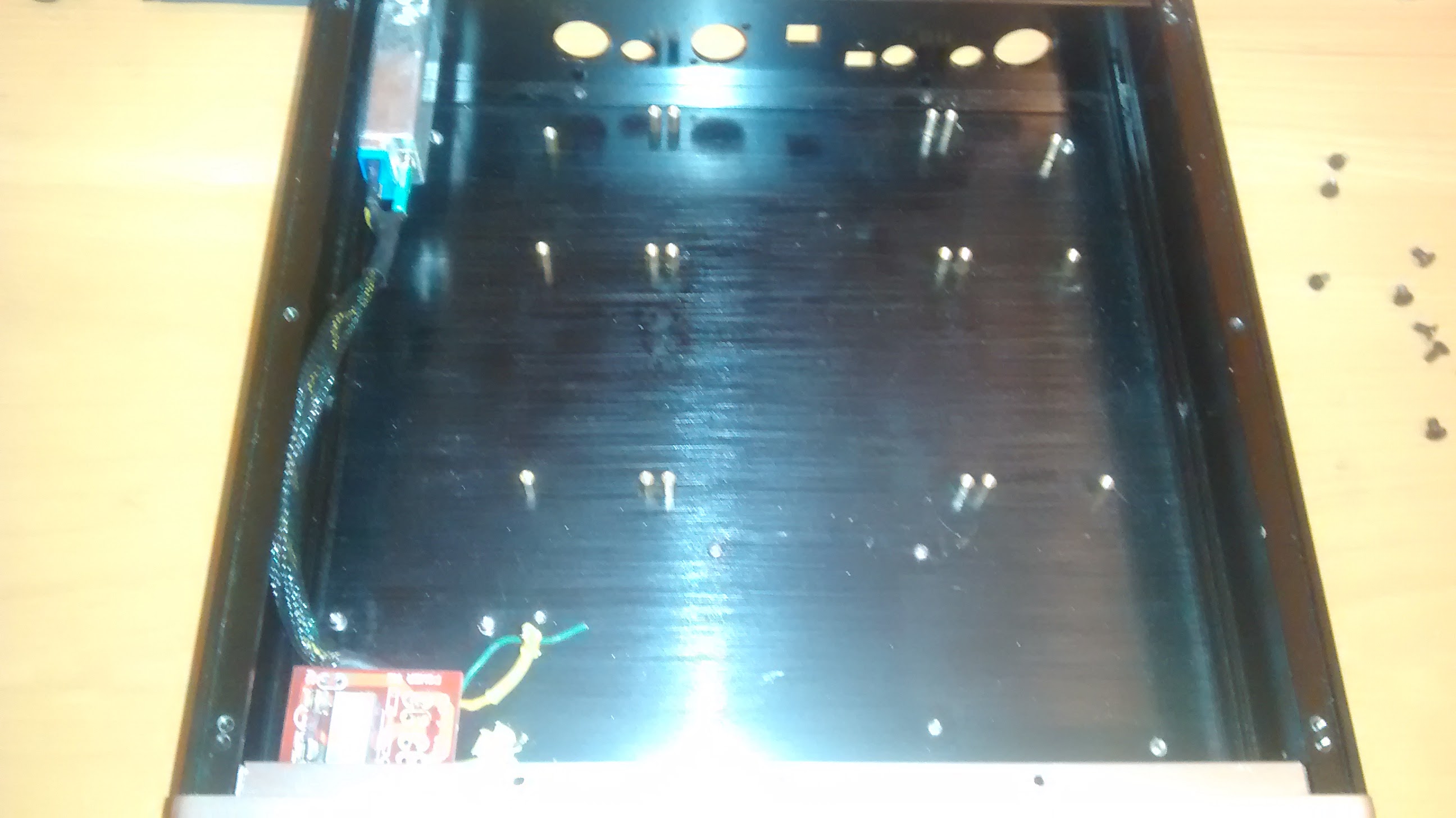

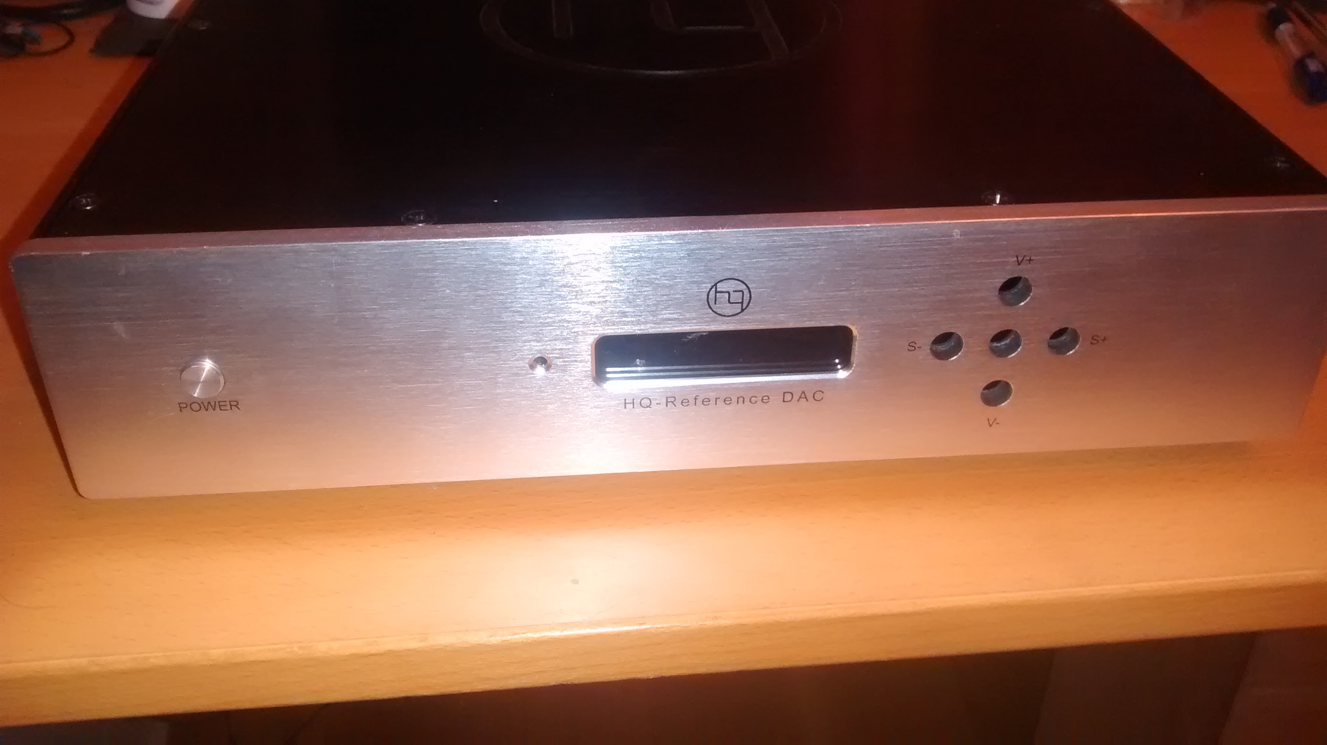

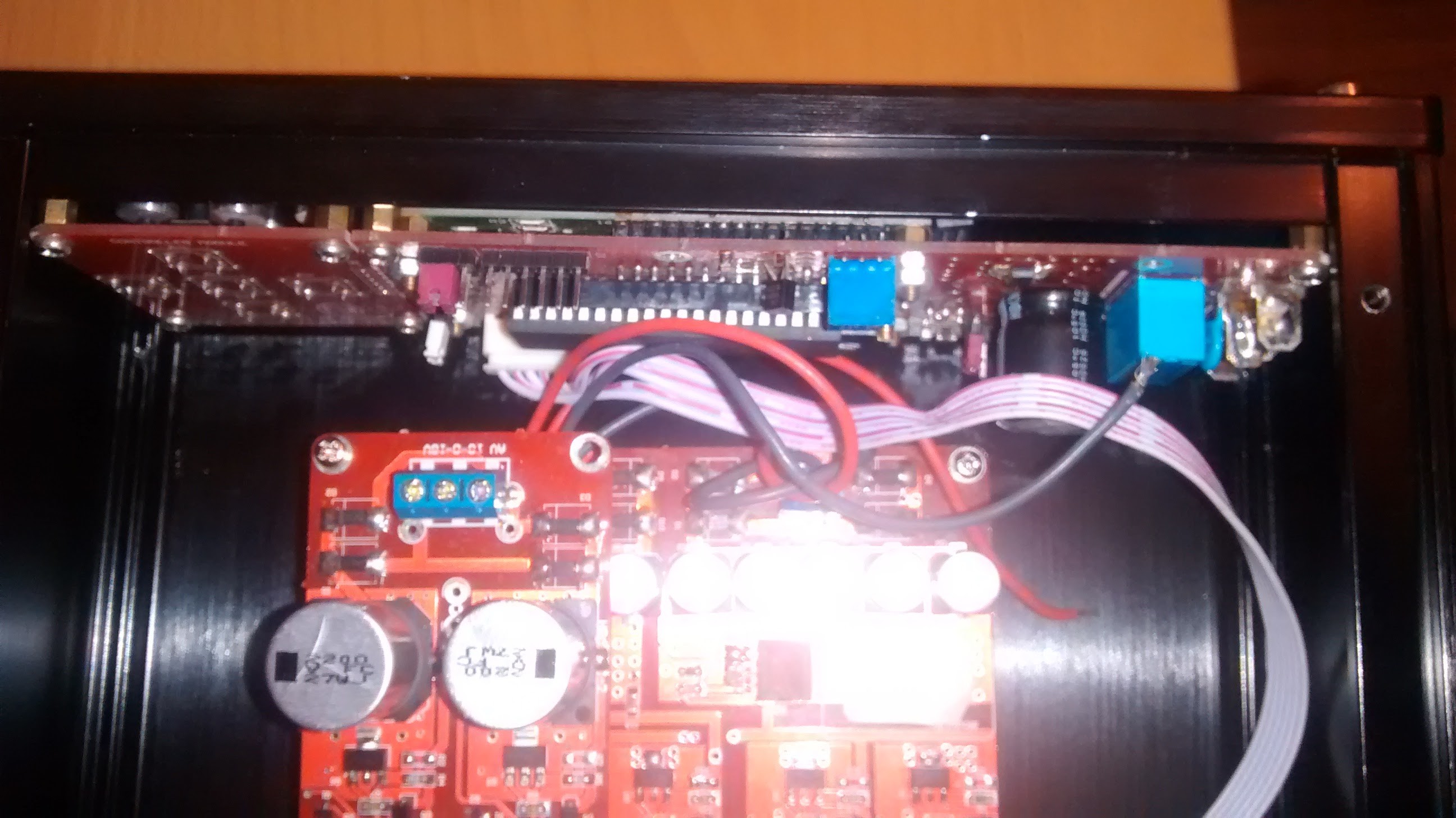

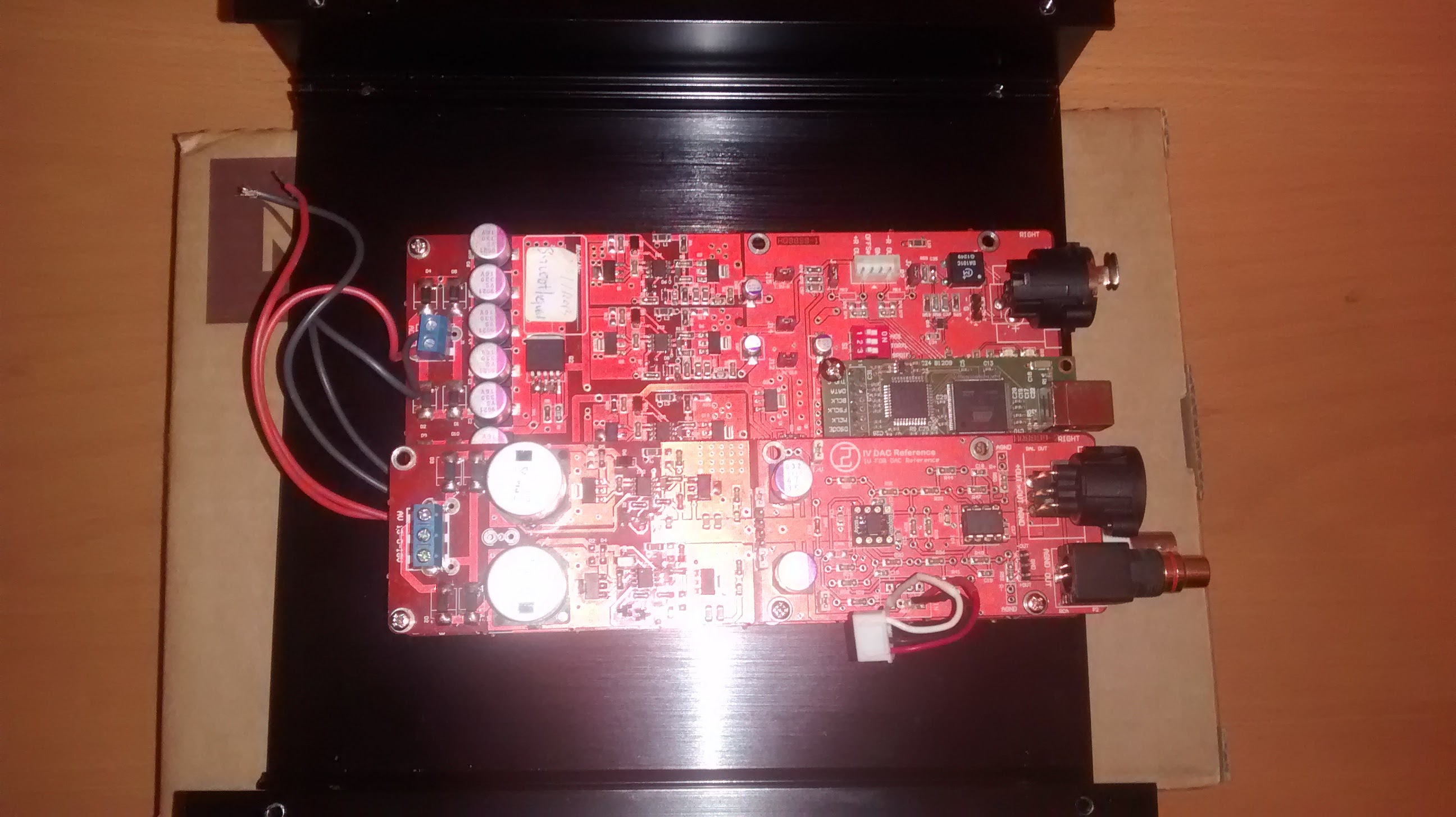

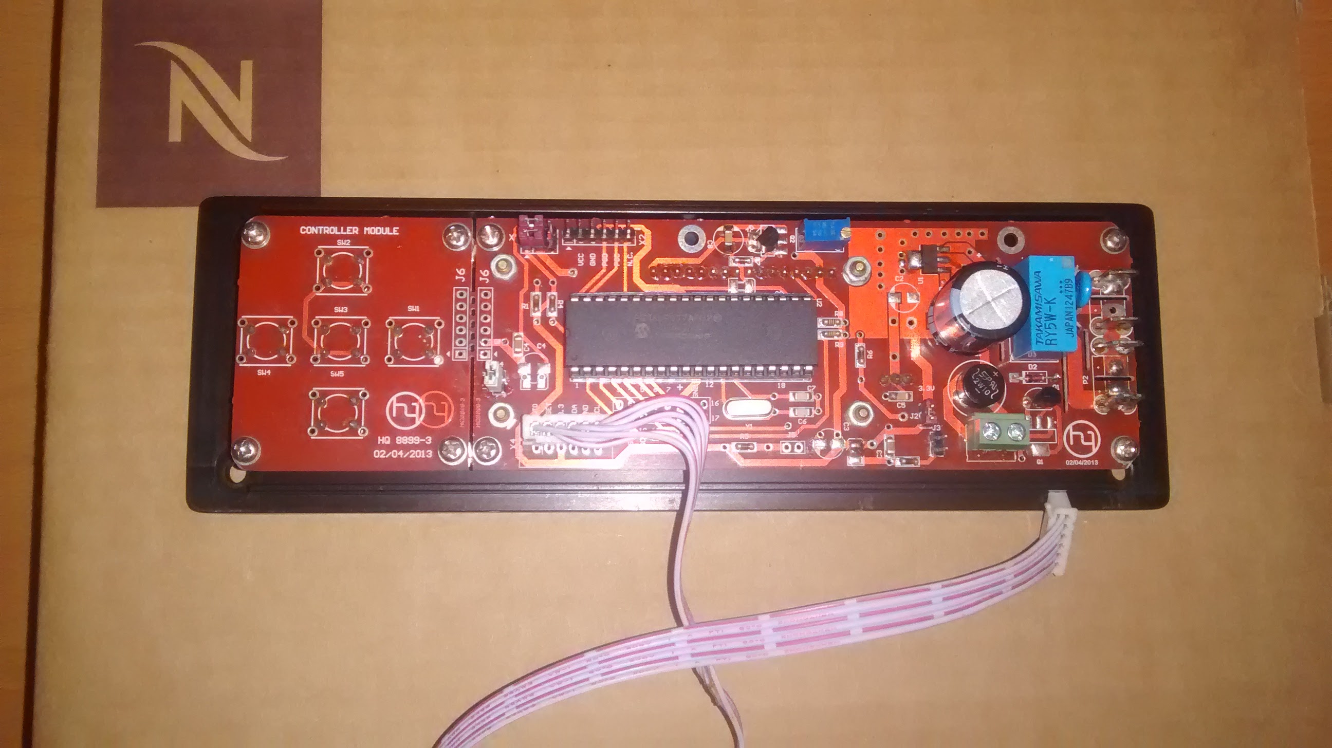

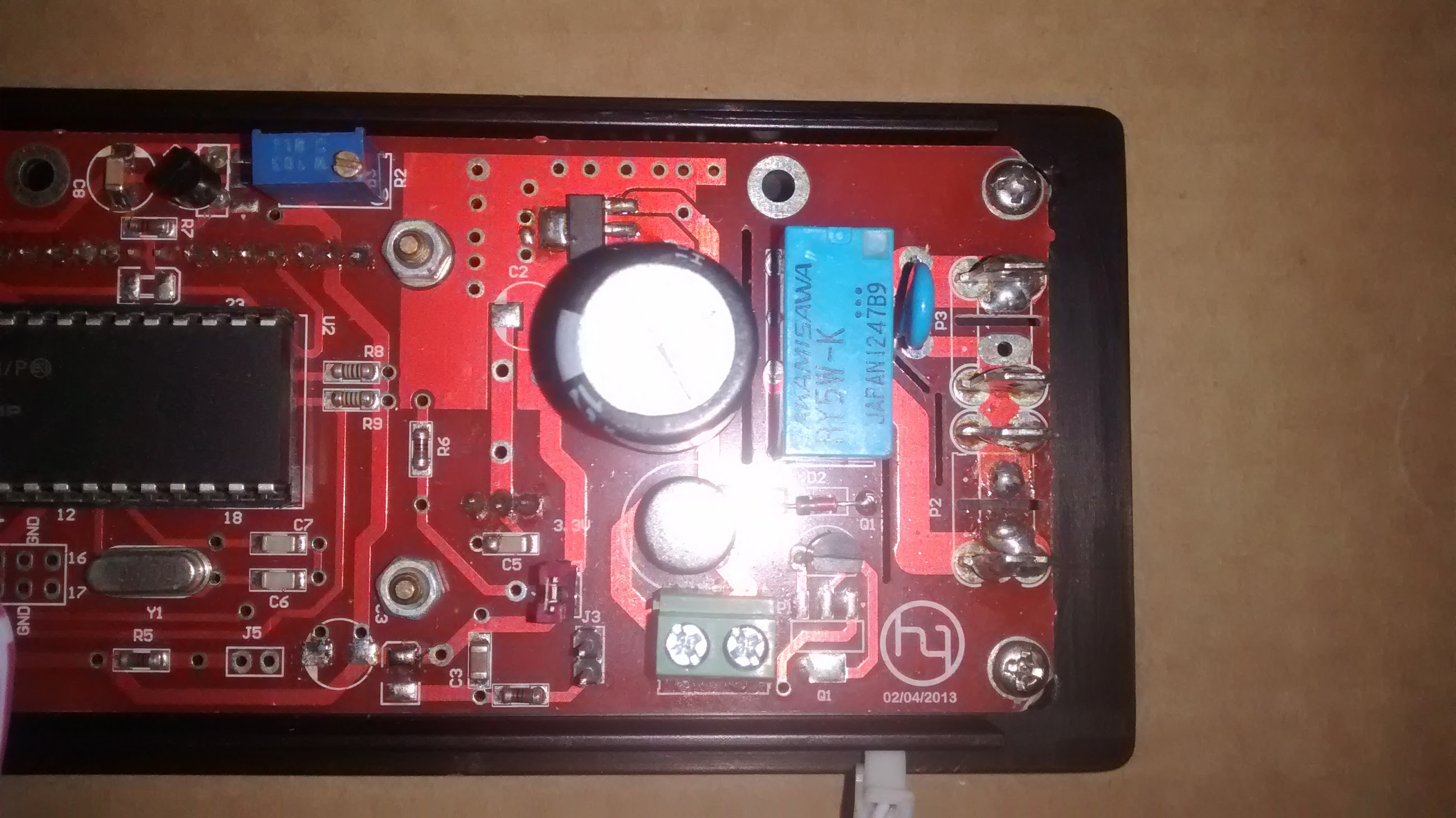

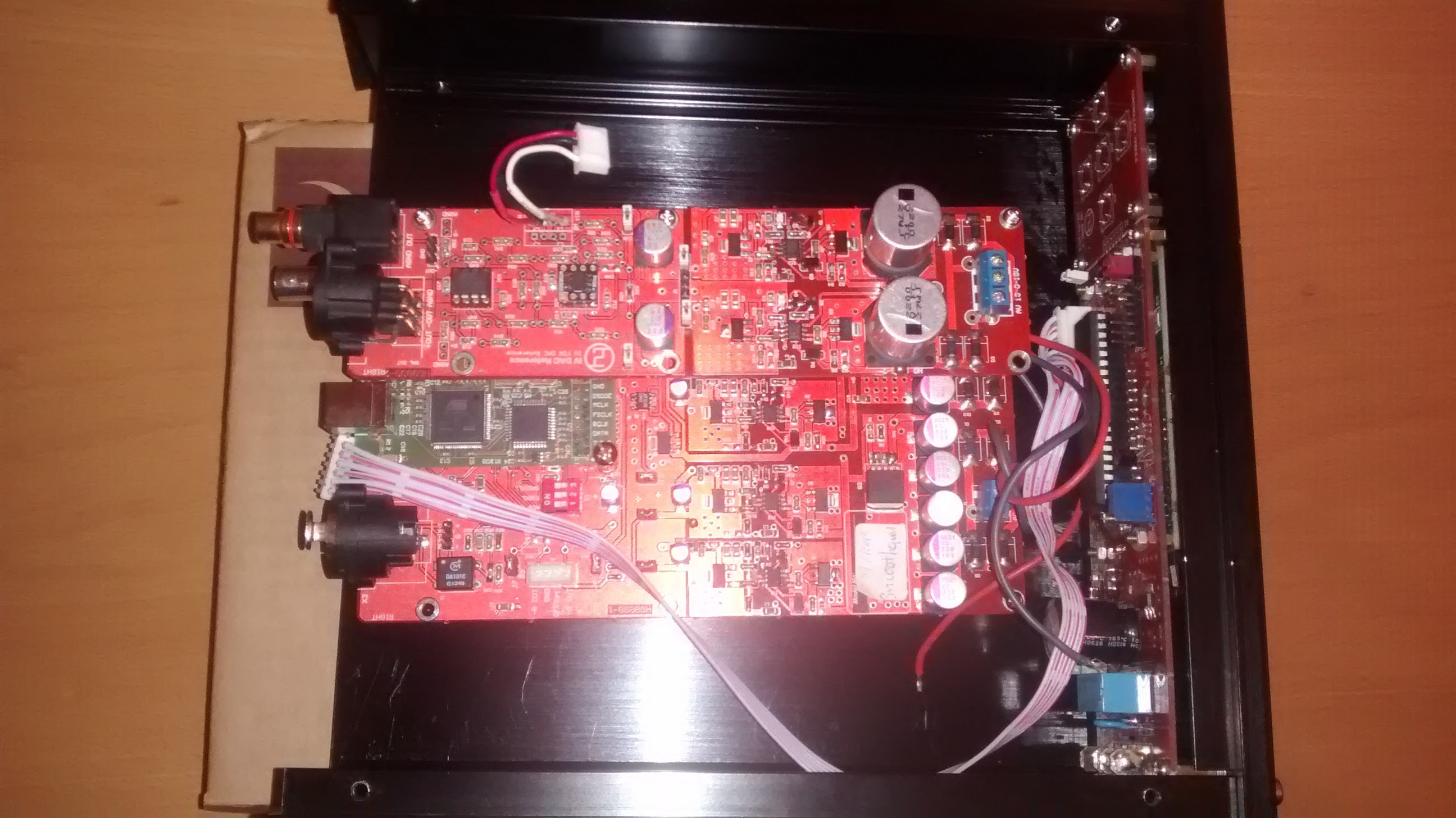

Hi. Unfortunately for me, I am having to sell my Version 1 DAC. I have absolutely enjoyed it, but decided to have it re-housed in a smaller chassis for various reasons. The plan was to have the DAC rehoused in a 210mm wide chassis with a separate chassis having the transformers and a raspberry pi. There was also supposed to have been another chassis with amp modules. Unfortunately, the person who was supposed to have built all this for me, messed it all up and never quite completed the build! The back panels on the new chassis were a complete mess and I eventually had to pull the plug.
The modules have been working fine. Rather than try and rebuild them into the original chassis, I decided have decided to sell them. I am planning to sell the original chassis as well.
Pictures are enclosed. Lot 1 would be the DAC boards including the audio boards, controller with standby function and standby relay, 2 transformers - one to power the DAC / audio boards and a second transformer for the standby function. Lot 2 would be the original Quanghao chassis in silver designed for the Version 1 controller.
I have decided to throw in the "new" chassis as well - as you can see the front has been cnc'ed to accommodate the controller. There is no power switch as the power switch is meant to be in the second chassis housing the transformers and RPi, and was meant to work with the standby function. The audio boards were supposed to be placed above the DAC, but this would mean that the AES connector on the DAC board would have to be removed. Alternatively, the audio boards can be mounted upright, but thid does not leave much room for the power connector. Obviously, if the chassis is not required, I will simply get rid of it! Incidentally, the second chassis to accommodate the power supply is also available if someone wants it! The measurements are 210mm width, 220mm depth and 70mm height. They are of reasonable quality, I think although the feet are glued on and completely rubbish! The back panels are available but probably quite useless. I think it would be best to flat pack the Lot 1 chassis.
I am open to offers. Please PM me with an offer. If agreeable, I will accept payment by PayPal or can set up a listing on eBay for payment, if preferred. I live in the UK, and estimate the courier and insurance to cost approximately £15. Should be cheaper if the chassis is not required. Happy to send more pictures if required.

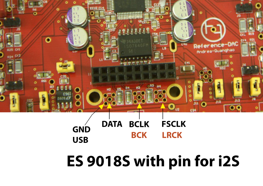

Anybody knows how input I2S signal into this DAC? I have an SD player that output I2S and I want to use this DAC instead of using USB. Can anyone please help? Quanhao, can you please help?

Use the header block which is provided to connect an Amanero board. Pin assignment is as per the Amanero spec sheet -Anybody knows how input I2S signal into this DAC?
3 I2S DATA / DSD1
4 I2S BCLK / DSD CLK
5 I2S FSCLK / DSD2
Use the pins on the opposite side of the header block for grounds - 13, 14, 15.
Alternatively, in front of the Amanero header block are 10 holes, in 2 rows of 5. These carry the same connections, but in a different order:
2 BCLK
3 DATA1
4 DATA2 (FSCLK)
If you solder a header here, you can use a standard ribbon cable/plug assembly for connection, and this pin order is more likely to match other I2S output devices, than the Amanero pin order does.

Thanks guys, Quanghao image is also helpful.
Alex
linuxfan; hi please see image! thanks quanghao[/QUOTE said:Looks like the board was designed to use some kind of female connector, can anyone recognize what type of connector it is that will go into those 5 holes?
