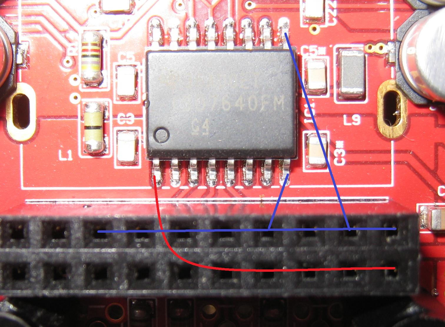

I just noticed that the Amanero is able to power the LED in my USB hub when the DAC is powered and the USB is not connector to my computer
. I was really surprised by this, so I made some some measurements. These are my findings:
Powering the DAC over USB and by the DAC at the same time is generally a bad idea. This is also stated by acko in this post.
Powering side 1 of the digital isolator and the shared gnd between side 1 & 2 totally defeats the purpose of the isolator. This way it can't offer proper isolation. One can even wonder why it's there!
This is also the case with the S/PDIF isolator at the coaxial input. The grounds here connect underneath the PCB by means of a jumper. Last summer I tried removing the jumper, but this resulted in a very unstable behavior. I really don't understand why the digital isolators are implemented this way. I'm sorry to say so Quanghao but, I my opinion this is a bad implementation of the both the S/PDIF and I2S isolator circuits.

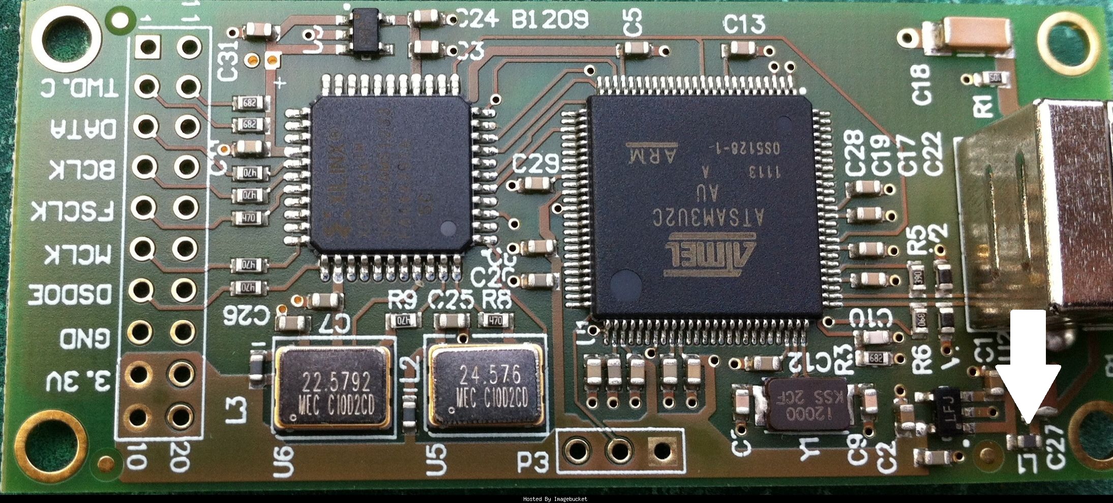

Next step is to try removing L1 from the Amanero to make sure that it only get it's power from the DAC. Hope this helps in my pursuit to get this DAC running stable at all times.
- The Amanero is powered over USB, but also by the DAC at the same time!
- Side 1 of the ISO7640 digital isolator is not isolated from side 2. Side 1 shares ground with side 2. This is also signal ground!
- Side 1 of the ISO7640 is also powered by the DAC.
I attached an image where I marked the connections. Blue is gnd and red is 3.3v from the DAC and from the Amanero.

Removing the inductor L1 also cuts the power from the USB, but the isolator is still not isolating USB ground from DAC ground. The design won't let me, because DAC ground connects to both sides of the isolator and to the Amanero's ground. Amanero ground is also USB ground.

So the USB shares ground with both digital and audio ground in the dac? I hope there is an easy fix for this. It would be grate if Quanghao could comment on this.

Hi Juergen,
The USB cable still delivers 5V to the amanero, but it's not presented to the amanero's power supply. Another way of getting the same result is cutting the 5V line in the USB-cable, but... do not cut USB-ground! Without it the DAC won't play music over USB.
The safest measure is to remove L1 from the amanero. This way it doesn't matter which USB-cable is used.
I remember that you also where experiencing some problems with the DAC, just like I did. Removing L1 from the amanero's solved the instability issues for me. At least I think that it did, but can't be sure because I replaced the controller with my own controller + firmware at the same time. The new controller + firmware gives me access to almost all settings available for the ES9018. It also makes use of a OLED, which is a major improvement over the stock LCD display. I made two videos showing the result. The first one shows the DAC being controlled with the remote and the second one with the push buttons at the front panel.
