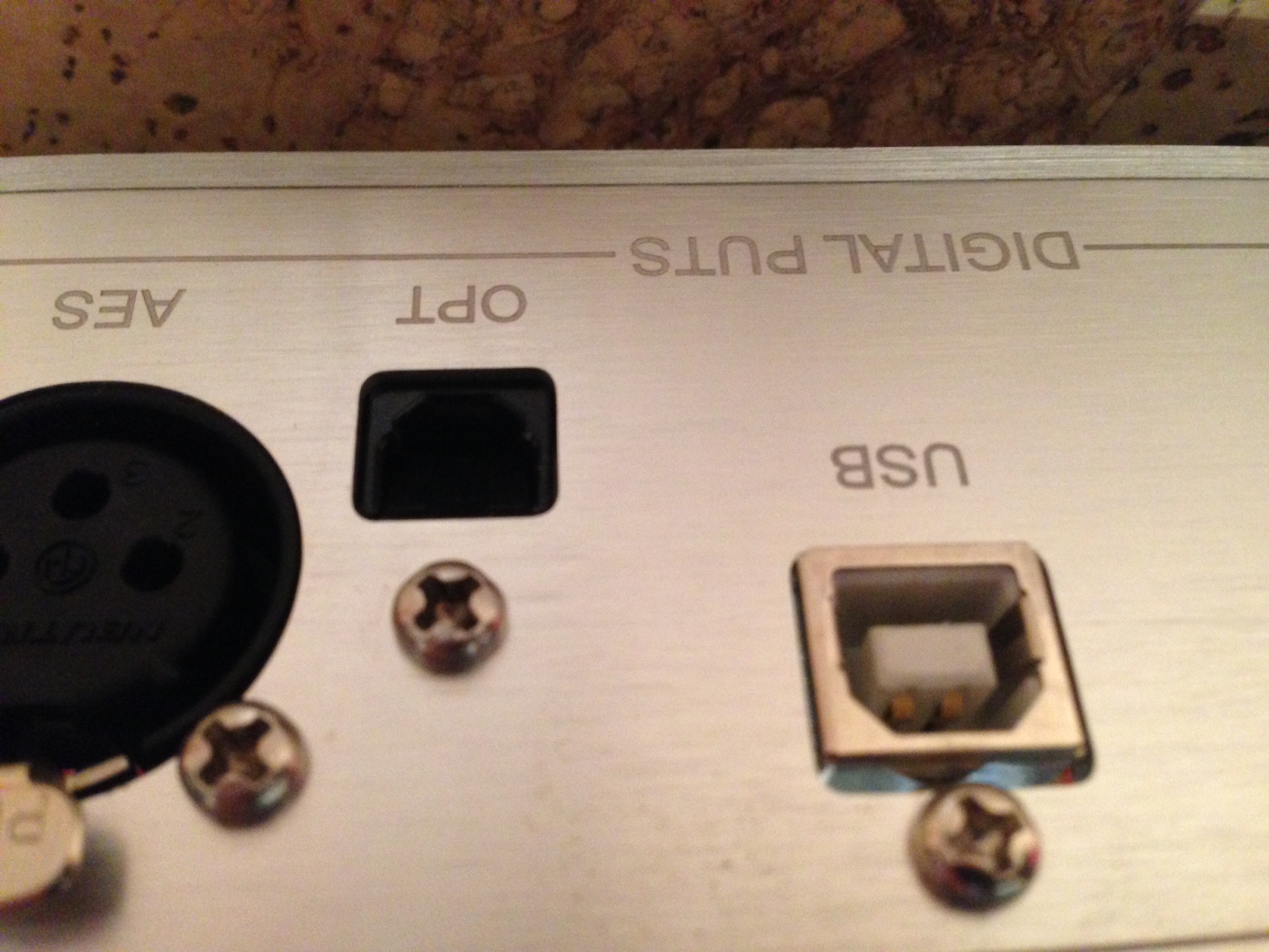

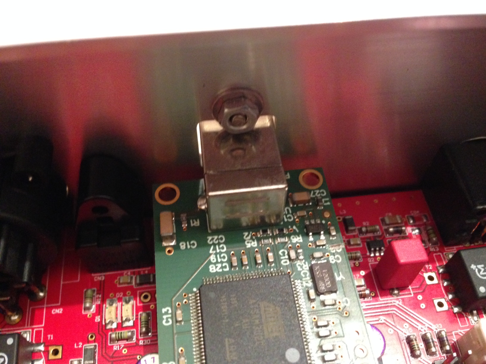

Hi serge58. No need to insulate the Amanero connector. It is already connected to the DAC through an insulator chip. Bye
